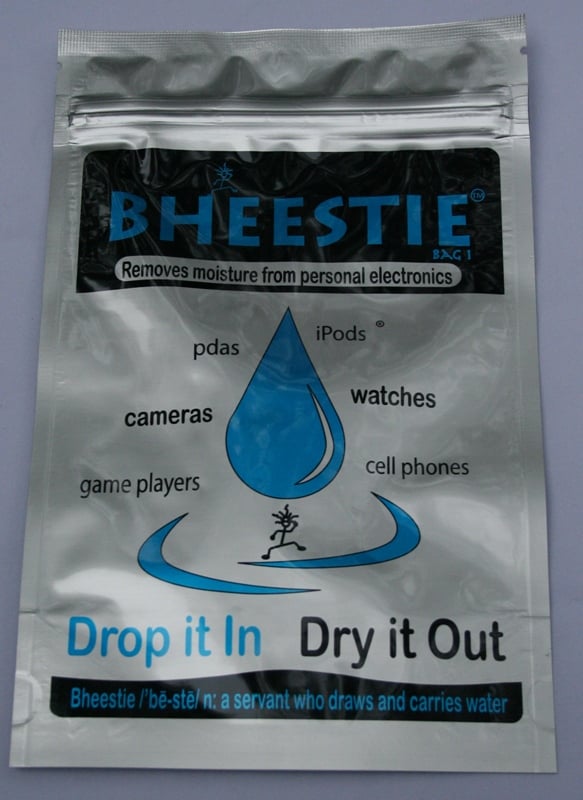

The Bheestie company decided to do something about this problem by inventing a bag. Well, it isn't the bag, per se, but the little pellets that are in it. This bag is compact enough to be taken nearly anywhere. The directions are simple - place waterlogged device in bag, seal tightly, wait. While they didn't add "pray" onto the end of that, you probably won't need to be reminded to do so (especially if it is your brand new iPhone).
Build Quality

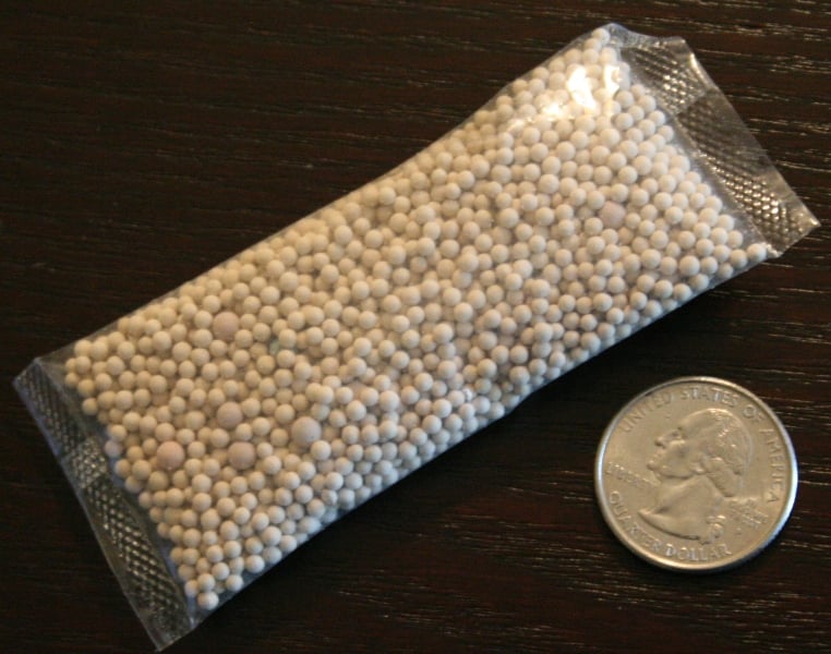

Bheestie_backWhat is
in a bag? Well, traditionally air but in the case of the Bheestie
Bag, it is air and a smaller bag of pellets. There are clear
instructions NOT to open this second bag of pellets. This makes sense
as free pellets could work themselves into the nooks and crannies of
your device, creating a different, though probably just as deadly,
problem. The bag itself looks like something people on the space
station would open to get a napkin or drink out of. The silver
material is very space age in appearance with the blue and black
highlights only adding to the effect.

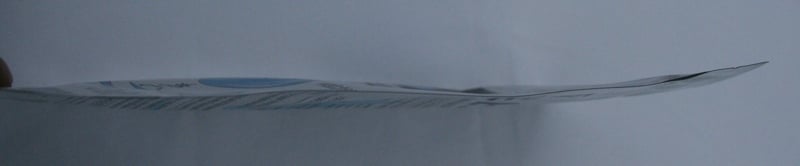

The bag arrived sealed in another bag (that makes three so far) which was then sealed in a shipping bag (up to four). I couldn't see if the mailman carried the package in a bag (five) though that seems likely. Each of the top two bag layers need to have the tops ripped off before use: The top bag to get the Bheestie Bag out, the Bheestie Bag top to get the device in. There is a zip top closure on the Bheestie Bag to keep the device in and moisture out.
This is apparently a very key feature of the Bheestie Bag - the pellets on the inside are highly absorbent and will lose that absorbency quickly if exposed to the air for prolonged periods of time. Here in Florida, this is especially true as even in the winter the humidity can be quite high. This is why I conducted the tests first before I removed the interior bag of pellets for my picture. Each bag of pellets has a number of "indicator" pellets. These let you know when your Bheestie Bag needs to be replaced. While the pellets are still good and able to absorb moisture, they are blue. Once they turn gray, it is time to get a new Bheestie Bag. This is actually a feature I was hoping to see with the Bheestie Bag as it takes the guesswork out of replacement times.
With the supposed high absorbency of the pellets such an issue, I was surprised at how hard it was to close the zip top. Some of the newer bags these days have actual sliders which would have made things a bit easier, though I suppose those may not offer as airtight a seal. On the other side of the spectrum, there are also double zip tops out there for extra protection. Again, this seems like it would be a good step and one that shouldn't take a huge chunk out of the profits.

It's small. Well, the bag isn't small but the contents are tiny. The little bag of pellets inside or so small that you'd think they couldn't possibly absorb that much water. That remains to be seen at this point in the review but from a transportability standpoint, the small amount of contents of the bag means it can be easily placed in a laptop case, a gym bag, or just about anywhere else. Try lugging around a bag of rice "just in case." The compact size of the Bheestie Bag must be considered a huge plus.

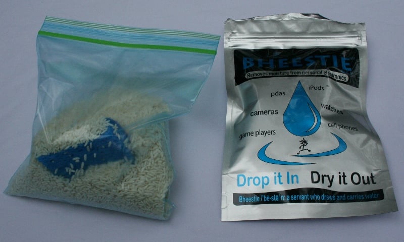

At this point is where I run into a wall. Sure, it's small and transportable but for $20, it should work like a charm too. Well, that's where the test comes in. With help from Audioholics Editor-in-Chief Clint DeBoer, a unique test was devised to uncover just how good this Bheestie Bag was. We wanted to know not only if it worked, but how well and compared to the most obvious competition - a bag of rice.

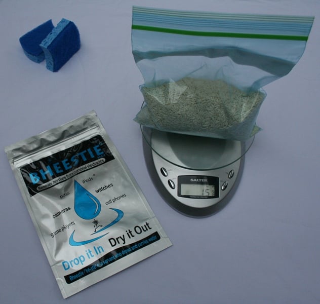

So, at this point you've got your device off, apart, and as dry as possible. You've got a choice, a Bheestie Bag or a bag of rice. Here is the tale of the tape:
Bheestie Bag |
Bag o' Rice |
$20 |
$1 (probably less but whatever) |
1 ounce |
1 pound |
Cool high tech design |
Rockin' old school Ziplock |
Absorptive pellets kept separate from device |
Rice gets everywhere |
Easily transportable, thin, compact |
Bulky bag that if it breaks will make a huge mess |
Bheestie Bag Experiment Results and Conclusion

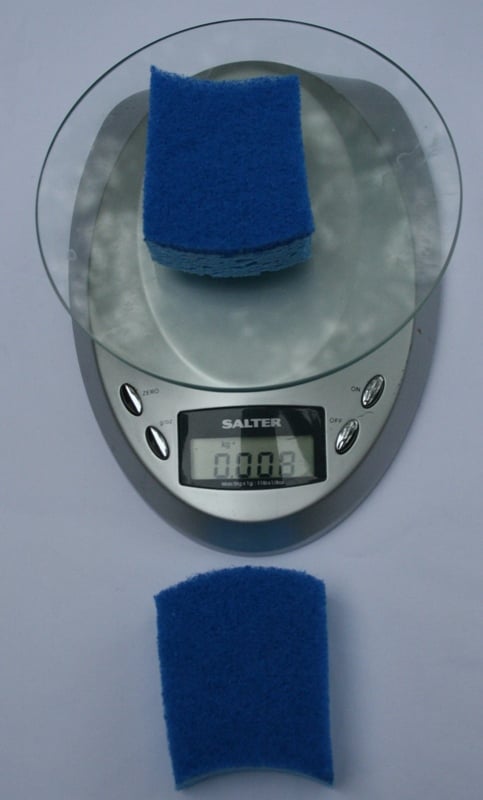

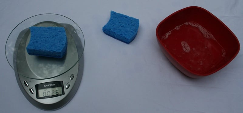

The experiment was designed to show not only which solution absorbed the most water but did it the fastest. I took a normal kitchen sponge and cut it in half. Each of the halves weighed 8 grams. These halves I submerged in normal tap water until they weighed a total of 25 grams. That's 8 grams of sponge and 17 grams of H2O for the mathematically impaired. These sponges were immediately placed in the two bags which were sealed up tight and left in my office (away from the prying fingers of little children). Care was taken not to squeeze the bags and the sponges though I did rotate them from time to time (i.e. move them out of my way) which should have shifted the contents slightly. I then weighed the sponges periodically.
