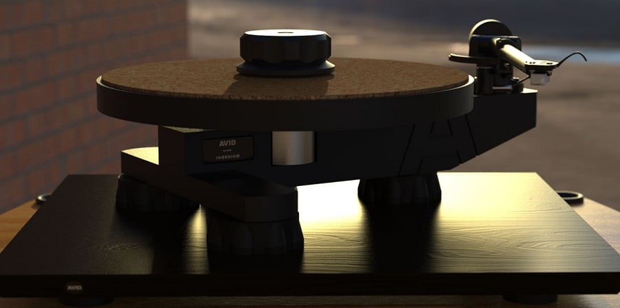

During the Audio Advice Live event, the Ingenium stood out with its modern design and small footprint. Its minimalistic yet sophisticated appearance caught the eye, making it an appealing choice for those who prioritize aesthetics in their audio equipment. The factory-installed MM cartridge, record clamp, and premium build materials promised a solid performance. However, what truly piqued my interest was its ingenious platter design and isolation properties, noticeable even during a quick on-site test.
AVID Ingenium top

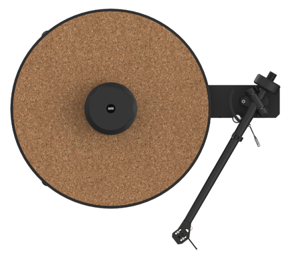

The Ingenium features a cork-and-rubber platter mat adhered to its aluminum platter. This design effectively absorbs vibrations and isolates the record from any resonance traveling through the plinth. Coupled with its detached motor—placed discreetly behind the turntable and beneath the platter—this thoughtful engineering makes the Ingenium a standout performer in its price range.

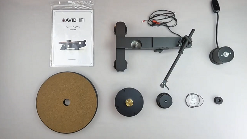

AVID Ingenium Turntable Assembly and Setup
AVID Ingenium parts

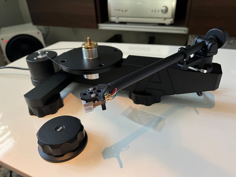

Setting up the Ingenium took about 30 minutes, thanks to its detailed instructions. The process involved installing the tungsten carbide ball bearing and inserting the hub assembly, which contains a sapphire-bearing surface. It is crucial to take great care during this step, especially when installing the upgraded solid aluminum platter. The sapphire thrust pad is delicate and susceptible to damage if undue force is applied or if the platter is not seated properly. Ensuring smooth, precise handling will preserve the longevity and optimal performance of the bearing system. The platter, with its precise alignment knobs, fit securely onto the hub. The belt drive motor placement at the rear was a unique choice, offering a clean, compact look but making speed adjustments less convenient.
AVID Ingenium top
Adjustability: One notable drawback was the lack of adjustable isolation feet. While the composite feet, made from a foam and Sorbothane blend, provide excellent vibration isolation, the inability to level the turntable via adjustable feet might pose challenges on uneven surfaces. This feature is often expected at this price point and could improve the overall user experience.

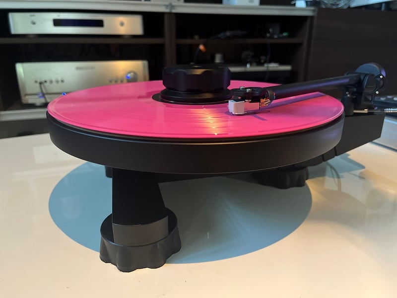

Isolation is one of the Ingenium’s standout features. The combination of its composite feet (foam and Sorbothane blend), a separate motor, a cork-and-rubber platter mat, and the innovative double-bearing design minimizes external vibrations and resonance. Even during a rigorous test with an SVS 3000 subwoofer placed nearby at less than two feet, the Ingenium maintained impeccable performance without audible rumble or distortion.  Footsteps are completely ignored around the turntable. Even bumping or hitting the record clamp to hear any transference of unwanted noise.  It is completely dead in all scenarios. I even venture to say it’s the best isolation and decupling I have experienced and it's quite surprising at the price level.  This was one of the main focus targets on design and they have overwhelmingly succeeded.  (Congrats!!!)

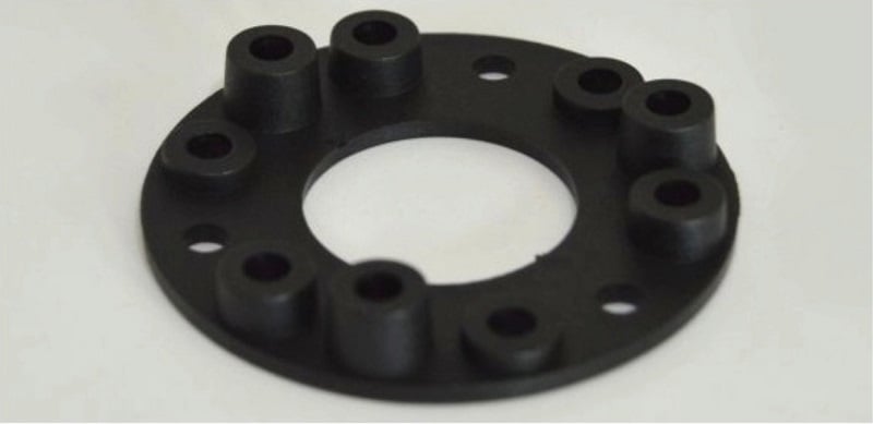

One of the Ingenium’s standout features is its potential for upgrades, allowing users to unlock even higher levels of performance. Two notable enhancements can transform this turntable into a true high-end contender:
1. Solid Aluminum Platter: Upgrading to AVID’s solid aluminum platter significantly enhances the Ingenium’s performance. This platter, weighing more than the stock model, improves rotational stability and reduces unwanted vibrations. It also provides a more inert surface, ensuring the stylus extracts even finer details from your records. During my testing, the upgraded platter resulted in tighter bass, increased clarity in the midrange, and an expanded soundstage, particularly noticeable on orchestral recordings.

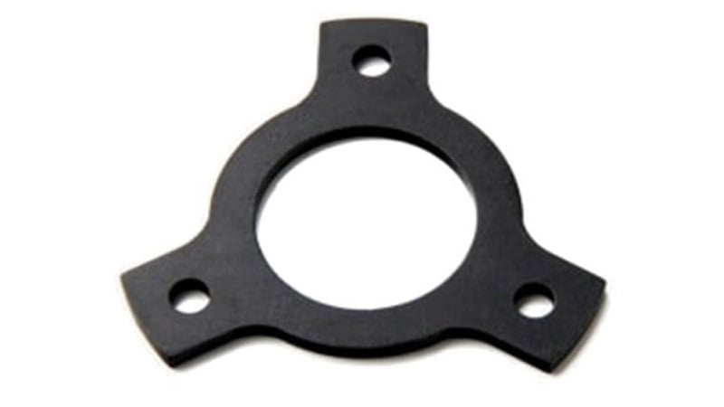

2. Tonearm Upgrade for VTA Adjustability: AVID offers shims for the Ingenium’s tonearm that allow for Vertical Tracking Angle (VTA) adjustments. This upgrade is invaluable for audiophiles seeking to fine-tune their setup for different cartridges or record thicknesses.
height spacer   spacer 2
With the VTA shims installed, I noticed improvements in tonal balance and tracking accuracy. High-frequency details were more refined, and the overall presentation felt more dynamic and cohesive. This simple yet effective upgrade adds a layer of versatility to the Ingenium, making it more compatible with a wider range of cartridges and audiophile setups.
