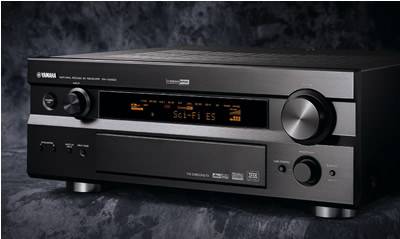

We have received our review sample of the Yamaha RX-V2400 (MSRP:$1000) A/V receiver. We are also fortunate to have a direct contact with Yamaha Engineering in Japan to get any of our questions/concerns answered from the designers themselves. With that a few questions popped in my head while I was unboxing the RX-V2400 and perusing the user manual.
