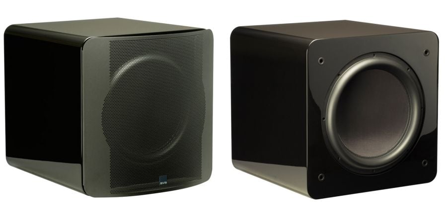

The SB13-Ultra sits at the top of SVS’s sealed subwoofer line up with a price tag of $1599. It combines a powerful Class D, DSP-equipped amplifier that is controlled via what SVS terms as the IFC or integrated function controller. Changes to settings are made by a single knob that also functions as a push button. It is a slick little setup. A single push of the button enters the selection while a quick double press exits. The amplifier powers a beefy 13.5” diameter long throw driver in a relatively small sealed enclosure measuring about 17.4” on all sides. The enclosure features a large round over on the top and bottom edges of the side panels. A heavy, formed, steel grille with a rounded profile attaches to the enclosure via a pin and cup system, covering the forward firing driver and adds a couple of inches to the overall depth of the SB13-Ultra. Four small feet on the bottom panel protect the finish from the floor. Speaking of the finish, the two available finishes are a piano gloss black which was worn by the review unit and a black oak wood veneer. Despite the SB13-Ultra measuring less than 18” a side it weighs in at 92lbs which gives some clue as to how much hardware this little guy is packing.

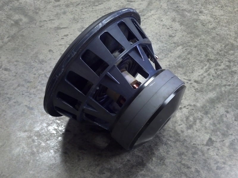

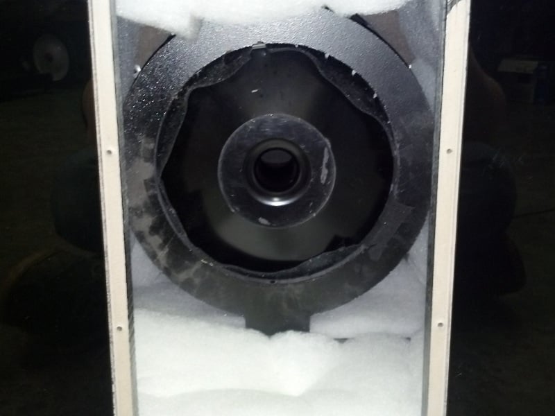

Removal of the Ultra driver from the SB13-Ultra enclosure was not too difficult. The best way is to remove the amplifier first so that the back of the motor can be accessed first. After removing the amplifier, which allows access to the back of the driver, remove the screws holding in the driver and then the driver motor can be pushed on from below, forcing the lip of the driver’s frame up enough to get a hold of it. Once removed from the enclosure the driver can be seen for the beast that it is. Weighing in around 42.5 lb. and comprising the lion’s share of the 92 lb. weight of the SB13-Ultra, it looks similar to the driver used in the PB13-Ultra, but it's shorter overall and the voice coil is partially visible. The voice coil is unique to this application, in order to optimize it for use in a small sealed box (more layers of wire for higher BL most likely). The motor in the SB13-Ultra driver is overhung, while the motor in the PB13-Ultra driver is underhung (and slightly heavier at 50.5 lb). Features that the two drivers do share in common include a sturdy cast aluminum frame, long throw parabolic surround, composite Rohacell/pulp cone, copper shorting sleeve to lower distortion, large diameter 9” spiders to support extended excursion, large diameter dual stacked magnets, vented pole piece and 3” diameter flat wound aluminum voice coil. The result is a massive heavy duty driver with high power handling and very long throw capability.
SB13-Ultra Driver

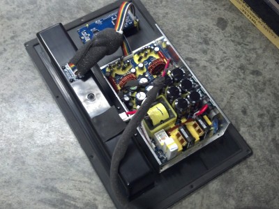

The STA-1000D Sledge amplifier is a highly efficient Class D switching amplifier rated at 1000 watts long term power. It occupies the majority of the back panel of the enclosure. In use the amplifier certainly seemed to have plenty of power to boss around the Ultra driver. Even during heavy use with test signals in an outdoor environment in direct sunlight it did not overheat or protect at any point. Checking the plate with the scientific method of laying my hand on it after listening to loud music for a long duration revealed that it was barely warm.
The amplifier has both unbalanced RCA style and balanced XLR style connections and stereo inputs and output of both types. Nearly all of the controls for the amplifier are managed digitally by a small blue screen and a single button/knob. It is a very intuitive and easy to control interface. The DSP section of the amplifier is deeper than most and has controls for: Gain, phase, room gain compensation, low pass filter, high pass filter for the signal sent to the speakers reproducing the upper frequencies, delay adjustment for the signal sent out to the other speakers and two independent parametric equalization bands with adjustments for center frequency, cut, boost and Q. The best use of these controls is likely in pure two-channel systems where the amount of adjustments on board the STA-1000D amplifier should be enough to get the job of blending the subwoofer with the main speakers done without any other speaker management needed. These adjustments could be made by ear but the best results would likely come through the use of measurements in conjunction with the adjustments. Certainly this is a flexible and powerful amplifier.
SVS SB13-Ultra (Sledge STA-1000-D) Amplifier

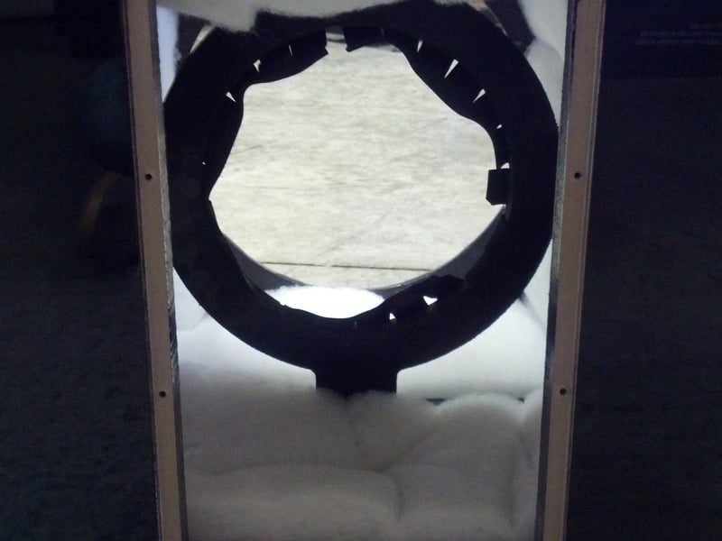

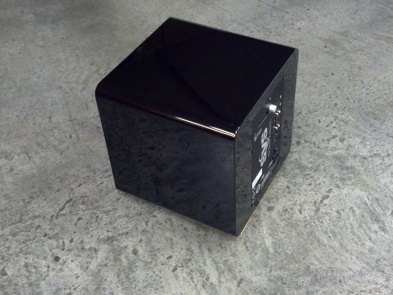

The cabinet of the SB13-Ultra subwoofer is constructed of MDF (medium density fiberboard) and contains a large window brace internally which the motor of the driver fits into. This brace stiffens the top bottom and sides of the cabinet and also helps support the heavy driver motor and relieves stress on the front baffle and driver mounting area. The cabinet is lined with damping material and has large radiuses on the top and bottom edges. The SB13-Ultra cabinet is strong and well damped and it exhibited no appreciable vibration, rattles or resonances during the outdoor measurement sessions. The gloss black finish provided on the review unit was beautiful and polished to a mirror finish. As with most gloss black finishes it is attractive but easily picks up streaks, fingerprints and dust. With the mirror finish, rounded edges and compact dimensions the review unit should be acceptable in most anyone’s décor. The heavy duty formed steel grille is certainly a unique piece and high quality to boot but I admit I’m personally not a big fan of it. The build quality, fit and finish and ergonomics of the SB13-Ultra are all top notch.
SVS SB13-Ultra Cabinet View

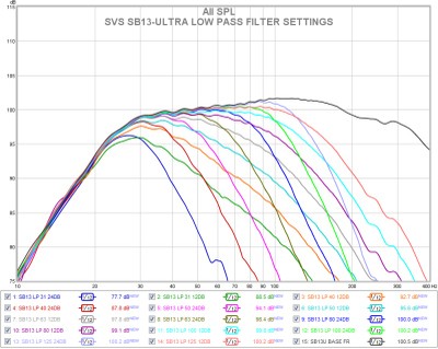

SVS SB13-Ultra: Effect of Low Pass Filter Settings on Frequency Response

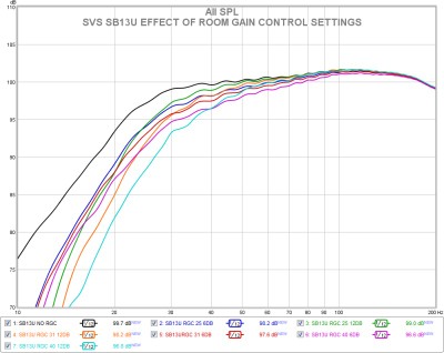

SVS SB13-Ultra: Effect of Room Gain Compensation Settings on Frequency Response
Above are the frequency response measurements of the SB13-Ultra subwoofer showing how adjustment of the internal low pass filter frequency and slope affects the top end response shape and also how the RGC or room gain compensation setting affects the low frequency extension. The low pass filter setting is selectable as either 12dB/octave or 24dB/octave and is variable at 7 frequencies from 31 to 125Hz. The indicated slope and frequency of the slope were in very close agreement with what was measured. The RGC setting primarily cut back the low bass frequencies a bit with the 6dB slope being a bit less aggressive and the 12dB setting being more so. This would primarily be used in a smaller room, with near field placement or with corner loading of the SB13-Ultra. The parametric equalizer function was not measured because it has been previously with the larger vented PB13-Ultra review and should perform identically. The 2 bands available give a wide array of options for combating room resonances at the listening position or for affecting broad adjustments to the response shape. Needless to say when the PEQ bands are combined with the low pass filter function and the RGC controls there is a huge amount of adjustment that can be made to the SB13-Ultra’s response. I could see the flexibility afforded by the internal DSP and the extensive input and output options being handy in dedicated 2-channel systems where a receiver with automatic room correction and bass management is not being used. I have a 2-channel garage system for casual listening while working on things and I have to use a separate active crossover unit to blend my B2031A’s to whatever bass system I’m using with them at the time. I could likely eliminate the active crossover unit if I were using the SB13-Ultra.

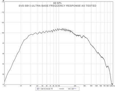

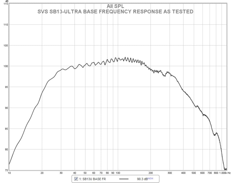

SVS SB13-Ultra: Frequency Response as Tested
Above is the frequency response of the SB13-Ultra as tested with the all of the internal DSP functions that would affect the frequency response shape disabled. Judging by the shape of the response and some of the other measurements taken, there is likely a bit of bass boost centered at around 20-25Hz to extend the deep bass response. This is very common for small sealed units. Overall the response shape fits within a 6dB total window from 22-360Hz. SVS specs the response as 20-460Hz within a 6dB window. The top end is nice and extended on the SB13-Ultra so it could easily be used up as high as 150-200Hz if needed to blend with small bass-limited speakers.

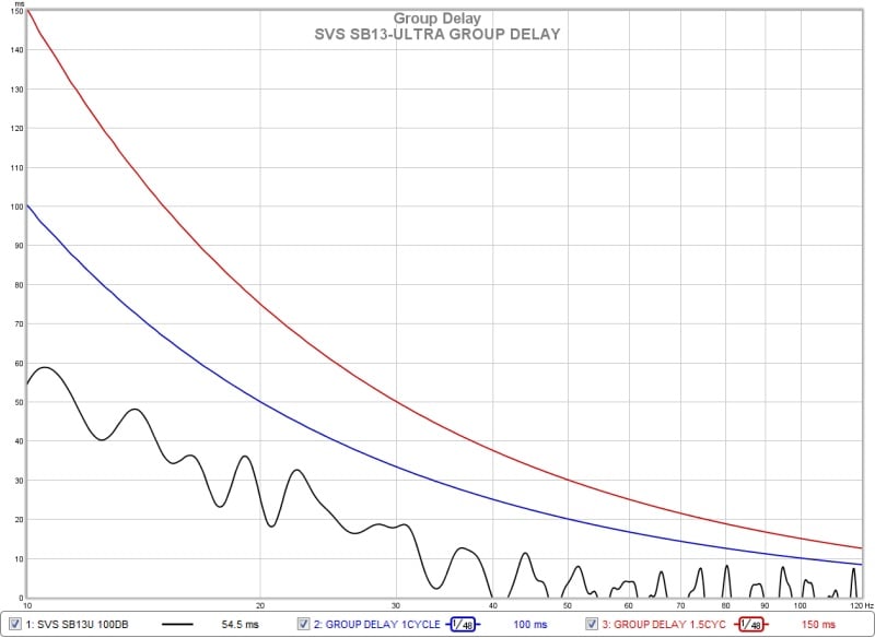

SVS SB13-Ultra: Group Delay
As expected of a sealed subwoofer system the group delay and other time domain measurements for the SB13-Ultra are well mannered and show nothing of consequence. The delay never approaches 1 cycle at any point over its entire useful bandwidth.

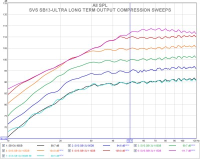

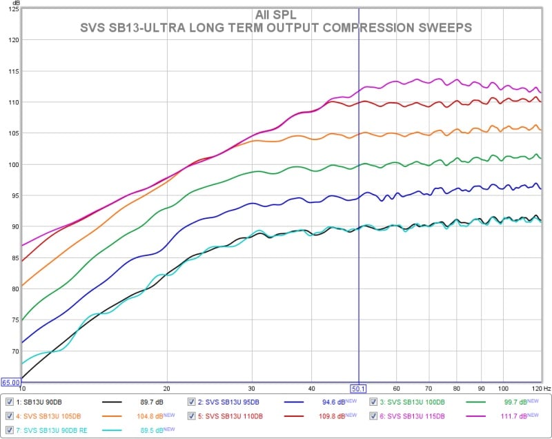

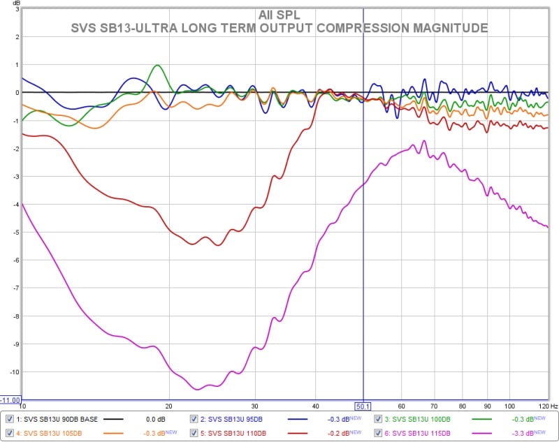

SVS SB13-Ultra: Long-Term Power Compression
The long-term output compression tests for the SB13-Ultra show that it maintains excellent linearity with good tracking of the output demands and little changing of the response shape up through the 105dB sweep. The 5dB louder 110dB sweep indicates that the SB13-Ultra was already at its output limitations near 25Hz in the 105dB sweep and this is further reinforced with an even louder 115dB sweep which shows near zero increase in output in the deep bass. The SB13-Ultra managed to produce around 98dB at 20Hz, 105dB at 30Hz and greater than 110dB from 45Hz on up during the loudest 115dB sweep. Of note is that despite being driven some 5 to 10dB into compression in the deep bass and the driver cone moving a massive amount, the SB13-Ultra was stoic during this and emitted nothing more than a bit of suspension noise from the driver below 20Hz. No cabinet vibration or panel resonances were noted either. SVS has always shown an aptitude for preventing gross overload artifacts from their subwoofers and once again did the job well. Also interesting is that the repeat 90dB measurement, which was taken after the rest of the measurements in order to display any long term heating effects on the driver, indicates that there is very little shifting of parameters or heat built up in the voice coil. This is impressive considering that gusting winds on the day of ground-plane testing necessitated re-running some of the sweeps multiple times to get a clean measurement. This meant that the SB13-Ultra driver took a few more 23 second long sine wave sweeps than usual during this test.
Note on Output Compression Testing: This is by far the most demanding measurement type conducted on the subwoofers during our testing and will reveal any issues with overload, port compression, port noise, driver distress, creaks, rattles, buzzes, etc. Additionally, the test is conducted outdoors with just the subwoofer operating so there will be no nearby walls or objects to vibrate and no upper frequency content from other speakers in operation. These would normally help to cover up or mask any objectionable noises from the subwoofer in a typical room. Any sort of audible distress or issues with the subwoofer are readily apparent in this environment.

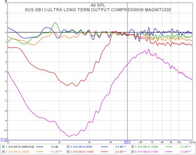

SVS SB13-Ultra: Output Compression Magnitude
Looking at the chart above, which shows only the amount of compression occurring in the output of the SB13-Ultra as the output level is increased, indicates that the SB13-Ultra is linear and responds to increased output demands with negligible compression of 1dB or less up through the 105dB referenced to 50Hz level. Increasing the output another 5dB to the 110dB nominal level again shows little compression above 35Hz where it is 1.5dB or less but the output in the deep bass has started to be limited and reaches 5dB from 20-25Hz. This indicates that there is likely to be some boost equalization used to shape the SB13-Ultra’s deep bass response which is centered in that bandwidth. Increasing the output demands another full 5dB to what would be an 115dB@50Hz nominal level pushes the SB13-Ultra into heavy limiting over the entire bandwidth.

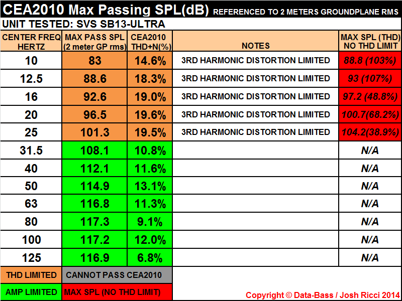

SVS SB13-Ultra: CEA2010 2 Meter Ground-plane RMS Results
CEA2010 Results
The CEA2010 maximum-distortion-limited-short-term output results for the SVS SB13-Ultra indicate it has a lot of muscle for a unit of this size and alignment. It is neck and neck with the excellent JL E112 for the most part which I also recently reviewed. At the 40Hz band and above the SB13-Ultra is capable of greater than 112dB of output and tops out at a loud 117dB over the 63-125Hz octave. At the 31.5Hz band and above the output is limited by the available amplifier power. As with any sealed subwoofer the low end output diminishes gradually into the deeper octaves as the driver is asked for more and more displacement. By 20Hz the maximum recorded output with passing distortion is 96.5dB which drops to 92.6dB at 16Hz. The SB13-Ultra was able to produce enough output with low enough distortion to get down into the lowest couple of bands as well and while not with pant flapping output, in room the boundary reinforcement will typically provide a noticeable lift to the lowest bass frequencies below 30Hz, while also boosting the fundamental of the waveform compared to the harmonics, which lowers distortion. This was the case in my room. At the 25Hz band and below the SB13-Ultra output was limited by distortion, the 3rd harmonic to be exact. If distortion is ignored completely the SB13-Ultra could produce output levels about 4dB higher in the deep bass but with greatly elevated distortion levels.
