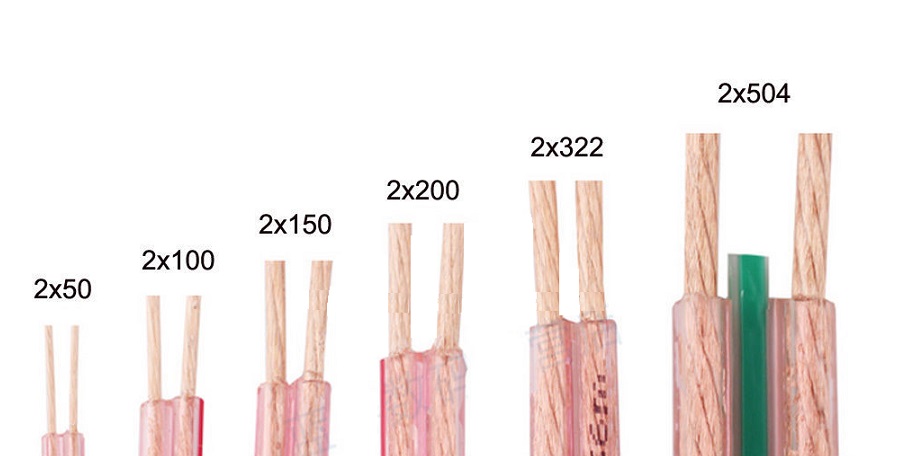

I'll address your specific question, but first let's hit some basics for others reading this question. The general idea is that you should always try to stick with a good gauge of wire - typically 16 gauge or higher is best. Now when we say "higher" realize that we really mean "lower". Er, let me explain...
Speaker cable gauge is short for American Wire Gauge, or AWG. This is a expressed in numbers that get smaller as the wire gets thicker. So, smaller numbers mean a larger thickness of wire, and larger numbers mean a smaller thickness of wire. Most bulk speaker cable is between 16 and 12 gauge (AWG).
