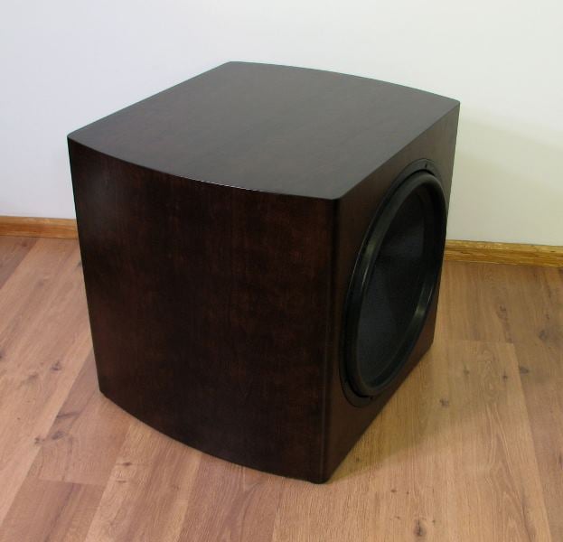

Q: Any words of wisdom on running two home subs. I've heard stacking them is best. I have two Monster Cable sub cables with Y's on them so L + R inputs on the subs will be used, and I plan to use another Y at the sub
output of the receiver. Any suggestions are appreciated. (BTW, they are 2 Phase Technology Power 10's with a Yamaha RX-V630 receiver.
Audioholics: This is a tricky question and contains many variables for proper assessment. However, generally speaking, it is usually easiest to achieve the best performance in a system with more than one sub to locate the subs in a common place. This assures minimal cancellation or phasing problems between the subs and will usually yield a much greater SPL output and lower extension then just having one sub. My best recommendation is to experiment and use some of the guidelines here:
Subwoofer Placement Tips
