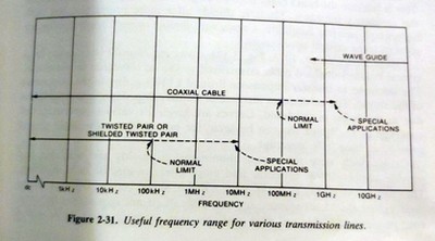

Coax vs Twister Pair Usable Bandwidth Comparison
(courtesy of Noise Reduction Techniques in Electronic Systems by Henry W. Ott)
Note: The above diagram shows the usable bandwidths of twisted pair vs coax cables. Twisted pair stops being effective at around 100kHz but Coax is useful out to 100Mhz. That's 1000 times the bandwidth! Don't let anyone EVER tell you twisted pair is a better option even at audio frequencies. Shielded Coax is just as applicable at audio frequencies as twisted pair cables. The same 75 ohm shielded Coax cables can be used to connect your component video, analog audio, and subwoofers. This cable type is that diversified!

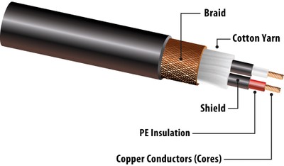

Balanced Cable Topology - Courtesy of BHPhotovideo.com
Balanced Audio
For applications regarding balanced audio transmissions, XLR cables are a must. XLR's are typically 3-conductor cables with a braided and/or foil shields. Pin-2 is positive "hot", Pin-3 is negative "cold" and Pin-1 is ground. The same principals of shielding we discussed with Coax type cables apply.
We suggested allocating slightly more budget towards analog than digital cables in systems that primarily use balanced XLR connections between the preamp, power amp and source devices.

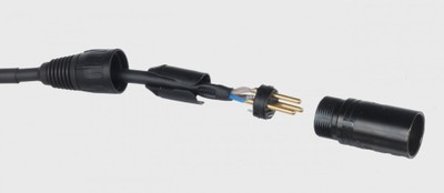

Neutrik Connector (Exploded View) - courtesy of BHPhotovideo.com
It's a good idea to take a look at how the manufacturer terminates their XLR cables. Poor solder joints or improper strain relief can spell grief overtime especially if you're constantly swapping out and upgrading components. The internal thread on the shell should be protected from damage. This can be done by shrink-wrapping solder points for added protection. Reputable companies will provide you pictures or diagrams of how their cables are constructed. Snake oil vendors will instead try to give you a lesson in metallurgy.
