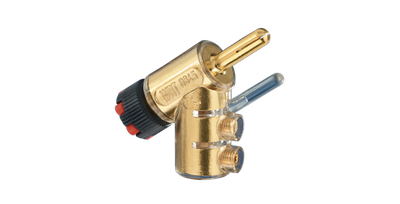

WBT Banana
WBT Compression Banana Connector
I also think it's important to chose cables that have quality terminations.  I prefer WBT compression banana plugs that you twist to expand into the speaker/amplifier binding post to make a very secure connection over bare wire or spade connectors.  Having a solid contact between the cable and the interfaces (speaker and amp/preamp) minimizes contact resistance and thus further minimizes losses.

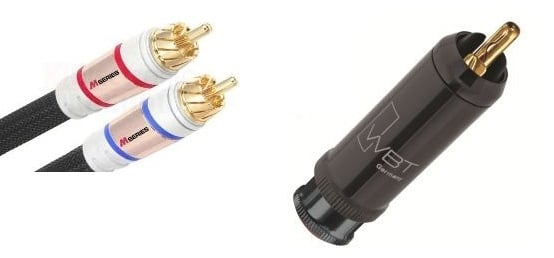

RCA Connectors
Turbine Connector (left Image)l WBT Compression Connector (right image)
If a cable can pass video signals over long distances with no problems, it will easily handle any line level audio signal.
Termination quality is also an important consideration.  I don't care for the turbine RCA connectors as they tend to lock down too tightly on an RCA jack which can actually rip off the connector if you don't carefully twist the cable as you are removing it from your AV gear.  Canare type RCA connectors make a nice snug, but not overbearing connection as do the compression WBT type connectors.

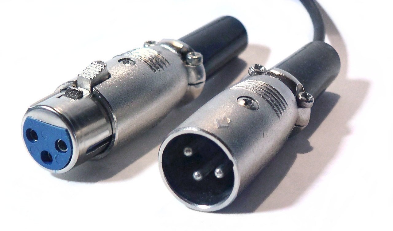

XLR Connectors
Balanced XLR Connectors
The same principles apply for balanced XLR cables.  I do prefer the locking balanced connectors that snap into place on the component gear as they make a more secure connection without risk of being accidentally pulled off if one should tug on a cable when getting behind their AV rack to make changes.

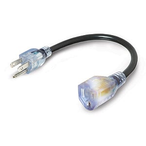

Power Cables
Power CordWhat about power cords (or chords) you might ask? In spite of some of the hogwash you might read, the only factor affecting performance is whether the gauge of the cord is adequate. Consequently, we simply recommend sticking with the stock OEM cables provided by the manufacturer. If a replacement is needed for some reason, buy a cable of the equivalent gauge. If you need a significantly longer power cord than the original, then it may be advisable to use the next sized lower gauge cable relative to the original cord, say from 16 gauge down to 14 gauge. Beyond that, we’ve seen no demonstrable differences between “high end” cords and their less costly brethren.
If you wish further reading on this topic, check out our very detailed article:  Audio Power Cords: Do they Really Make a Difference?
