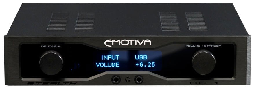

Emotiva Stealth DC-1 DAC and Headphone Amp

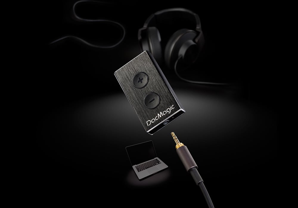

dacmagic XS
Some DACs are portable like the Cambridge Audio DacMagic XS

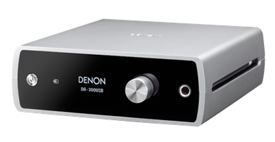

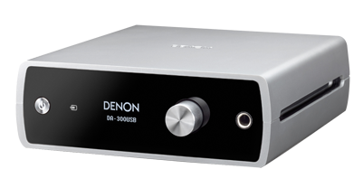

Denon DA-300USB
Denon DA-300USB DAC
If your player only has analog outputs (RCA red and white or simply a headphone jack), you can't add an external DAC. Well, sometimes you can but the external DAC is simply taking the analog signal from your player, re-converting it to digital and then back to analog, before sending it through. If the DAC in your player is the problem, this re-conversion process isn't going to help.
Those working with phones or portable players with USB outputs should also be wary before adding an external DAC. Some phones do conversion even over the USB connection so you won't hear a difference by adding a DAC. You'll want to make sure that the DAC is connecting digitally to your device (they should say this in the specifications of the DAC).
Lastly, you'll need some sort of amplification. If the DAC has a headphone output (and you will be using only headphones), then the amplification is built right in. But if you are connecting a set of speakers, you'll need either self-powered speakers (like many studio monitors) or an external amplifier to power passive speakers.
