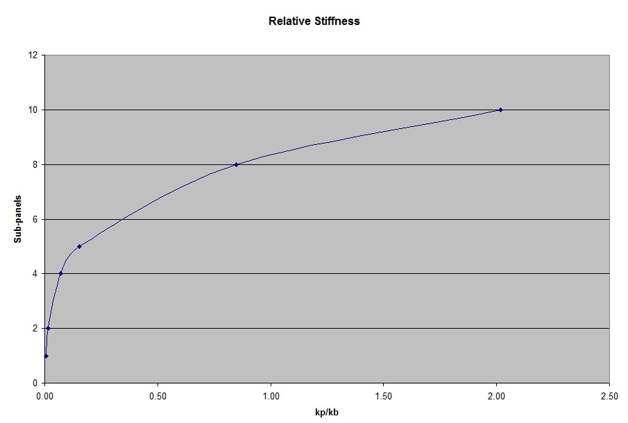

For the braces, we have the following stiffness equation under a triangular distributed load:
The length of each brace is constant at l = 18 inches, so the stiffness is also constant at a value of 3.36 k/in for a unit load.
From these values, we can establish a behavioral trend in ratios of component stiffness as plotted below.
Relative stiffness of sub-panels to braces
Taking the stiffness for the various sub-panels sizes divided by the constant brace stiffness, we can see the decreasing trend that occurs. As braces are added to a cabinet, each individual brace of a given size becomes less effective at restraining sub-panel edges, locally, as more are added because the sub-panels become smaller and therefore stiffer. This suggests that as the number of braces is increased, the braces also need to be increased in size to maintain effectiveness. Regardless of the local behavior, stiffness has been added to the system, so it also suggests that as braces with constant dimensions are added, the cumulative effect tends towards the global behavior, becoming similar to just thickening the panel.
For the case where the panel edges are clamped against rotation, we would see similar behavior. The rotational restraint would stiffen the overall panel, but with a constant brace size, we would plot a similar curve.
While we could attempt to look at calculations here, the answers will only be approximate. The mathematics above are exact closed form solutions, but they are for idealized boundary conditions that do not really occur, so we will now turn to finite element analysis to handle these intermediate conditions.

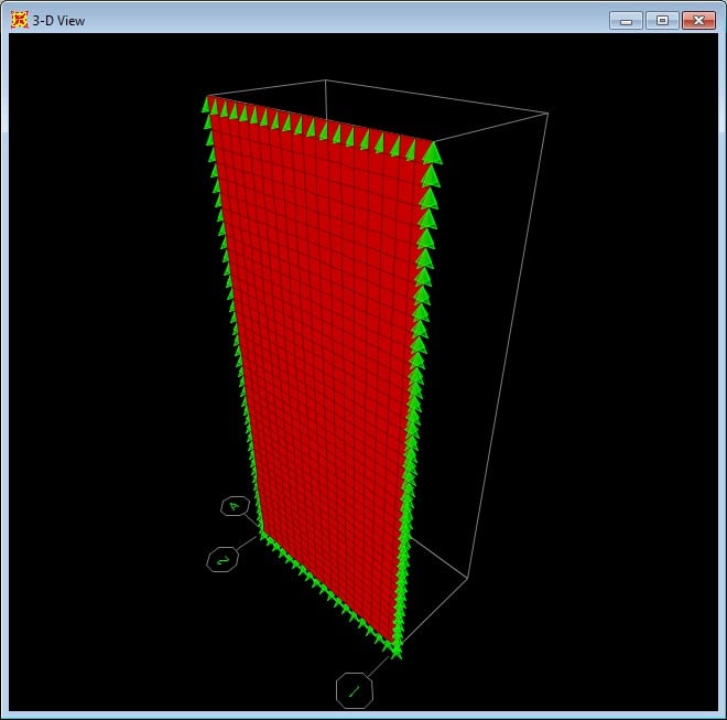

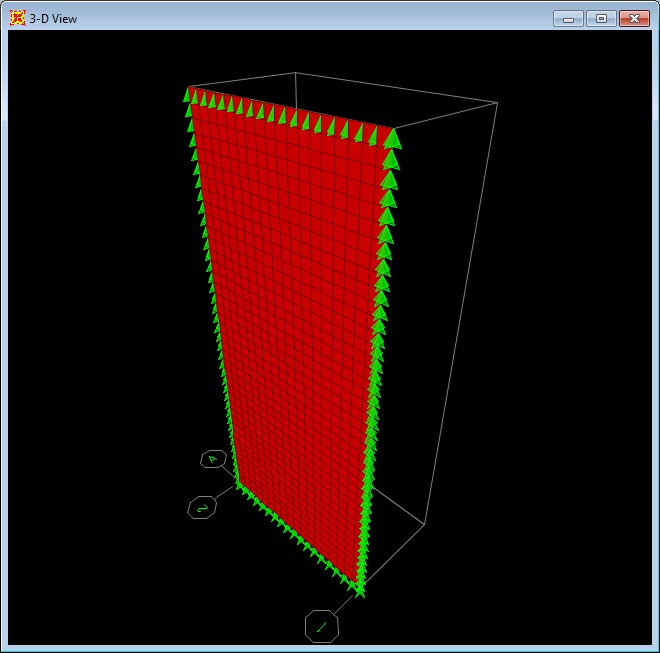

Finite element analysis of the problem was conducted using the program SAP2000 Advanced version 14.2.4, developed by Computers and Structures, Incorporated. SAP2000 is general-purpose finite element software package that is commonly used in structural engineering practice to model the mechanical behavior of physical systems. The software is capable of static and dynamic analysis in three-dimensional space including geometric and material nonlinearity. The dynamic capabilities include modal, steady state harmonic, response spectrum, power spectral density, and explicit time history analysis for a known excitation function. For our purposes, we will use the static, modal, and steady state harmonic analysis capabilities.
A series of five models of the panel were prepared with a varying number of two inch deep by ¾” thick braces at uniform spacing intervals matching the sub-panel configurations listed in the discussion above. The MDF panel and braces were discretized into one in square finite elements based on the Mindlin-Reissner thick-plate shell formulation that accounts for transverse shear deformation in the plane of the elements. The models were restrained against linear movement, but not rotation, at the panel edges.
Finite element model of the panel with lateral edge restraints.
These panel models are designed to address the partial restraint of the panel at the braces and the partial rotational restraint from the continuity of the sub-panels across the braces for case of the isolated cabinet side panel. The primary differences of the isolated panel model from an actual cabinet is from:
Partial lateral and rotational edge restraint from the perpendicular panels.
Partial restraint of the brace ends from adjacent braces around the cabinet.
Variations in the edge restraint due to different panel dimensions and the driver openings.
The additional mass of the drivers on the cabinet front affecting one side panel edge.
Partial support from the floor mounting to the bottom panel affecting one side panel edge.

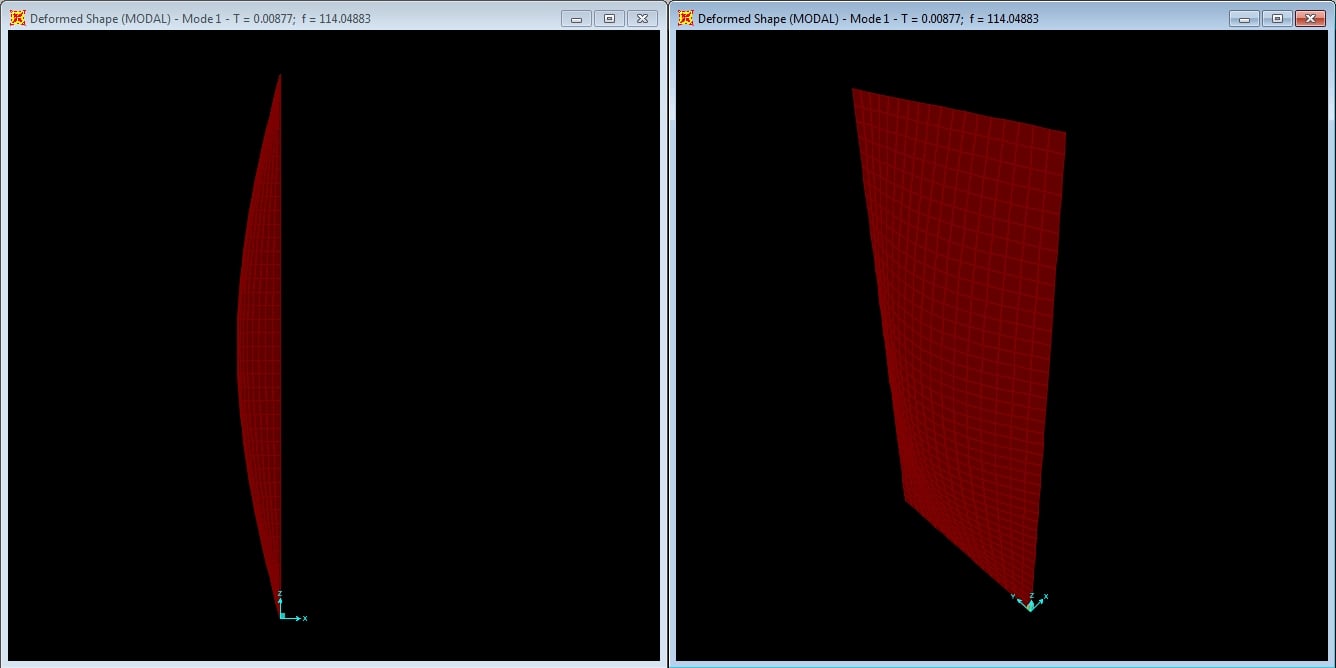

For the unbraced panel, we will first look at the undamped mode shapes of the first eight modes from an eigenvalue analysis. While mode shapes are non-dimensional in nature, a uniform scale factor of 0.01 was used for reference in the modal plots.
Note that in the plots, the z axis defines the panel length, the y axis defines the panel width, and the x axis defines displacements normal to the plane of the panel.
Mode shape with no braces, mode 1 at f = 114.05 Hz.
The first mode is the primary mode, which is a combined longitudinal and transverse width mode. This coupled modal behavior matches the static load deformation, having no inflection points along either the length or width of the panel.

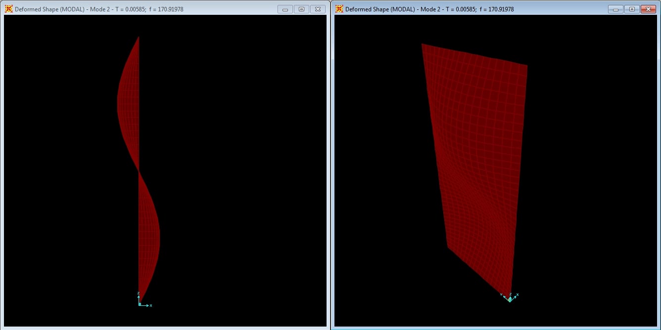

Mode shape with no braces, mode 2 at f = 170.92 Hz.
The first harmonic is the second longitudinal mode with an inflection point at the center along the panel length.

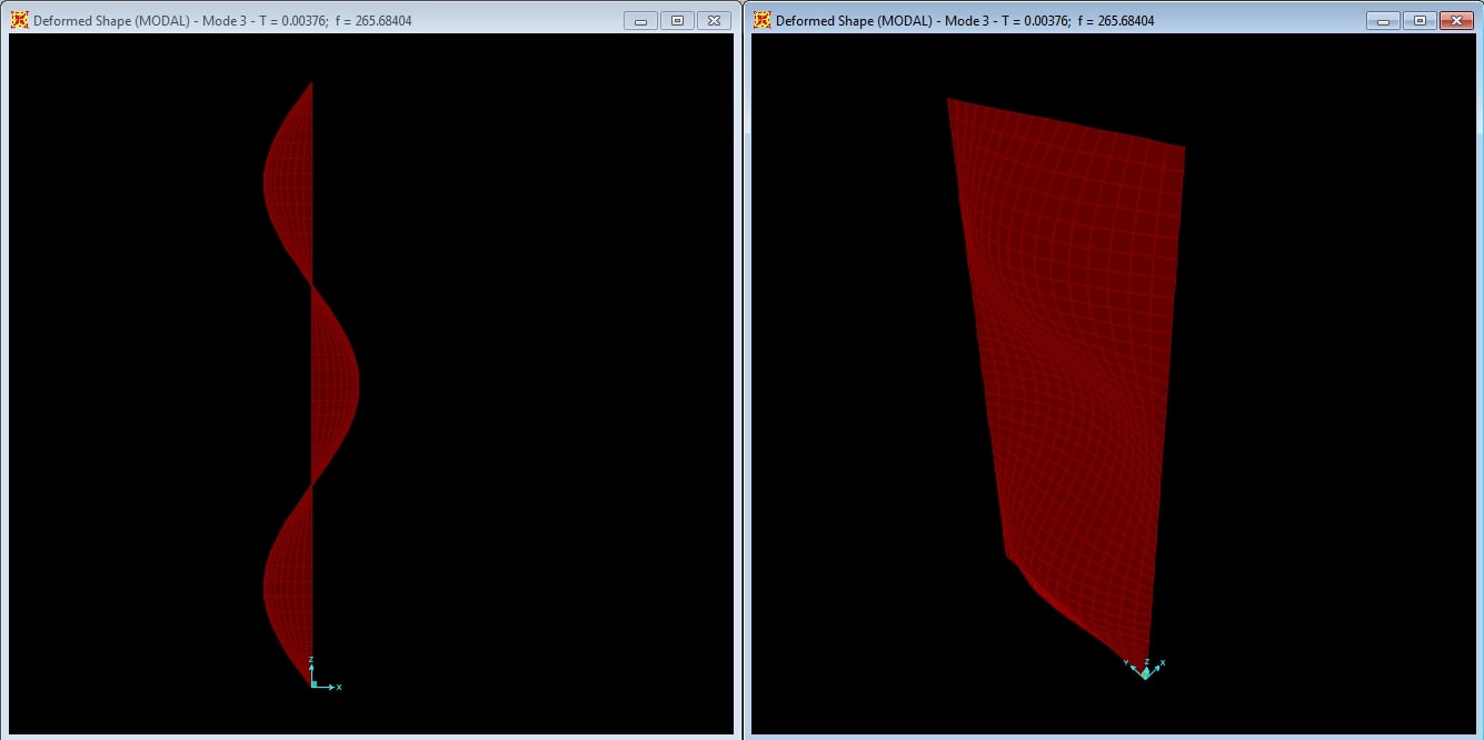

Mode shape with no braces, mode 3 at f = 265.68 Hz.
Mode 3 is the third longitudinal mode with inflection points at third points along the length of the panel.

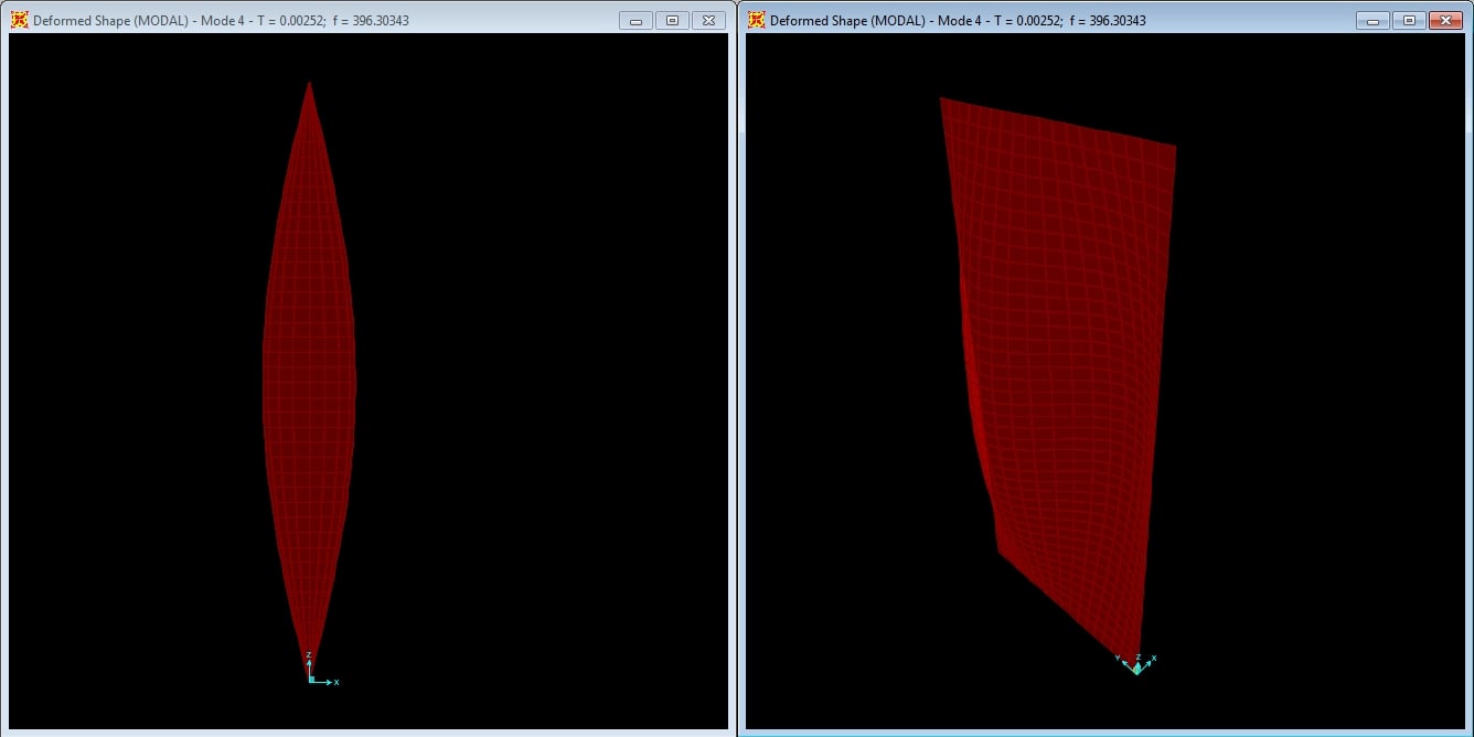

Mode shape with no braces, mode 4 at f = 396.30 Hz.
This mode is the second transverse mode along the width of the panel. A view along the width, y axis, rather than the length, z axis, would look similar to mode 2.

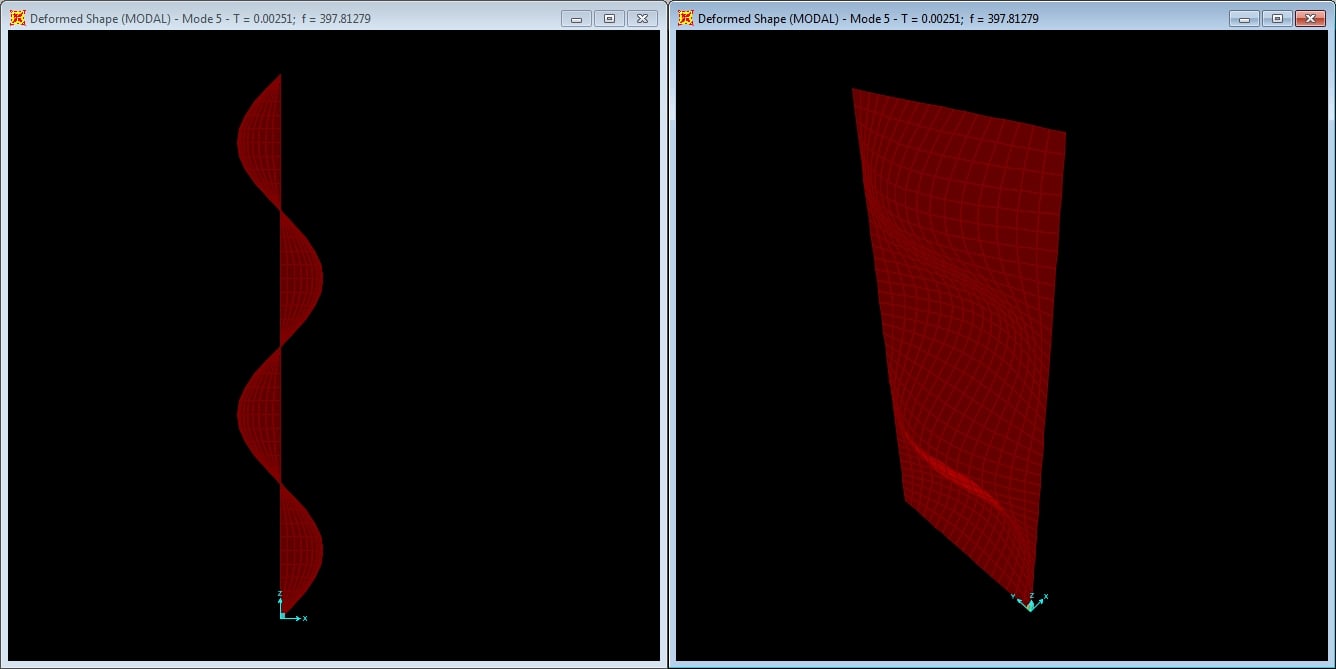

Mode shape with no braces, mode 5 at f = 397.81 Hz.
This mode behaves as the fourth longitudinal mode of the panel.

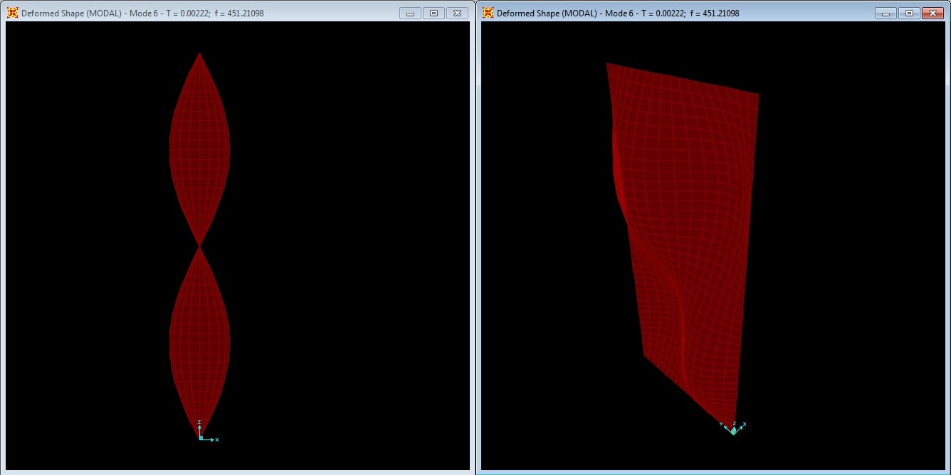

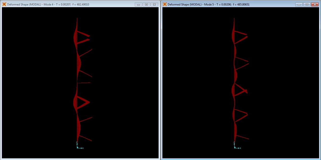

Mode shape with no braces, mode 6 at f = 451.21 Hz.
Mode 6 is another coupled mode that consists of a combined second mode in both the length and width, both having a single internal inflection point.

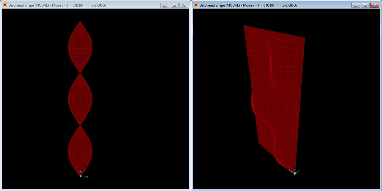

Mode shape with no braces, mode 7 at f = 542.60 Hz.
Mode 7 is also a coupled mode and is combined from the third mode along the length with the second mode along the width of the panel.

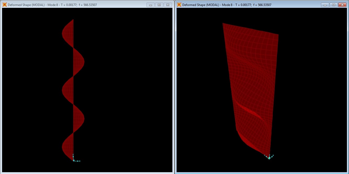

Mode shape with no braces, mode 8 at f = 566.53 Hz.
The eighth mode displays uncoupled modal behavior that is the fifth longitudinal mode.

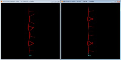

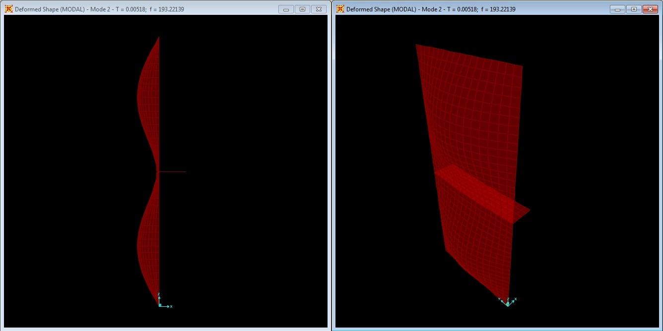

Now we will look at the mode shapes for the panels with various numbers of braces of a constant stiffness based on the 2 inch by ¾ inch cross-section. The modal behavior of the panel will be complicated by the additional mass of the stiffeners that not only add localized mass to the panel, but the mass is eccentric to the plane of the panel, which will introduce some rotational effects within the interior of the panel area. This effect will add some complexity to the modal behavior of the system.

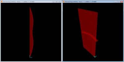

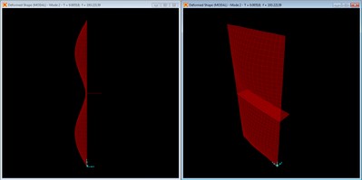

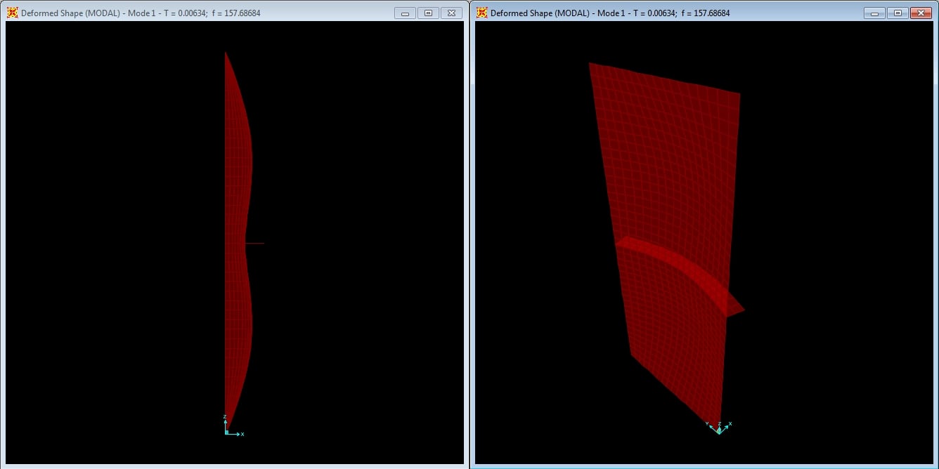

Mode shape with 1 - 2” x ¾” brace, mode 1 at f = 157.69 Hz.
A single centerline brace attempts to enforce the second longitudinal mode of the unbraced panel, but with insufficient stiffness to fully force an inflection point and the corresponding second longitudinal mode of the unbraced panel. Never the less, the natural frequency of the panel is significantly increased from the unbraced response at 114.1 Hz.

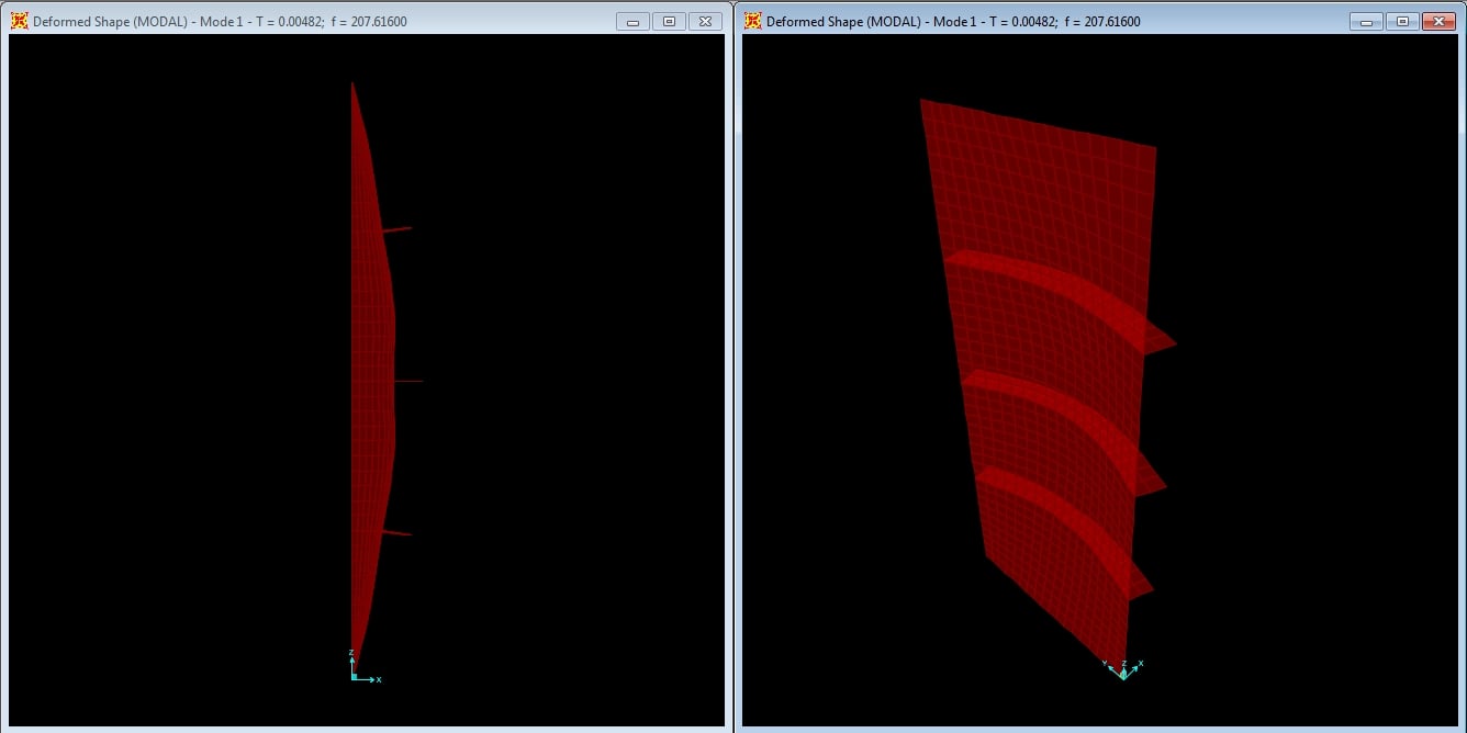

Mode shape with 3 2” x ¾” braces, mode 1 at f = 207.62 Hz.
The three brace configuration moves further from the matching the corresponding longitudinal mode of the unbraced panel, falling short of even the third longitudinal mode at 265.7 Hz. Once again, the natural frequency is substantially increased, above both the previous braced mode and the second longitudinal unbraced mode at 170.9 Hz.

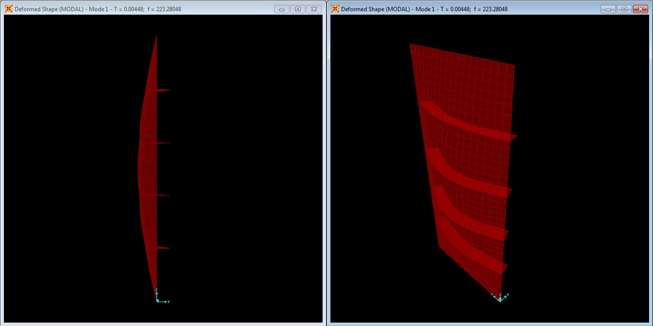

Mode shape with 4 2” x ¾” braces, mode 1 at f = 223.28 Hz.
We are now at the point where the need for additional brace stiffness is evident as the four brace configuration is barely able to generate noticeable local restraint at the brace points. This mode has a higher frequency than the three brace configuration, but falls short of the third unbraced modal frequency, showing behavior that is trending towards global rather than local restraint from the additional braces.

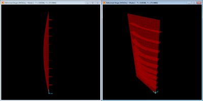

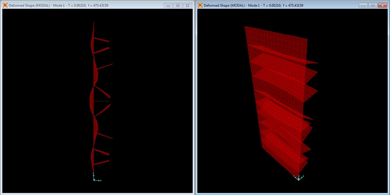

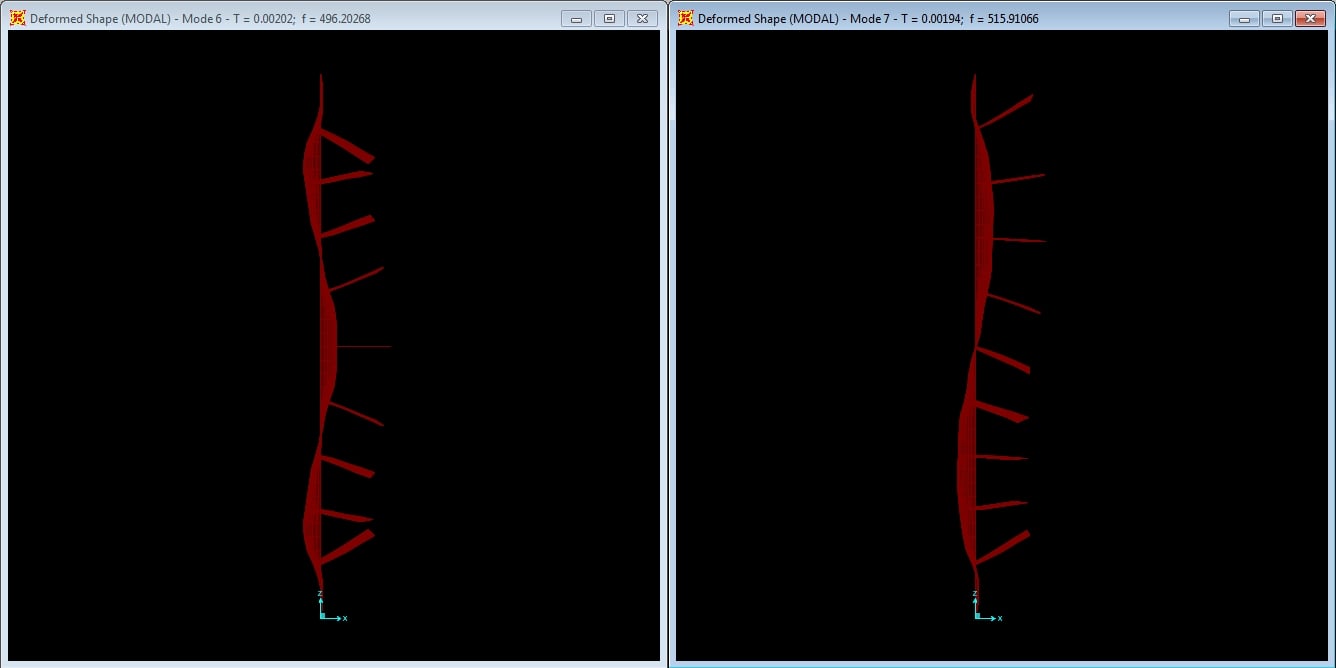

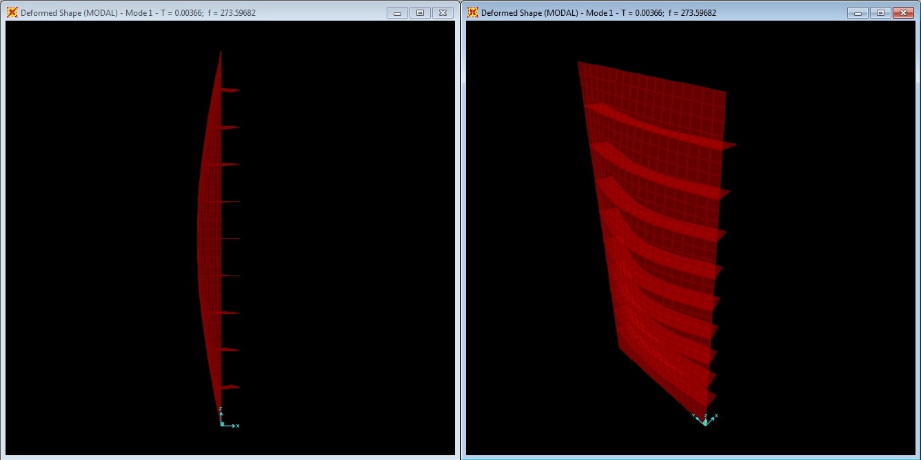

Mode shape with 9 2” x ¾” braces, mode 1 at f = 273.60 Hz.
The nine brace configuration effectively behaves as a global, higher frequency fundamental mode. The frequency is higher than that of previous four brace configuration, but just barely clears the frequency of the third longitudinal mode of the unbraced panel at 265.7 Hz.

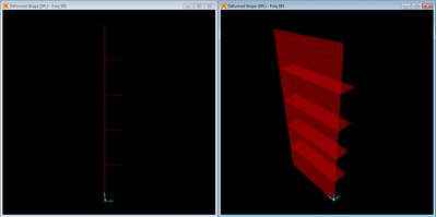

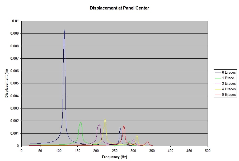

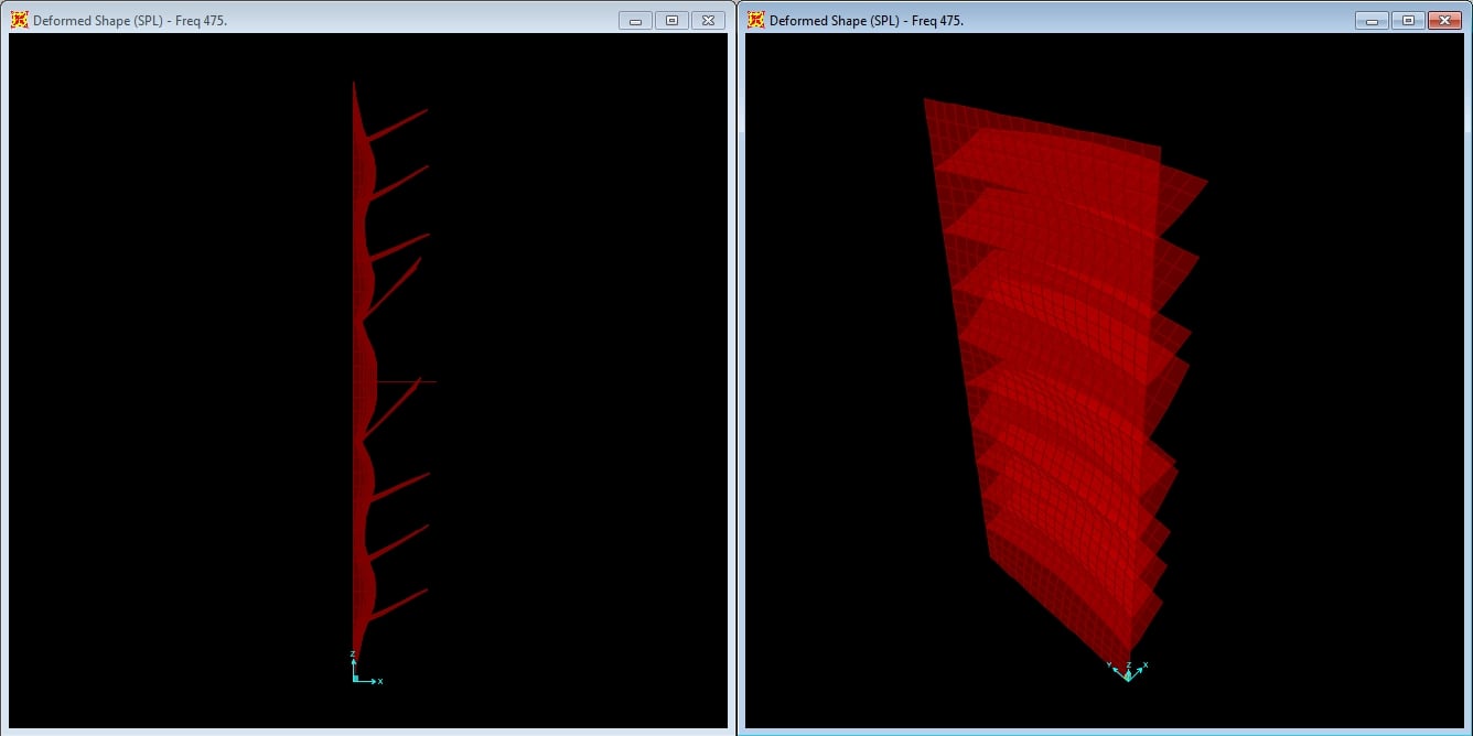

Next, we will look at the deformation of the panel with various braces near peak resonance from the harmonic loading. The plots are all scaled at a consistent factor of 2500.

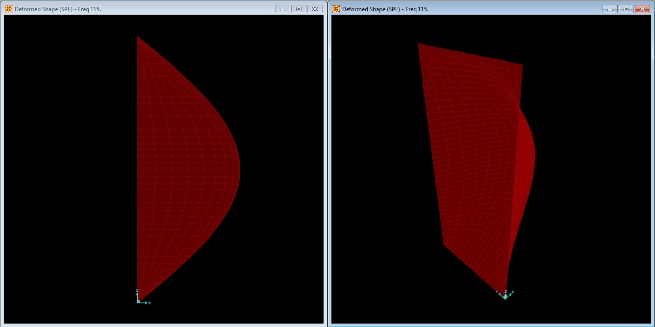

Deformed shape with no braces at f = 115 Hz.
The unbraced panel clearly shows deformation consistent with the corresponding fundamental mode shape.

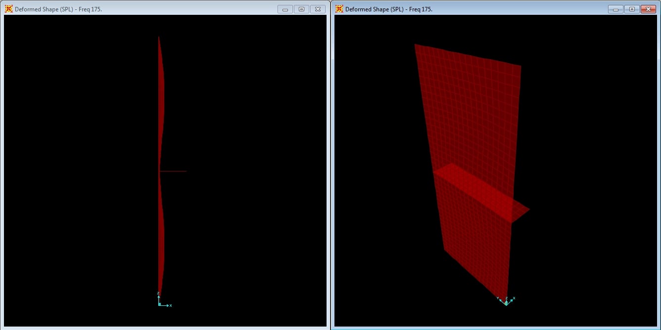

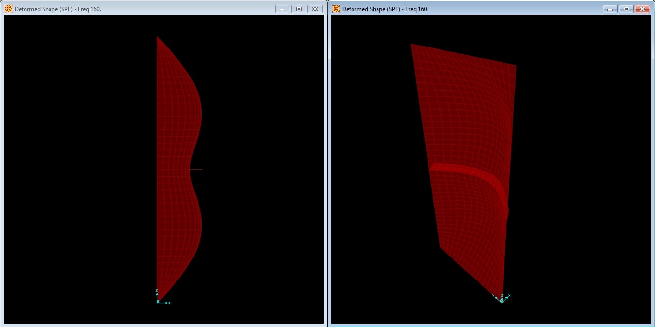

Deformed shape with 1 - 2” x ¾” brace at f = 160 Hz.
The deformation under harmonic load of the single brace configuration again matches the mode shape with the brace providing some localized restraint. Also, note the significant decrease in deformation compared with the unbraced panel.

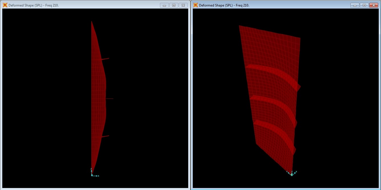

Deformed shape with 3 2” x ¾” braces at f = 210 Hz.
The trend is continued for comparison both with the corresponding mode shape and with the decrease in deformation from the previous brace configuration.
Deformed shape with 4 2” x ¾” braces at f = 225 Hz.
With an additional brace, the trend from local restraint behavior towards global restraint behavior continues to progresses from the previous case.
Deformed shape with 9 - 2” x ¾” braces at f = 275 Hz.
The effectiveness of the braces to locally restrain the panel continues to decrease with nine braces even as the global deformation is restrained further.
At this point, the behavior of the braced system is effectively that of the fundamental mode of the unbraced system, but with a higher frequency and reduced displacement, as shown in the following plots.

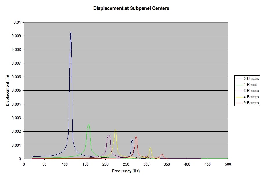

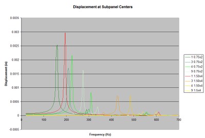

Displacement, panel center, for various numbers of 2” braces.
Displacement, sub-panel center, for various numbers of 2” braces.
The plots are based on displacement at the center of the panel or sub-panels formed between braces nearest the center of the panel.
Plotting the maximum displacement clearly shows both the decrease in displacement and the relative decrease in effectiveness of each additional brace with a constant stiffness.
There is also some shifting around of the relative effectiveness between different numbers of braces. This is another indication of the decreasing effectiveness of more bracing without increasing the stiffness of the braces as the system transitions from local to global behavior with mode shapes similar to the unbraced fundamental, but with increased frequencies and reduced displacement. This shifting of displacement amplitudes could easily be misinterpreted as the additional bracing is not effective, but it is only an indication of the transition that is occurring.

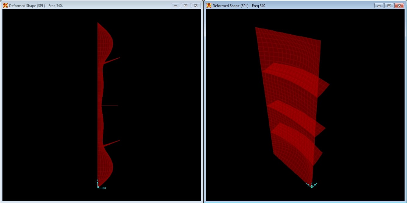

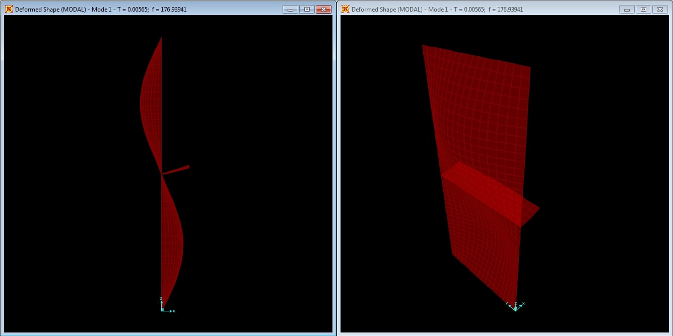

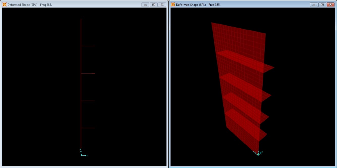

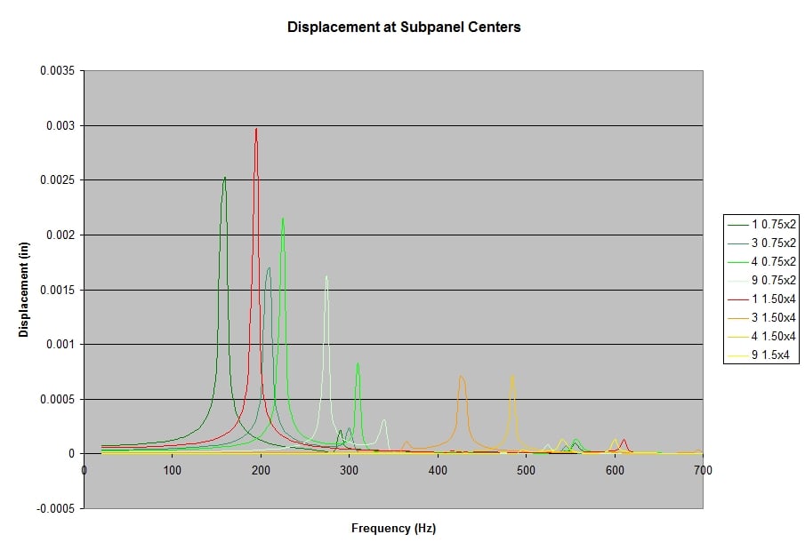

Loudspeaker Cabinet Bracing: Finite Element Analysis - Part II

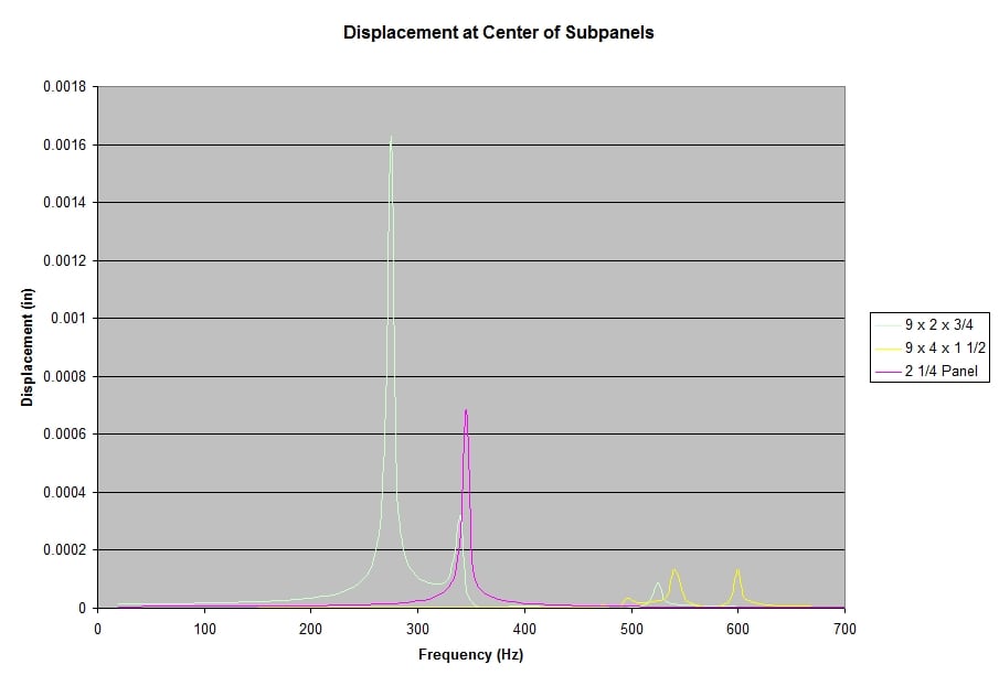

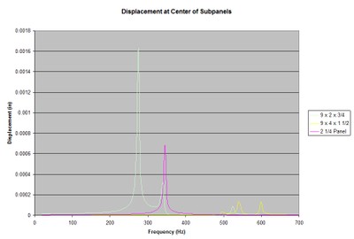

To better understand what is happening, we will now explore the system behavior of the braced panel with stiffer braces. The previous braced panel models were each rerun with the 2 x ¾” brace replaced by a 4 x 1½” brace, which has significantly greater stiffness, resulting the following mode shapes and frequencies.

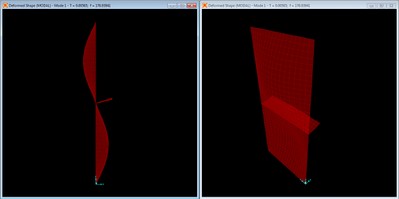

Keep in mind, that the increased mass and greater eccentricity of that mass from the plane of the panel will increase rotational effects on the panel and this will further complicate the modal behavior of the system. The additional complexity of the modal behavior also makes it more difficult to correctly interpret results with limited information from measurements.
Mode shape with 1 4” x 1½” brace, mode 1 at f = 176.94 Hz.
The increased brace stiffness is able to fully force the first mode of the braced panel to the second mode of the unbraced panel. The resulting frequency is slightly higher than the corresponding unbraced mode, indicating the stiffness more than overcomes the additional mass. Also, note the slight rotational effect on the brace from mass eccentricity.

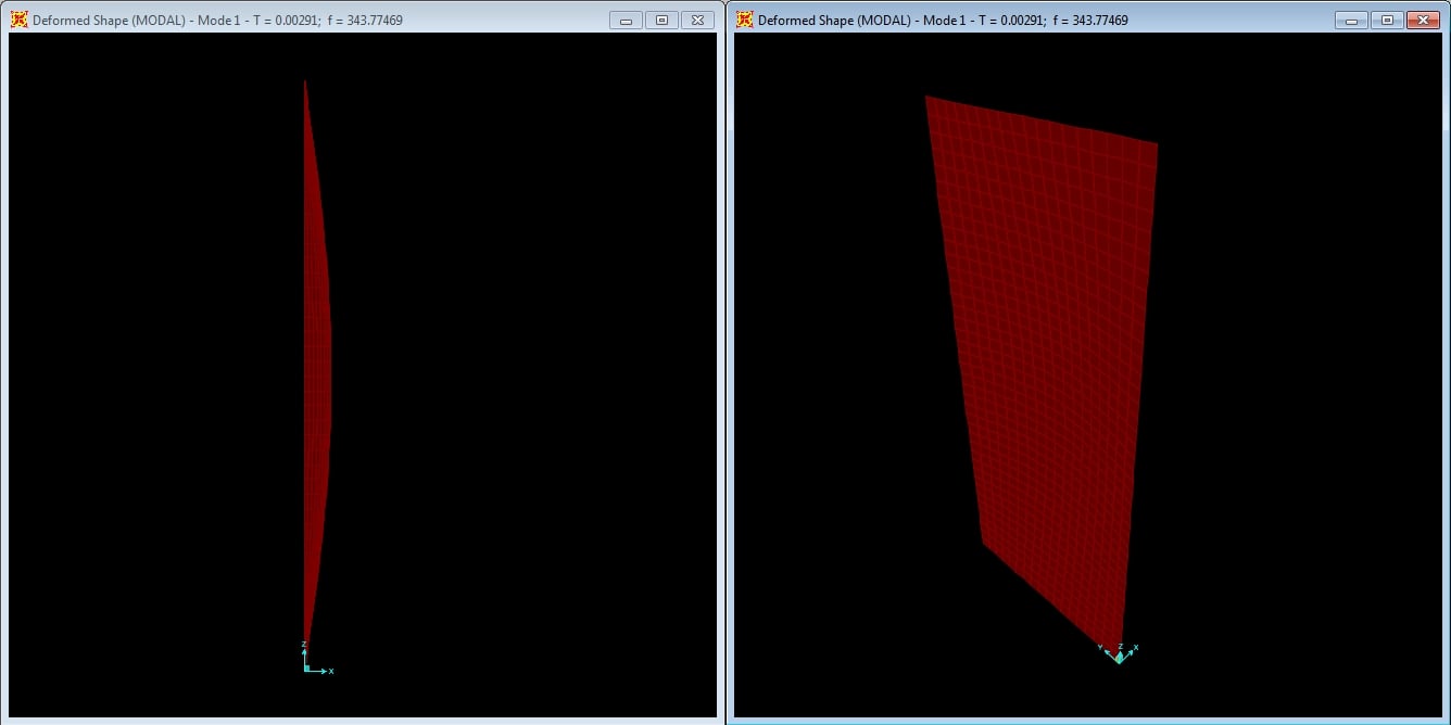

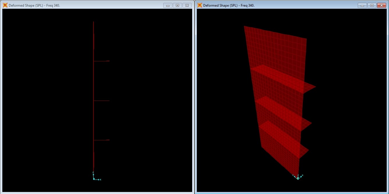

Mode shape with 3 - 4” x 1½” braces, mode 1 at f = 340.98 Hz.
With three braces at the increased stiffness, the first braced mode is forced nearly to the fourth unbraced mode. The inflection points are slightly shifted from the brace points, which is consistent with the somewhat lower natural frequency and is due to a combination of lower relative stiffness, additional mass, and the mass eccentricity.
Mode shape with 4 4” x 1½” braces, mode 1 at f = 384.18 Hz.
The four brace configuration approaches the fifth longitudinal mode of the unbraced panel, but falls short of the frequency with slight, but visible shifts of the inflection points from the braces.
Mode shape with 9 - 4” x 1½” braces, mode 1 at f = 475.43 Hz.
Nine braces are only able to enforce a mode similar to the fifth longitudinal mode of the unbraced panel. Note that the frequency has increased considerably from the previous four brace configuration, although the modes are similar.
For comparison, we can also look at the unbraced panel with a 2¼” thickness, which uses a similar amount of MDF material to the nine brace panel above.
Mode shape with 2¼” thick panel, no braces, mode 1 at f = 343.77 Hz.
While the fundamental frequency is significantly higher than for the same mode of the ¾” panel, it is also significantly lower than the braced panel with a comparable amount of material. Also note the similarity of the shape to that of the nine 2” x ¾” brace system. The frequency is improved in this case, but at a cost of 50% more material.

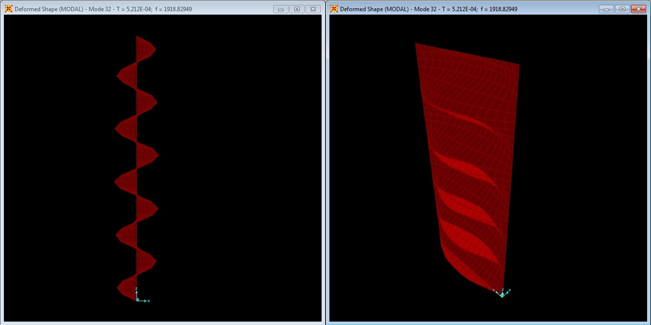

Returning to the original ¾” thick unbraced panel, we will look at the 10th longitudinal mode that the nine brace configuration theoretically would induce with sufficiently stiff braces.
Mode shape with no braces, mode 32 at f = 1918.83 Hz.
To generate enough restraint to develop a mode this high, braces made of MDF would be prohibitively large and very likely not fit in the cabinet. At this point, it would make more sense to use a different material that is naturally stiffer, one with a higher modulus of elasticity. One possibility would be to use aluminum, which is common in other uses in the loudspeaker industry. With a modulus of 10,000 ksi, an aluminum brace would be approximately 17.2 times stiffer than a brace with the same cross sectional area made of MDF.
We will now look at the deformation of the braced panel near peak resonance from the harmonic loading. The plots are scaled at the previous factor of 2500.
Deformed shape with 1 - 4” x 1½” brace at f = 175 Hz.
With a single brace, the resonant deformation is significantly depressed compared with the smaller brace. The brace is also stiff enough to approach the condition assumed for the calculations in the preceding section where the panel was assumed to not deflect at the brace location.
Deformed shape with 3 4” x 1½” braces at f = 340 Hz.
The deformed shape is almost completely suppressed at this scale, so the deformation will be plotted again at 40 times the previous scale, a factor of 100000.
At ten times the previous scale, the restraint from the braces can be seen. The difference in the deflection of the outer sub-panels from the inner is due to the rotational restraint of the inner sub-panel edges from the adjacent panels, while at the outer edge there is no rotational restraint. This condition differs from the assumptions made in the previous section, but is captured in the more rigorous finite element analysis.
What also should become clear from this plot is that the point of measurement and comparison is important to proper interpretation of results. We have been using the sub-panel center point nearest the center of the overall panel. We will continue to do so for consistency, but what also should be clear is that any testing and measurement regiment used in prototyping loudspeaker cabinet vibration based on a limited number of measurement points could produce misleading results.
Deformed shape with 4 4” x 1½” braces at f = 385 Hz.
At the original 2500 scale factor, the panel deformation is not visible, but increasing the scale as before, we can see the deformation.
At the increased scale, the deformation shows visible restraint at the braces consistent with the fifth longitudinal mode of the unbraced panel.
Deformed shape with 9 4” x 1½” braces at f = 475 Hz.
The original scale factor does not show any noticeable deformation under load.
At the increased scale, deformation similar to the fifth unbraced panel longitudinal mode is visible. Note that restraint points occur near the second and fourth braces in from the panel ends, the same locations as in the corresponding mode shape.
As the number of the stiffer braces has been increased, we can see the reduced effectiveness in forcing modes that match the brace configuration, but now this transition occurs at a much higher mode number and frequency than with the less stiff braces. Using 2 inch deep braces, the system was only forced to the equivalent of the second unbraced mode, but with the 4 inch deep braces, the system is forced to the equivalent of the fifth unbraced longitudinal mode and the corresponding frequencies are nearly doubled.

Plotting the deformations of the various 2 x ¾" brace configurations with the 4 x 1½” brace configurations under the harmonic loading will allow us to compare the resulting behavior.
Displacement, sub-panel center, for various numbers of braces.
Reviewing the results in the plot, the general trends of increased cabinet frequency and suppressed resonant displacement is clear. Going to the four inch deep braces in a clear improvement for all cases except for the single brace. The transition to where the braces are not stiff enough to force a higher mode is evident in the flattened peaks for three and four of the deeper braces, but suppression of resonant amplitude continues to the nine brace configuration.
For the single four inch brace, not only is the resonant amplitude slightly increased, but also the peak is not quite at the frequency of the first mode. Investigating the second mode, we can see the source of the discrepancy in the mode shape with a closely spaced frequency and both halves of the panel in phase with a shape matching the deformation under load, which would be easier to excite. The shape and close proximity of the second mode mask the first mode and produce the greater resonance.
Mode shape with 1 4” x 1½” brace, mode 2 at f = 193.22 Hz.
Focusing in on the nine brace configuration, we can look closer at the displacements and compare them with the results of just thickening an unbraced panel.
Displacement, sub-panel center, for thickened panel versus nine braces.
Comparing the nine 2 x ¾" braces to both the 2¼” thickened panel and the nine 4 x 1½” brace configuration, we can clearly see the vast improvement to resonant displacements from the additional stiffness. We can also see that just thickening the panel with an equivalent amount of additional material as the 4 inch deep brace configuration does not produce results that are as effective. This is due to the higher modal behavior of the braced panel.
At the increased plot scale, we can also see that four inch brace configuration has some unusual features. The first mode does not produce the highest resonant peak, which occurs at the second and third peak with similar levels.
Modes 2 at 475.68 Hz and mode 3 at 481.15 Hz.
Modes 4 at 482.49 Hz and mode 5 at 485.81 Hz.
Modes 6 at 496.20 Hz and mode 7 at 515.91 Hz.

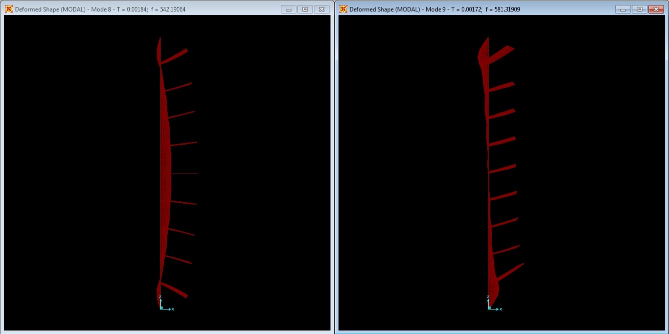

Reviewing the modes for this condition, we find that the first six modes form a cluster between 475 and 496 Hz flipping back and forth between four and six half-wave mode shapes. These clustered modes partially cancel each other out, producing the reduced first peak.
Modes 8 at 542.19 Hz and mode 9 at 581.31 Hz.
The modes start to spread out by the seventh at 516 Hz and eighth at 542 Hz, which is at the first of the two larger peaks.
