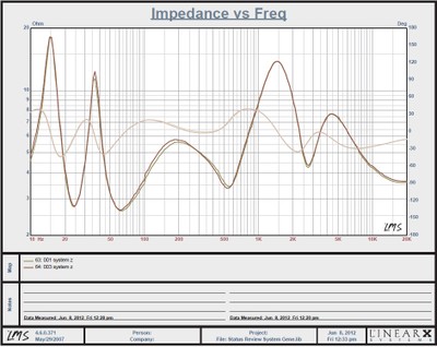

- Challenging load impedance

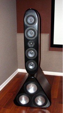

The
Status 8T speaker system is a modular design consisting of separate
left and right satellite and bass modules connected via a very clever
bracketing system. Each bass module houses three (3) high excursion
10” aluminum drivers and each satellite module contains four (4)
6½” Beryllium midrange drivers and a 1” Beryllium dome tweeter.
Status Acoustics shipped the 8T's with the bracket that holds the
speakers together connected to each bass unit.
Fully assembled, the 8T weighs 345 lbs per speaker. The bass module weighs 175 lbs. and the satellite portion another 135 lbs. The bracket that holds them together weighs 35 lbs. It took four of us to hoist these speakers up my flight of steps to the Audioholics Showcase Theater room. The entire process made me question whether I will attempt to review such a large speaker ever again - reviewers in single-story houses definitely have the advantage here.
The primary design goal of the 8T speaker system, per Status Acoustics, is to produce true-to-life natural sound with realistic imaging characteristics and unrestricted dynamic range, while maintaining a small visual profile that is also aesthetically pleasing. Just what did they do to attempt to make this speaker system live up to such a claim? Let's take a tour of its design to find out.

The
Cabinets
In all my years reviewing loudspeakers, I've never seen more rigidly constructed cabinets. The satellite module is so dense and heavy that you know, just from picking it up, that this is no ordinary speaker. A knock test reveals a deadening thud, almost like you're rapping on a solid slab of granite. Peering inside the satellite speaker, I began to understand why this was the case. Status Acoustics utilized a proprietary method of bonding multiple layers of 1” HDF to effectively make a solid cabinet. This expensive process gives the 8T its unique look while also allowing the cabinet wall thickness to be varied without the limits typically imposed by traditional panel construction, allowing for more extensive internal bracing. The end result of this method is cabinets that are more acoustically inert for optimum sound quality. Cabinet panel resonances are greatly reduced with this design, resulting in superior definition throughout the mid and bass frequency range.
For
the satellite cabinet, each driver is completely isolated inside
their own chambers. This isn't done via cheap plastic cups like
with lesser designed speakers. These are effectively solid wood
chambers bored out from the multiple bonded HDF layers customized for
each driver. This is done not only to physically and mechanically
separate each driver but to reduce standing waves in the chambers. In
addition, there are no parallel walls inside the cavities, which
further reduces standing waves. In conjunction with this no holds
barred construction method, Status Acoustics employed special damping
materials to greatly reduce backwave energy which would ordinarily
radiate back through the cone of the driver.
The subwoofer module has a spacious 5.5 ft^3 internal volume shared among the three bass drivers which also has non-parallel walls to reduce standing waves. A special damping compound (which Status says is superior to polyfil and fiberglass due to a higher absorption coefficient at bass frequencies) amply fills the enclosure to absorb acoustic backwave energy and in effect causes the bass drivers to see an even larger enclosure which extends the systems usable frequency response.

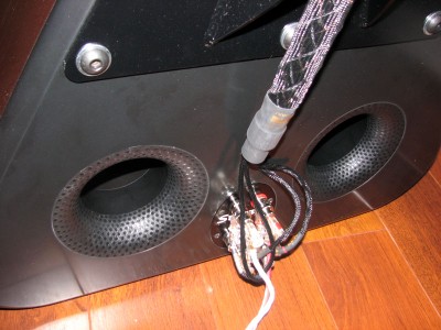

The Status 8T bass modules are 4th order rear vented enclosures using large flares on both ends of the 4” diameter ports each about 18” in length. The ports are dimpled similar to the ports of upper end B&W speakers to further reduce turbulence. Having multiple bass drivers and multiple surfaces of radiation allows for increased modal density which produces more uniform bass loading into the room compared to a single driver design with the port on the same face as the driver.
Status 8T Bass Module with Dual 4” Dimpled Ports
The front and back cabinet baffles for both the bass and satellite modules are quite unique. They are made of an acrylic polymer which has superior acoustic damping properties compared to wood baffles. By using the combination of materials (acrylic polymer baffles combined with layered HDF in the cabinets) this virtually eliminates colorations caused by cabinet resonances.

The Driver Topology
The Status 8T system employs an MMTMM driver arrangement which basically sandwiches a tweeter between the vertically oriented midrange drivers. Status Acoustics takes this traditional design approach up a notch by incorporating an additional top and bottom midrange driver which improves control of vertical dispersion, lowers system distortion and increases dynamic range. All of this can be attributed to how the speaker system produces a more palatable sense of realism which I will discuss further in the listening portion of this review. It's been my experience that a vertical MTM sounds more natural, dynamic and lifelike than a conventional MT driver alignment. This type of driver arrangement allows for more control over floor and ceiling room reflections and provides a higher ratio of direct vs. reflected sound at the listening position. In a very basic sense, multiple vertical oriented drivers operating in the same frequency range behave as if they were a single larger driver of their combined dimensions. Therefore in the vertical plane, the Status 8T has the vertical dispersion characteristic of a huge driver, which is also very narrow. Hence there is very little midrange energy going up to the ceiling or down to the floor and therefore, those destructive, detail-smearing reflections are minimized.
Status Acoustics chose to make the satellite portion of the 8T system a two-way design. They claim it sounds more cohesive with a high quality two-way crossover as opposed to a 2.5-way network. A two-way crossover does not have the additional phase shift between drivers you would get with a comparable 2.5-way network.

The Bass Drivers

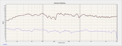

Each Status 8T bass module comes loaded with three (3) 10” high excursion aluminum cone subwoofer drivers. These drivers feature a 2.5” voice coil and 12.5 lbs heavy duty motor structure with a vented pole piece and aluminum former with the leads sewn into the cone to prevent breaking. The aluminum cone serves as a heatsink to increase power handling. The driver employs a 2.5” diameter 1.3” voice coil and has a 1” peak linear travel. The bumped backplate design eliminates the possibility of bottoming out the driver under heavy excursion.
I torture-tested these subs by running them as the left/right main channels fullrange while directing bass to them from the LFE channel and ALL channels (center + surrounds) set to "small". On bass intense Blu-rays at above reference levels in my large room, I was unable to bottom the drivers or cause any serious audible distress. In fact, I ran out of available amplifier power from my Classe CT-2300 amp (600 watt+ @ 4-ohms) while the Status drivers were still hungry to pump out more SPL's.
Status 10" Aluminum Woofer (left pic); Status 6.5" Beryllium Midrange (right pic)
The Midrange Drivers
Each Status 8T satellite module features four (4) 6½” Beryllium/Aluminum phase plug drivers. The driver basket is a high quality cast aluminum (no cheap stamped metal parts here). Employing Beryllium in the cone improves on aluminum by offering a stiffer, lighter-weight cone with a less pronounced breakup mode that is shifted further beyond the bandwidth in which the driver is being used. Energy storage retention is also reduced. Youngs modulus (a measure of stiffness) is higher with Beryllium, meaning the cone will flex less under stress. The Beryllium alloy cone also produces a more linear transition in the stopband for smoother integration between the drivers. The phase plug reduces moving mass and on-axis beaming and also serves as a heat sink and, to a smaller extent, offers venting for the voice coil. There is also a rubber stopper affixed to the cone to further reduce air turbulence through the gap. A lot of engineering went into this driver, and it certainly shows in droves in performance (see our measurements later). Employing four of these drivers in the design not only expands the soundstage but also assures effortless dynamics in the midrange at all power levels.

The subwoofers in the bass module utilize their natural rolloff for several octaves before employing a 2nd order electrical lowpass filter. This allows for the best possible integration between the bass and satellite modules. The midrange drivers use an asymmetric bandpass filter to effectively filter bass frequencies for increased dynamic range while also seamlessly integrating with the tweeter. The tweeter utilizes a 4th order HPF @ 2500Hz. This ensures increased power handling and better integrates the tweeter with the summed response from the midrange drivers.

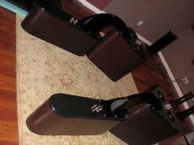

me reiterate that it took four of us to haul the 8T speaker system up
my flight of steps to the Audioholics Showcase Theater Room - and
that was moving them as separate pieces with the bracket attached to
the bass module. Assembling the 8T system once moved upstairs was
pretty easy. By laying the system on the floor, we bolted each
satellite speaker to the bracket of its corresponding bass module and
then lifted it up from the ground from the top. A speaker this
heavy and massive needs no outriggers or feet but we placed 2”
vinyl discs under the bass module so it would be fairly easy to move
the speaker system into position.

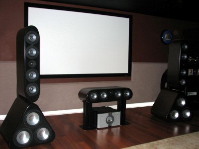

We placed the left/right speakers about 3 1/2ft from the back wall and 10ft apart with the primary seating area about 13ft away. We found only a modest amount of toe-in was needed for these babies to really work their magic in my listening space. In fact, I’d guesstimate it was about 10 degrees of toe-in that did it. From the seated position, this also made the connection bracket disappear giving the illusion that the satellite module was floating above the bass module. Very cool effect!
We tested the Status Acoustics 8T speakers with all of the best gear available to us. We broke this into two separate systems with the dedicated two-channel system consisting of a Marantz PM-11S2 Preamp, Pass Labs X350.5 two-channel amplifier, a Marantz TT-15S1 turntable and analog balanced outputs of the Oppo BDP-95 Universal Blu-ray player as the sources. The second system consisted of the Denon AVP-A1HDCI A/V processor, Denon POA-A1HDCI multi-channel amplifier, Classe CT-2300 two-channel amplifier and the Oppo BDP-95 Universal Blu-ray player via the HDMI output. Speaker cables were all Kimber 8TC and interconnects were Bluejeans Cable 1694 COAX and balanced cables. The listening space is a 6,000 ft3 room that is moderately acoustically treated, courtesy of Auralex Acoustics.
Assembling the Status 8T System
The Status 8T system had to be assembled face down. Once the bracket was secured on the bass and satellite modules, we lifted them up from the top and slid them into position.
Status Acoustics 8T & 8C Speaker System installed in Audioholics Showcase Theater Room

Status 8T Tower Speaker Installed in Audioholics Showcase Theater Room
From mids to highs, I’d say both systems had a very similar ability to effortlessly produce clean fidelity and dynamics, but the Status 8T system just did so with more intimacy and immediacy in the soundstage. The sound seemed more precise and focused on the 8T system while it also seemed more uniform off-axis thanks to the fact that the 8T system employed a single tweeter over the multi-tweeter design of the T30-LSE system. It was truly impressive to hear a single tweeter design able to take the punishment I gave it and it made me realize just how special and worthy this $500 beryllium tweeter really is.
From a bass standpoint, the 8T system trounces the T30-LSE’s. The Status 8T system not only has a lot more bass output capability thanks to the extra 10” bass driver and more port area, but it also has the advantage of radiating bass from several surfaces of the cabinet. This increases modal density loading in the room and allows for a much more linear and smoother bass response across the entire listening area. With my T30-LSE system I always felt the back row had a bit of a boomy sound to it , which I could only smooth out with active equalization. The Status 8T system needed no EQ at all and the additional subs I had were kept only for multi-channel usage, but even they weren’t really needed. I had plenty of extension and output from just the Status 8T bass modules and they sounded great on their own no matter where I sat in the room. Quite frankly, this was a real shocker for me. I was able to run the Status 8T system as a full-range tower for my theater rig, routing all bass and LFE to them, achieving theatrical levels of bass for truly satisfying movie watching and concert listening experiences. I’ve never been able to do this with another loudspeaker system before because all others either lacked the depth and output capability or they were unable to produce such consistently good bass for every seat in my room.
Another aspect of performance that boggled my mind with the Status 8T system was the fact that I experienced no appreciable tonal shifts from seated to standing position or moving my head from left to right at my primary seating area. Because of the asymmetry of my room I’ve often wrestled with this problem with virtually all speakers I’ve had in for review (especially multi tweeter designs like the T30-LSE’s), but the Status 8T system simply didn’t accentuate this issue. I later realized that it perhaps had something to do with the fact that the very top and bottom midrange drivers of the 8T system were virtually equidistant from the ceiling and floor surfaces, respectively. Perhaps this helped produce consistent ceiling and floor reflections. Also this speaker allows a much higher proportion of direct sound to reach the listening area helping to mask room acoustical anomalies. It was obvious to me that the Status 8T system was well suited for my listening space.

Impedance / Phase Measurements of the Status Acoustics 8T Speaker System
Separated
Impedance of the Status Acoustics 8T Speaker System
Purple
trace: bass module ; Blue trace: Satellite module
The first impedance/phase sweep was taken on each Status 8T system configured with the satellite and bass module wired together for single amplification mode while the second measurement graph separated the impedance of the bass and satellite modules. Thanks to tight tolerances in parts and consistency in cabinet stuffing, both speakers measured nearly identical throughout the entire audio bandwidth. I’ve never seen a pair of speakers track this closely, especially ones with multi drive units like this system.
The Status Acoustics 8T speakers appear to be tuned at around 22Hz, but the peaks are slightly asymmetric indicating the system is tuned a bit higher than the driver's resonance frequency. This allows for more power handling down to 20Hz region. Because of the multi-driver array paralleling essentially three 8 ohm bass drive units, the Status 8T system can be a strenuous load for an amplifier, dipping down below 3 ohms in the lower bass regions. I was puzzled why Status Acoustics didn’t employ 12 ohm drivers to keep the system impedance above 4-ohms so I asked Shane Rich.
Editorial Note about the Low Impedance of the Status 8T System by Shane Rich:
1. Let me answer the question with a question. Why would anyone design a 4 Ohm speaker vs. an 8 Ohm speaker? The same logic applies to your question. Again, this is assuming we are using amplifiers that are capable of putting out the current necessary to extend the dynamics of the system at lower impedance loads. Case in point, the voltage rails of my ADA amp are about the same as the Boulder amplifier we have used. Why then does the Boulder sound so much more dynamic?
Answer: It is delivering more power into the load the speaker presents to the amplifier. Yes the efficiency of the amp may be reduced somewhat, but if the amp can output 600W into a 4 Ohm load and still put out 1200W into a 2 Ohm load, why not utilize the available power?
2. There would be a reduction of sensitivity of the system in the bass frequencies if all else were equal. The voltage sensitivity of the system would be reduced by a dB or 2 in the bass frequencies so in effect the balance of the sound would change and speaker would have a "lighter" less bassy bottom end.
That being said, yes, I will admit to briefly considering the option of using a 12 Ohm coil like I did in the in the three paralleled 8" drivers utilized in the RBH 8300 towers, but I ruled that out after seeing how well balanced system was using the existing 10" drivers and knowing the buyer for these speakers was likely to use a monster amp to power them.
Though the phase varies substantially at low frequencies (10Hz to 20Hz), the swings aren’t of much consequence given the magnitude of the impedance. Notice that the magnitude of the impedance never drops below 5 ohms at the phase angle extremes in the bottom end. Magnitude is 6-ohms at 18Hz where the phase angle is -42 deg and 5.2 ohms at 42Hz where the phase angle is -39 deg. Any good quality high power 4 ohm capable amplifier should be able to drive this speaker without too much difficulty, but again I recommend pairing them with the best amplification you can get your hands on. Of course in bi-amp mode, the end user should select amplifiers with similar gain structures but with an emphasis on the amp powering the bass modules being stable down to 2 ohm loads. The satellite module is a relatively easy load for any good quality 4 ohm rated amplifier to drive.
Status Acoustics specifies system sensitivity at 93dB at 2.83V/meter. I measured about 92dB with a slight bump in the bass so their claim seems to be pretty accurate.

Status Acoustics 8T In-Room THD Distortion Measurement (@ listening position)
Using the OmniMic system, I positioned the mic 1.5 meters away from the 8T’s tweeter to do a frequency vs. distortion sweep. This is a similar test to how the NRC does distortion. In my opinion this type of distortion test doesn’t give you the whole picture but it does wring out obvious flaws or problems with the speaker system. I drove the 8T’s at high output (more than my ears could take for any duration of time) and I noticed as I increased the volume, the output level went up but the distortion curve did not. This indicated to me that the Status 8T system distortion was below the noise floor of my room. So, I repositioned the mic to the listening area almost 14ft away from the speakers and ran a full-range sweep from 10Hz to 20kHz with both speakers driven. Again, the same excellent results were produced. This was the cleanest system I’ve ever measured. Most speaker systems distortion goes way up at low frequencies since hardly any so called “full-range” towers are really full-range. This was not the case with the 8T system as you can see in the graph above. This is what happens when you mate multiple high quality drivers in a large box with well-executed crossover design.
It’s also particularly interesting that the frequency response with both speakers driven at the listening position was +- 5dB from 20Hz to 10kHz and this graph retained 1/12th octave resolution. Thanks to the higher proportion of direct sound to the listening area, the response at the primary listening seats is very linear. This is unachievable in my room with conventional 2-way or 3-way designs without the use of electronic room correction.
If you want to convert the THD to physical numbers, you can subtract the SPL sweep (black) from the distortion sweep (blue) at corresponding frequencies and convert the numerical # to a percentage as follows:
dB Below Test Tone | % Distortion |
-5 dB | 56.2% |
-10 dB | 31.6% |
-15 dB | 17.8% |
-20 dB | 10.0% |
-25 dB | 5.62% |
-30 dB | 3.16% |
-35 dB | 1.78% |
-40 dB | 1.00% |
-45 dB | .562% |
-50 dB | .316% |
-55 dB | .178% |
-60 dB | .100% |
-65 dB | .056% |
-70 dB | .032% |
-75 dB | .018% |
-80 dB | .01% |
Distortion Table (dB to % Conversion)
For example at 1kHz, the 8T SPL was roughly 95dB (at 1 meter) while the THD level was 35dB. 95dB – 35dB = 60dB or 0.100% THD.
