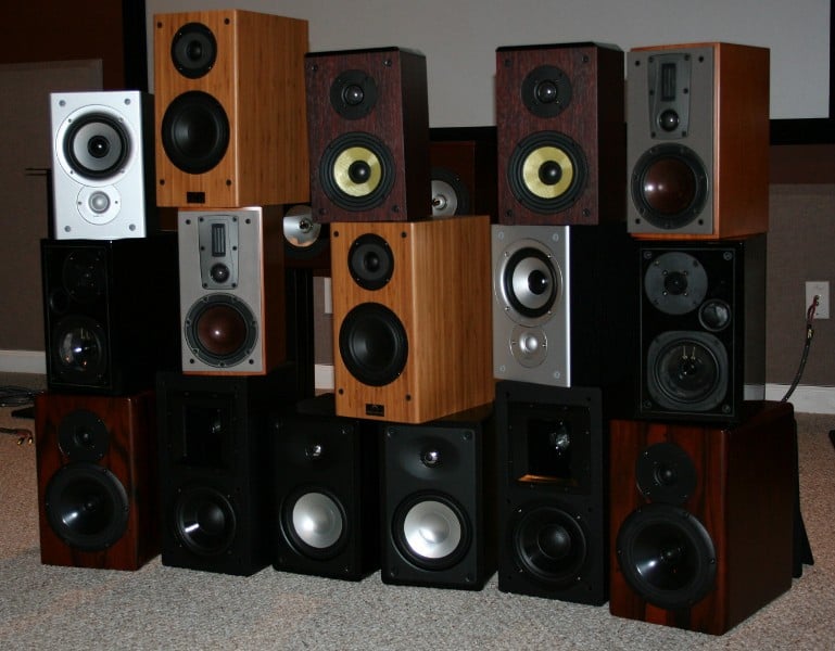

A single on-axis measurement response simply cannot give you enough information as to how a speaker will play in a real room. This is why a collection of measurements off-axis at various power levels help to complete the picture but they still won’t get you all the way there. Most frequency response and distortion measurements are done at very low power. They don’t tell you how a speaker will hold up when being driven at loud sustained output in a large room. Most distortion measurements are over-simplistic, low level sweeps vs. frequency. They won’t reveal bad design choices such as incorrectly chosen crossover points causing a tweeter to play lower in frequency than it should, which increases audible strain and distortion or even destroys the driver. These measurements typically won’t show increased intermodulation distortion as a result of running a midrange driver over a wider than optimal bandwidth. These sweeps are pretty, though, and they give comfort to the objectivist that helps them fall in love with smooth flat curves instead of the actual sound quality produced in their listening environment.
It is important to mention that you simply cannot measure each speaker in the same fashion. A simple two-way monopole that acoustically sums at 1 meter behaves much differently than an array of drivers that may not acoustically converge until 2-3 meters away from the front baffle. Thus, different measurement techniques must be used to get an accurate representation of how the speaker performs.
It is equally important to mention that we are not downplaying the importance of proper loudspeaker measurements and procedures. We simply use measurements to determine if there are any obvious flaws in the design. When appropriate we attempt to correlate our subjective impressions with our objective measurements. If for example we find a speaker sounds too bright in our listening tests and come to find a +10dB rise in frequency response above 10kHz, there is usually a good correlation between the listening and measurements.

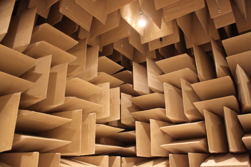

Anechoic
Chamber – the place where sound goes to die
An anechoic chamber is basically a room without echoes. It is designed to make the most accurate
measurements of a loudspeaker by removing the room acoustics from interfering
with the measurements. They are only
accurate down to the frequencies where the wedges stop being effective
absorbers, which in most chambers is usually around 100-150Hz.
Some manufacturers argue that a loudspeaker cannot be designed properly without the use of an anechoic chamber. This again is yet another fallacy. Any loudspeaker engineer worth their salt knows how to separate the room from the speaker when measuring through various measurement techniques. Modern electronic measurement systems allow for “gating” the measurements. Gating measurements removes early reflections, leaving essentially just the anechoic information. Because of this computer measurement capability and the abilities to measure outdoors, large and expensive physical anechoic chambers are far less necessary than they were a generation ago. Propping up the need for anechoic chambers does however sell a good story for a company that has made such an investment must automatically make speakers better than one that hasn’t. One has to ponder, is it cheaper to make the initial investment of say $50k on an anechoic chamber to give the perception that better designed loudspeakers would result, or to justify the cost savings over the long run of using inferior components because their “science” backs up their claim that “higher quality parts don’t make a difference”?
In defense of anechoic chambers, they do provide a means of accurately and consistently producing a set of measurements for a loudspeaker under test while also significantly reducing testing time. They are a great tool to use, but they aren't necessarily a requirement for accurately designing and evaluating loudspeaker performance.

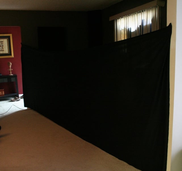

again because the insane logic still prevails on the forums. The objectivists argue the only way to
determine if Speaker XXX is better than Speaker YYY is by double blind testing
it because if the listener sees the speakers, their judgment will be unfairly
influenced by their visual or brand preference. This has actually become a religion for some people and their minds are quite settled on the notion that you simply cannot determine anything meaningful from a sighted test no matter how controlled the bias variable are.
The Double Blind Test (DBT) is a type of testing protocol typically used in the medical field as the means of determining the outcome of an experimental drug or procedure by eliminating biases. In a true DBT, neither the researcher nor the participants know which medication is being given in order to avoid preferentiality from either side. Examples of these biases, to mention a few: type of patient, type of condition or ailment, type of drug, type or packaging. The “products” to be tested have to not only look the same to the naked eye, but even “taste’ the same. The effect is what we are looking for by removing all conscious and subconscious biases.
Let’s examine this logic a bit further by assuming for the moment that its unanimously agreed Speaker XXX is prettier and more prestigious than Speaker YYY. The objectivists will decry you have to conduct a controlled DBT to avoid biases caused by visual preferences. What if we disconnect the tweeter of Speaker XXX so that all of the top end was removed from that speaker where only bass and vocals were playing. Are we expected to believe the listeners would still prefer Speaker XXX because it’s prettier during a sighted test?
If you put two top quality steaks in front of a food taster that hated Tabasco sauce where one was infused with Tabasco sauce while the other was lightly seasoned, do we really need a Double Blind Test (DBT) to determine their preference?
To those that consider DBT's a necessity in determining subjective consumer preferences even with devices whose primary purpose is to produce sound, I encourage them to engage in one when comparing performance sport cars on a test track :) Don't trust your eyes, rely on the force to guide you around the track!
The reality is DBT’s are critical for medical tests where one needs to study the effects of different drugs in a controlled environment. In my opinion, the importance of a applying a DBT protocol in a controlled listening test of loudspeakers is overstated, especially when the differences between stimuli are far greater than the perceived biases of appearances or brand prestige. When testing components with subtle sonic differences such as cables, or changing a component in a loudspeaker to determine if it produced a sonically detectable result, then a blind testing protocol makes sense. In these scenarios, the blind test is useful in reducing perceptual bias to more accurately determine minute detectable differences, but not necessarily to determine if those differences were preferred.
In most cases, nobody adheres to strict DBT protocol (where both the listeners and testers are unaware of what they are testing). Instead, they often at best set up a SBT (Single Blind Test) which have their own biases often not disclosed by the testing party. Despite my opinion on this topic, it's noteworthy to mention we still often engage in sighted and blind test shootouts of loudspeakers to study how the results differ as can be seen in our 2009 Floorstanding Loudspeaker Shootout.
