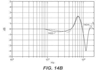

The Dolby analog crossover integrated into speakers with the Dolby Atmos certification on them is designed to mimic the HRTF to theoretically help trick your brain into thinking the sound is coming from an elevated position, despite the fact that the speakers are at about ear level. The graph below represents the shape of the filter response but it’s also important to note that there may also be some element of EQ processing that Dolby Atmos is doing in A/V receivers and processors to help bolster its effectiveness.
HRTF Frequency Response of Dolby Elevation Speaker Crossover

Dolby claims they are incorporating this frequency response change (per Fig 14B) into their up-firing elevation speakers to try to trick the brain into thinking the direct sound from the speaker is coming from above. As Dr. Toole pointed out, the reflection, which is actually coming from the ceiling, will already have the response change due to the shape of our ears. In agreement with Dr. Toole’s comments, employing a HRTF into the loudspeaker crossover appears to be an inaccurate and redundant way of accomplishing this, because:
A. It assumes the severely off-axis direct sound is linear at the listening position to start. Considering the upward firing driver is 70 degrees off axis with respect to the listener, the higher frequencies are already rolled off by a considerable margin. Perhaps a better solution would probably be to try to increase the directivity by using a larger than necessary driver or waveguide and roll off the lower frequencies that have spherical radiation. But this remains a topic of further discussion in a different article altogether.
B. The reflected and direct sound will arrive at different times which can add spaciousness but can also penalize clarity of sound.
C. The 7kHz and 12kHz response changes shifts to lower frequencies for overhead sounds less than 90 degrees.

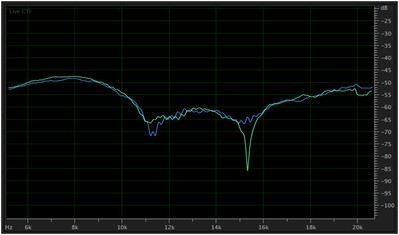

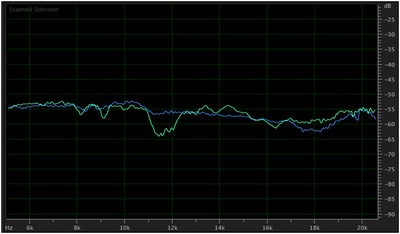

D. The 7kHz and 12kHz do not represent how all listeners hear overhead sounds. It is just an average best guess sort of thing. Depending on the shape of your ear, shoulders, etc., the response may look quite different. Shown below are two screen shots of the same location for two different listeners from the website above, you can see their HRTF’s vary quite a bit.
First Listener
Second Listener
As you can see, the first listener might have a better Atmos elevation experience than the second due to the missing peak at 7kHz for the second listener. These are just some of MANY reasons why up-firing reflective speakers generally cannot come close to discrete ceiling mounted speakers in terms of fidelity or accuracy of delivering height information, despite Dolby claiming otherwise on their website.

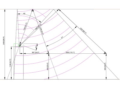

How is the Reflected Sound Perceived as Elevated Height?
It’s important to better understand how reflective speaker technology works independent of whether it has a HRTF implementation in the crossover or not.
Atmos Elevation Speaker Reflection Diagram
As you can see in the illustration above for a speaker firing up towards the ceiling with the axis 20 degrees off of vertical and an 8 foot ceiling, the axis of the reflected sound will be 35" in front of the speaker at seated ear height (35"). The path length for the reflected sound will be 116". The reflected sound will arrive 6ms after the direct sound, and due to distance will be attenuated 10dB (ref 1m). This is within the domain of the Precedence effect (Toole, Sound Reproduction: Loudspeakers and Rooms, Figure 6.16) which in normal situations would mean that we localize to the direct sound from the loudspeaker and the reflection is not perceived as a separate spatial event.
Dolby Atmos Diagram - Courtesy of Pioneer
However with the spectrum of directed and reflected sound being so vastly different, the Precedence effect breaks down and both the originating loudspeaker and the point of reflection may be heard as coexisting sound sources having different spectral balances. In the case of an Atmos reflective speaker, this helps the reflected sound at higher frequencies to be localized as a separate event. The fact that transients play an important role in localization in complex sound fields further explains why the bounce effect can work as well as it does.
However, as the listener moves further away from the speaker, he/she will move progressively off-axis to the reflected sound and on-axis to the direct sound, thus reducing its ability to be localized as a discrete elevated sound source. At a listening distance of 10 feet (3m) and an ear height of 35" the listener will be 27 degrees off axis for the reflected sound. The reflected sound will arrive 3.3ms later than the direct sound and will be attenuated 3dB by the distance ratio. As the listener moves closer to the reflective speaker, the Precedence effect dictates the direct sound being dominant making it more localized at the source of origin rather than an elevated event.
