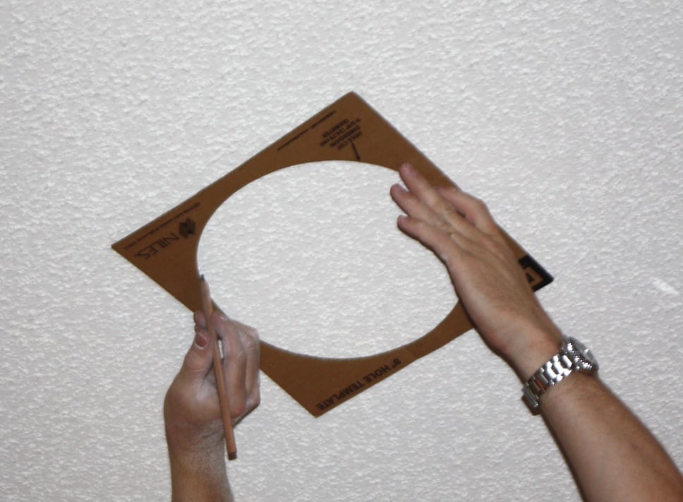

Since we had existing speakers in all of our rooms, all of our wiring was done and our installation was pretty simple. The Niles speakers were larger than those that we replaced, so the first step was to check in the attic and make sure that we had plenty of room between beams to enlarge the holes that had been cut.  Then it was back downstairs to our ladder, and we unscrewed and removed the existing speakers.  Using the cardboard patterns supplied by Niles, we traced the larger circle around the existing holes and used a hand drywall saw to make the cuts If you have a cordless one-handed reciprocating saw, this job can be much easier). Using an empty cardboard box positioned just under the hole helps to cut down on the dust and debris in your room, and makes cleanup very minimal.
marking diameter

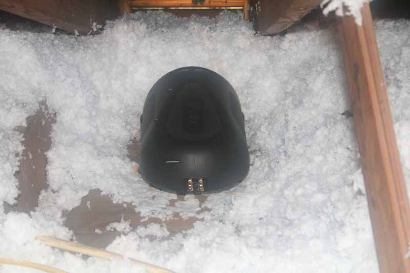

One thing that drew us to the ICS series was the built-in enclosure that ships with the speakers.  All Niles' ICS Ceiling Mount Loudspeakers feature a unique, integrated custom-tuned Rear Wave Control (RWC) enclosure.  Such an enclosure creates a controlled and predictable sound from the speaker, regardless of where it is installed.  In addition, it reduces significantly unwanted sound from bleeding into adjacent rooms via the open attic space.  While the shape is unusual, looking a bit like the head of the creature from Alien, it is designed for ease of installation. It fits easily through the round hole that has been cut in the ceiling for installation.  This makes it a great solution, not only for new construction, but also for retrofit applications such as ours.
attic view ceiling speaker
A peek from above at an in-ceiling installation

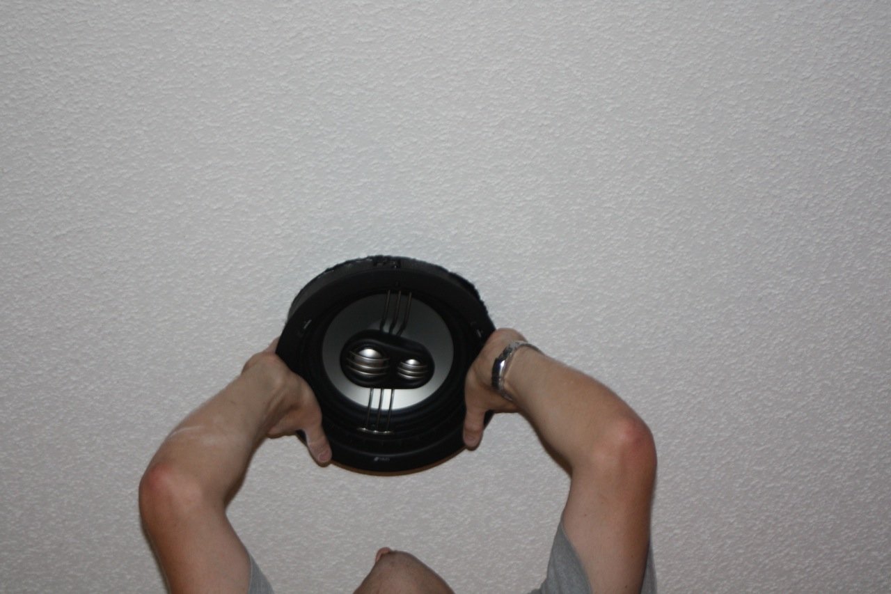

Niles' build-quality is really on display here - these are quality speakers with fittings to match.  They ship with your choice of round or square ultra low-profile grills with a thin bezel.  The grills attach via powerful magnets, making installation simple. This simplicity is important in a home such as ours with 14 foot ceilings where you are teetering on a 10 - 12 foot ladder during the installation. There is additional flexibility with Niles' patent-pending spring-loaded mounting clamps, which accommodate a variety of mounting applications.
The ICS Ceiling Mount series speakers we installed all features Niles' patented and award-winning Directed Soundfield pivoting woofer and tweeter technologies.  This enables the woofer and tweeter to be pivoted independently up to 15 degrees in any direction. This is helpful when you have an aesthetic or installation issue which requires you to mount the speaker in a less-than-desirable location - the pivoting speaker can be adjusted to direct the loudspeaker sound into the optimum listening area.  The ICS speakers are designed with premium components including copper caps, high-level crossovers, and Kapton voice coil formers.
Installation was very simple, especially since we already had holes and wiring in place.  One thing worth mentioning is that these speakers are really BIG.  They are large, beefy drivers with the alien enclosures on them, and can be a tad cumbersome to handle as you climb a ladder and try to attach the speaker wire via the spring-loaded clamps.  Doing this one-handed while standing on the top of a 10 foot ladder proved to be quite a delicate, if not outright dangerous exercise - so grab a friend to help out.  Coincidentally, it is possible to remove the RWC enclosure if your application does not have space to accommodate it.  This is an excellent benefit that just adds to the flexibility of the speakers.

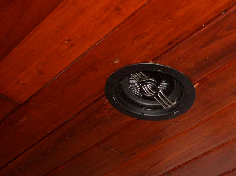

wood ceiling speakerThis room is separate from our main home and has 8-foot ceilings. This represented a situation where we wanted to use the 7" Niles in-ceiling speakers to deliver Surround and Surround Back audio to a wide seating area. The room is decently sized, around 25 x 22, and we had already configured the front soundstage with a really nice set of RBH Sound Signature Series 61-SE/R Reference speakers. The surrounds, however, really required some thought due to the block wall construction and difficulty of getting wiring to anything other than an attic-access point. An in-ceiling solution just made a lot of sense and we were able to cut in and mount these speakers quite easily through the 3/4-inch tongue-and-groove pine ceiling.
What we liked about the RWC7.5's was the ability and flexibility we had to point both the woofer and tweeters. While we don't recommend drastic changes here, it was possible to create a more diffuse surround field by directing the speakers slightly over the seated area. The sound from these speakers was clean and clear and was absolutely perfect for this application. We don't typically advocate in-ceiling speakers for your mains, but for surrounds and the surround back channels it was absolutely the right move and a great sound solution for the room.

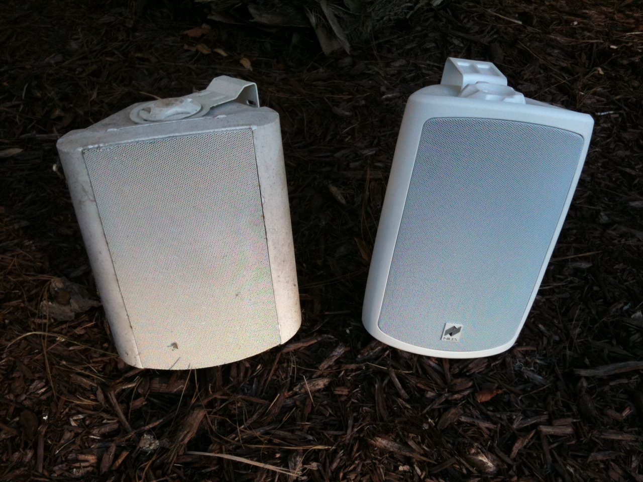

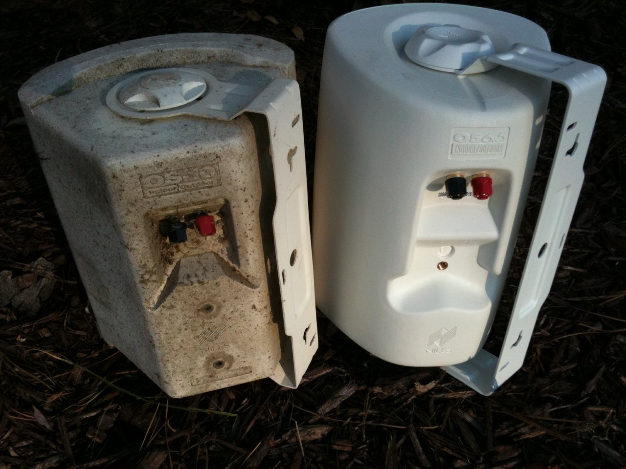

Don't you think that your outdoor speakers should exceed military anti-corrosion specifications?  Niles does too.  And that is just one of the things that makes the OS 6.5 Indoor/Outdoor speakers great.  I have a pair of these speakers that are probably at least 15 years old, and after living outdoors through the changing seasons in Nashville and now in the salty air of coastal South Carolina, it was time to replace them.  When I told Niles about this, they were excited to replace them with a pair of the OS 6.5's.
fronts rear outdoor
These speakers, simply put, ROCK. They have solid, booming bass and excellent highs.  They are a rock and roll speaker, perfect for your back porch, garage, or even for use indoors.  They feature an Integrated woofer/baffle assembly that increases the 6" cone area (adding to the bass output) as well as a fluid-cooled 1" tri-laminate teteron dome tweeter with ultra-wide dispersion.  The woofer is a 6" interlaced carbon fiber design that is rigid, producing lower distortion and reduced breakup. And did I mention these are water and weatherproof?    Designed to withstand both frigid and hot conditions, they are equally at home in arctic conditions as they are in the humid tropics.
I have mounted these speakers both on my back porch, and also in my garage.  I must admit that in these locations, they most frequently have classic rock such as Boston or Tom Petty cranking through them at pretty high levels. These speakers sound twice their size, with serious volume output. They are very efficient and easy to drive with either the SONOS digital amp or using available 30-watt channels from the Niles SI-1230 multi-channel power amplifier. The biggest problem I am having with them right now is deciding whether to keep them in the garage or out on the back porch!
Niles' line of indoor/outdoor speakers is a no-brainer when trying to decide what to use in weather-sensitive environments. They have a wide range of sizes and styles available, and all will give you years of excellent performance. Take a look at the side-by-side of my old speakers versus the new ones. These things are built tough and sound great.  I can highly recommend them for your home or workplace.
