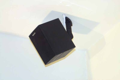

We
pointed the surround speakers together rather than towards the middle of the
room to create a more diffuse surround soundfield.
You can
barely see the hole where the speaker wire emerges from the ceiling. Much less
intrusive than a fully exposed speaker binding post wall plate.
