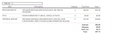

When my speakers arrived back, they also included an itemized list of services performed in the bill of receipt.
So for under $90, I got my pair of vintage JBL speakers fully restored to factory brand new condition, perhaps a little bit better. They definitely looked much cleaner and newer thanks to the courtesy cleaning of the cabinets they performed prior to shipping them back to me. Before I brought my speakers to Simply Speakers for restoration, I pulled a nearfield measurement. I wanted to compare the before and after response which is illustrated below.
