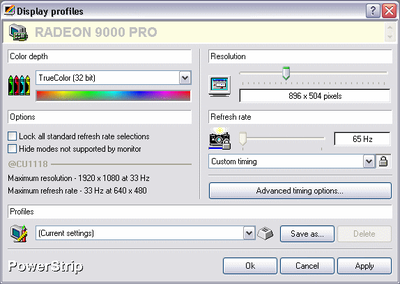

"Click" the Little Powerstrip icon.
Select "Options..." -> "Preferences..."
The following screen will appear...

First try a default Display Profile:
Click the Powerstrip tray icon and select "Display Profiles" -> "Configure".

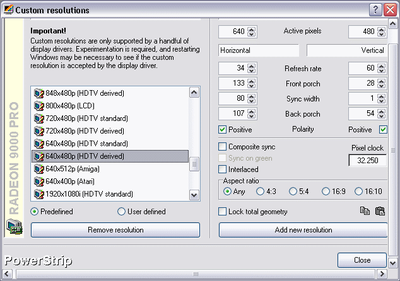

Select the "Advanced timing options" button.
Select the "Custom Resolutions" button.
With the resolutions set to "Predefined" (default) rather than "User defined" Select
640x480p, or another resolution that is compatible with your HDTV.
Check to make sure everything looks ok. For instance, if using the Key
Digital KD-VTCA2 Transcoder, make sure the sync Polarity is set the same in
Powerstrip as it is set on the Dip Switch on the Transcoder.

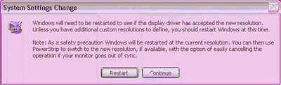

Click the "Add new Resolution" button.
the following screen usually appears the first
time you use a custom resolution.
You
can either click "restart" now or continue and add
more resolutions by clicking the "continue" button.
When finished adding resolutions you want to try
using, click "Restart". Remember not to get too ambitious
with resolutions at first.
Your computer will start up again into the original resolution you were using,
not the newly added resolutions, so don't get ready to panic yet. Wait until
later.

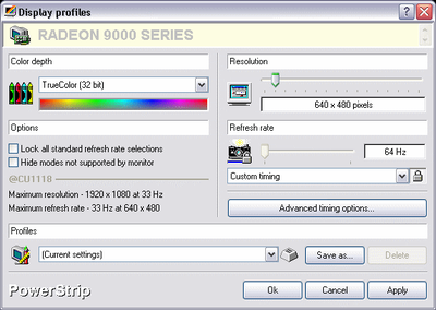

Use the "Resolution" Slider to find your Resolution. In this case it
should be "640x480 pixels", or the resolution you are trying to use.

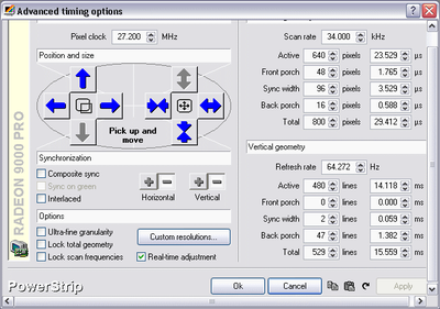

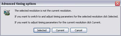

To see if your display accepts the resolution, click the "Advanced Timing options" button.
You will get the following popup window...
Click the "Selected" button to choose your newly set resolution.

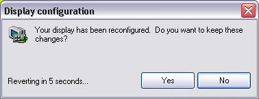

If you get an unusable display, wait 15 seconds or hit the <Esc> key and you should go back to your regular settings.
If you can view the display, you should get the following popup window...
The
time should count down from 15 seconds and reset your display back to
normal if you don't click the "Yes" button. If you're able to see
things somewhat properly, ready to start adjusting things, click "Yes".

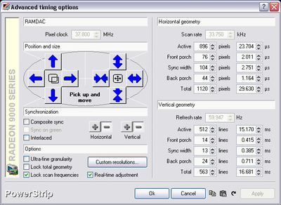

Note: If the display is not centered, too tall or too narrow, you will need to tweak things, so you'll need to click "Yes" to do that. Don't expect things to be perfect, just "useable".
You should get the following screen...
Notice above how the Horizontal and Vertical "+" and "-" buttons are depressed or not depressed. The above setting is for negative sync.
Note: You should usually not change the sync settings using your HDTV, use the CRT for that.

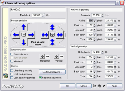

Custom Resolutions
We are now going to create a new Display Profile. We will be using
1080i/540p based timings to match our RPTV HDTV display which does not
support 720p.
[note] If your display supports 720p (you're sure?) we highly recommend
you use 720p (around 45 kHz Horizontal)... Make very sure your set
REALLY supports 720p, some will convert 720p to 480p or 1080i, in which
case it will not accept the necessary Horizontal scan rate and won't
work!
Scan rates
480p and 960i should use a Horizontal Scan Rate of 31.5 KHz.
540p and 1080i should use a Horizontal Scan Rate of 33.75 KHz.
720p and 1440i should use a Horizontal Scan Rate of 45.0 KHz.
Fudging these numbers a bit is possible to a small degree, depending on the display.

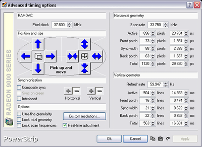

Change the resolution button to "User defined" rather than the "Predefined" (default).
Note: Your horizontal resolution for most video cards should be divisible by 8. Good resolutions to use are therefore 848, 856, 864, 872, 880, etc. For those mathematically challenged, 8x112=896. Keep multiplying 8 times some other number to find resolutions to try. For a 16:9 display, with an 896 horizontal resolution, you would take 896, multiply by 9 and then divide by 16. You get 504.
["horizontal-resolution" x 9 / 16 = "vertical-resolution"]
Use the same technique for 4:3 displays. You will probably want to shoot for smaller horizontal resolutions than a widescreen display.
["horizontal-resolution" x 3 / 4 = "vertical-resolution"]
We will use 896 for Horizontal and 504 for vertical resolutions.
Set the Horizontal refresh rate to 34 Hz.
Make sure "Polarity" settings are the same as what you found to work previously.
Keeping the "Aspect Ratio" on "Auto" is usually a good idea, but you can change this if you need to.
Click the "Add New Resolution" button and you should again get this screen...
You can either click "restart" now or continue and add more resolutions by clicking the "continue" button. When finished adding resolutions you may want to try, click "Restart".
After restarting
Change to the new resolution, in this case "896x504".
Click the "Advanced timings options.." button.
Note: If you now have a problem with the display, again, DO Nothing for fifteen seconds and the display should change back to the previous settings and start working again.
If not, try these key combinations:
"backspace" key - undo, cancels last adjustment.
"ALT-R" key combination - resets display , continue.
"escape" key - reset and close display.

Setting the proper scan rates - Important!
Set the Horizontal scan rate to 33.75 and hit your "Tab" key (540p/1080i).
Set the "Total lines" in the "Vertical geometry" section to "563"(540p/1080i)
Note: Set this for 525 for 480p/960i. See below...
Why? See this excellent guide at Keohi HDTV: http://www.keohi.com/keohihdtv/experttips/markrehjon/htpc_superguide.html
Will other totals work? Sure, depending on the display. Notice how above, the
Horizontal scan rate is 33.75 and the vertical scan rate is 59.94? This is
ideal for "standard" HDTV 540p/1080i. Use settings as close as possible to
these for 540p/1080i! Reread the above guide if you have questions.
[note] Don't save this setting until you verify you can "get to" the taskbar!
Make enough vertical (up/down) adjustments until you can see enough of it to
get back into Powerstrip, etc.
Tip: It is probably a very good idea to check the "Lock scan frequencies" checkbox at this point. This will keep your Horizontal scan rate locked at 33.750 kHz and your Vertical scan rate locked at 59.94kHz. See below...
Each
time you save your settings and go back into the
adjustment
screen you will need to "recheck" the "Lock scan frequencies" button.
