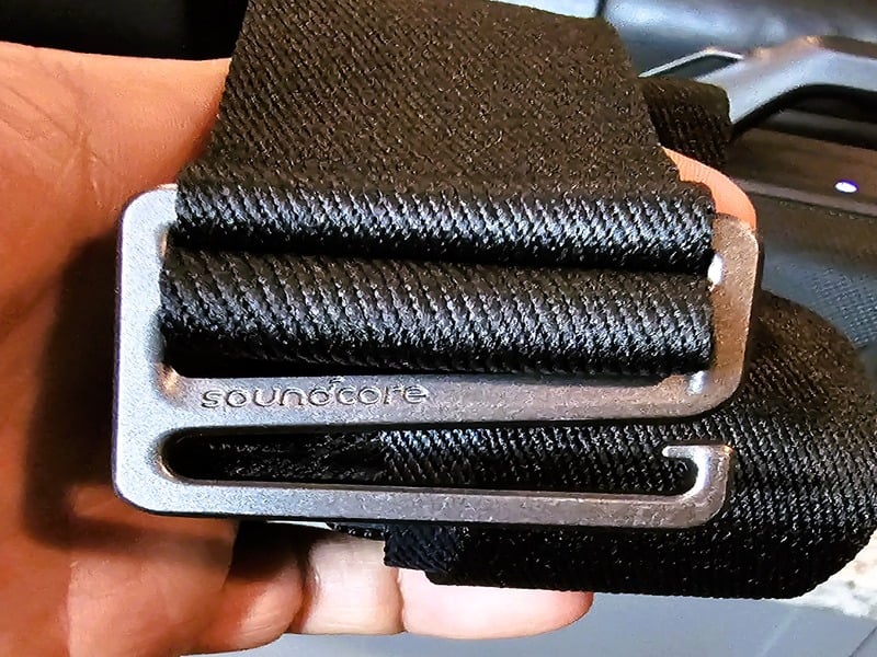

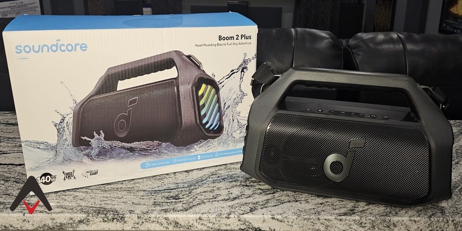

The unboxing experience of the Soundcore Boom 2 Plus is a treat. The unit comes packaged in a colorful carton that highlights the product's features, setting the stage for what's to come. Inside, the unit is protected by 2 thick, high-quality cell foam pieces, ensuring the product's safety during transit. A .5M USB C-to-USB C cable and a nice quality nylon woven shoulder strap are neatly nested in the cell foam, ready for use.
Strap_Crop 800_600
The products are wrapped in moisture-resistant plastic bags, a thoughtful touch to protect the products in transit. They have taken extra steps to ensure you get a solid product from the warehouse to the door. When you grab the large handle and pull the unit from the package, you will immediately notice the speaker's weight. Tipping the scale at 8.38 lbs, it outweighs the Motion Boom Plus by just over 3 lbs. Beefier drivers and a built-in 10W fast-charging power bank probably have something to do with the extra weight. Anker does not supply a USB charger with the Boom 2 Plus; it must be purchased separately. However, you may use any standard smartphone charger to charge the unit, making it convenient to use.
Soundcore Boom 2 Plus First Impressions

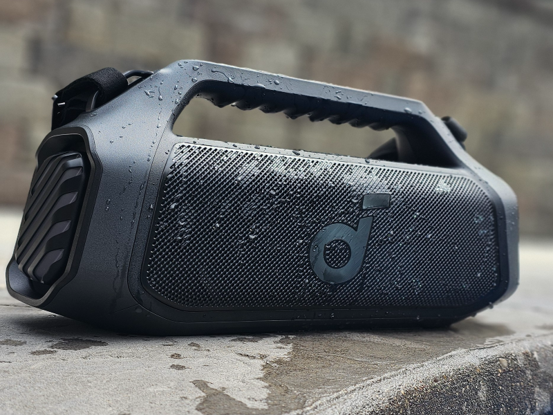

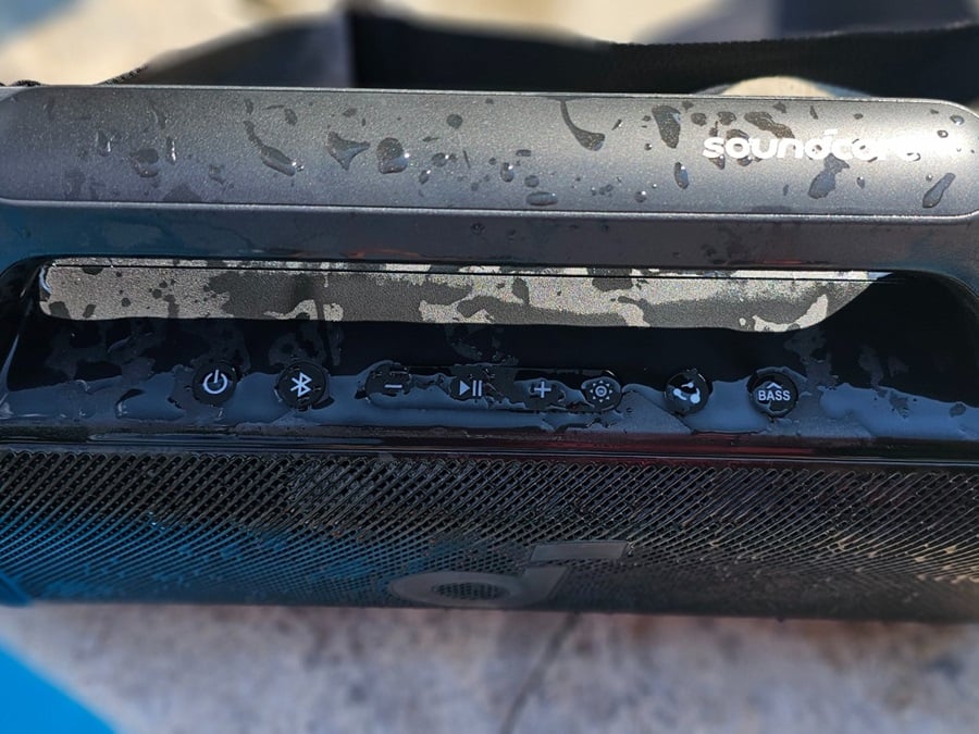

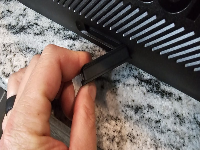

Once taken out of the protective wrappers, the Boom 2 Plus has a nice feel. The carrying handle is very comfortable, and the build materials seem high quality. A metal grill with the Soundcore logo is on the front of the speaker, and a large “Soundcore” spelled-out logo is on the back plastic casing. The power and function buttons seem very well sealed and have a nice tactile feel. On the bottom rear of the speaker is a large silicone plug that covers the charging port for the speaker and external devices, as well as the 3.5mm Aux port. This plug, a crucial part of the speaker's water resistance feature, will have to be in place for the water protection of the speaker. Failure to put this in before dropping into a body of water could mean trouble. It does seem to seal very well when pushed all the way in, so you should feel secure about using this unit in various wet environments (it is IPX7-rated, after all).

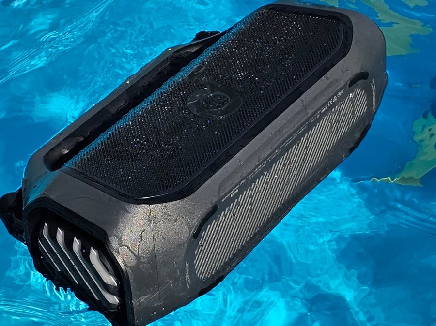

As advertised, the speaker can get VERY WET! Testing around the pool over Memorial Day weekend, we used this speaker exclusively for our pool party, and we sat the speaker on the edge of the pool so we could hear the tunes and see the lights while swimming late into the evening. The speaker got heavily splashed from several unexpected “Cannonball” jumps and kept pumping out music. Soundcore advertises that this speaker can float; Audioholics put this claim to the test in our saltwater pool and found that the unit can, in fact, float and will continue to play tunes if briefly submerged for a quick second when being thrown in the water.
Buttons Wet
Editorial Note: If the speaker does get placed into the water, shake as much water out of it as possible and let it drip dry either on a towel or some water-resistant surface, as water will continue to come out of the unit until it is empty. The unit continued to work very well after all the submersion and water playtime testing, even after drying out.

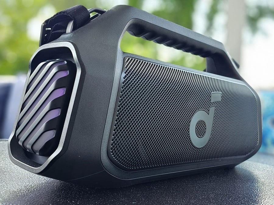

The light show on the end of the speakers inside the passive radiators was quite entertaining for young and old alike. The lights can flash to the beat of the music and be controlled by the Soundcore app so that you can set the vibe for any occasion. You can also opt to turn the lights off via the app to conserve battery life, as the lights affect how long the battery lasts. Soundcore says with lights off and 50% volume you can get 20 hours of playtime on a single charge. With our testing, playing tunes loudly with the light show going non-stop, we got around half that time (10 hours or so).
