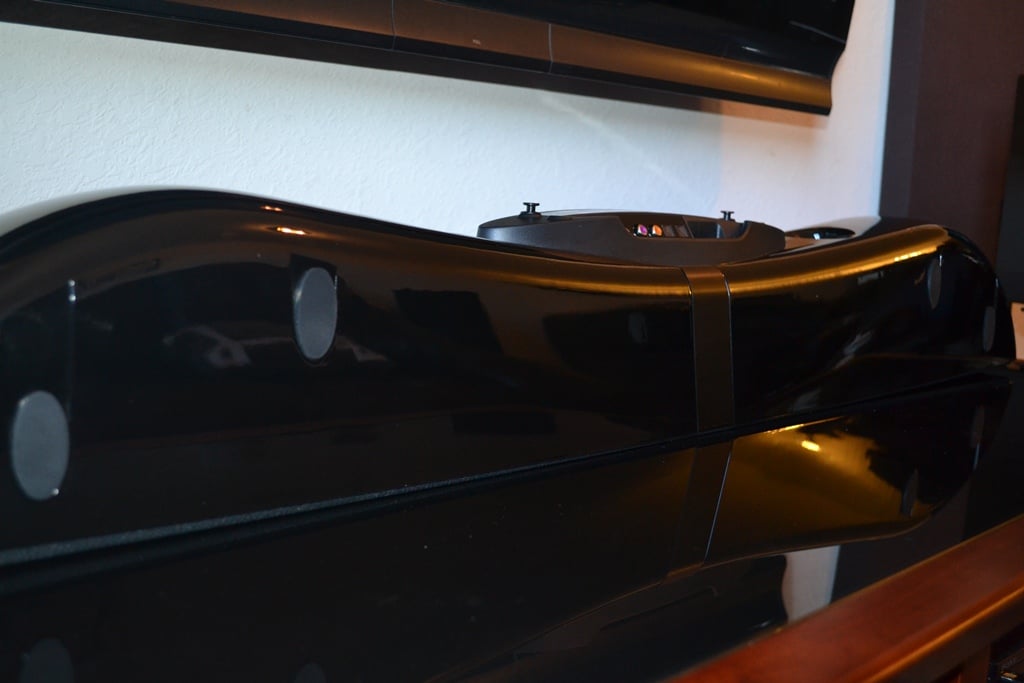

The first thing you will notice when you take a look at the Vision is that it’s a serious piece of equipment. Most soundbars feel like a toy when you pick them up: thin, light, and made of cheap plastic. The Vision weighs a respectable 20.5 lbs and is 5” H x 40” W x 5.9” D. At nearly 6” deep, the Vision is much thicker than most soundbars, which are designed to be mounted as close to the wall as possible and hand off all bass reproduction to a subwoofer. The added depth means that the Vision might stick out from a wall a little farther than some alternatives, but it also allows MartinLogan to squeeze out some extra bass from the cabinet. With a -3dB point of 43Hz, the Vision can definitely benefit from a subwoofer (more on that later). Even so, I ran it without a subwoofer for almost all of my listening tests and was pretty impressed. Additionally, most subwoofers that come with soundbars, or cheap home theater systems, can only play down to about 40Hz anyway. For people who want to get slapped around by bass, the Vision has a sub pre-out and works wirelessly with the company's Dynamo 1000w and 700w subwoofers. We are a big fan of the ability to hook up an external sub, as this allows greater flexibility so you can buy a subwoofer solution that fits your needs.

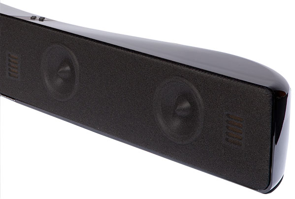

The Vision sports three 1” x 1.4” Folded Motion Tweeters and four 4” fiber cones. The arrangement of the drivers is T-M—M-T-M—M-T, with the outside tweeters on the far edges of the soundbar. This arrangement allows for a true left-center-right soundstage without the need for DSP. The Folded Motion Tweeters utilized in the Vision are the exact same that are used in the other Motion Series speakers, including the flagship Motion 40 towers ($949.95/ea) and the Motion 15 bookshelf speakers ($799.95/pr). I liked the Folded Motion Tweeter in my review of the Motion 15’s, so I was pretty jazzed to find out that the Vision had three of them. Each of the seven drivers has an independent digital amplifier, which combined can produce 100 watts (200 watts peak). Wattage ratings without information about a driver’s sensitivity don’t do much good, so let me say this: the Vision plays plenty loud with very little compression or distortion.

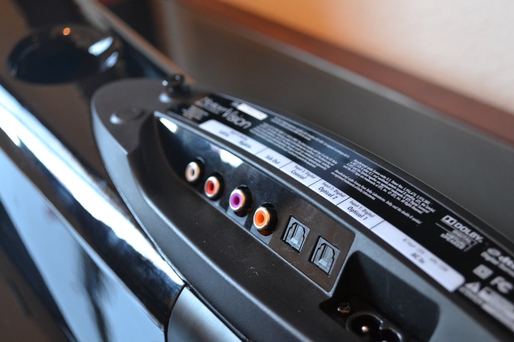

The back of the enclosure has two ports for added bass response. On the back panel are also 2 optical, 1 digital coax, and 1 stereo audio input, as well as an AC jack and 1 subwoofer output. It would have been nice to have HDMI inputs and outputs, allowing the Vision to receive and decode Dolby TrueHD and DTS-HD signals. Sans any HDMI inputs, your best option is optical or digital coax, so the soundbar can decode surround signals. The easiest way to do this is to run all of your sources directly to the TV and take a single optical cable out of your TV into the soundbar. Unfortunately, many TVs will not pass Dolby Digital or DTS through an optical cable (a fact that MartinLogan points out in the manual). Therefore, we recommend connecting any surround compatible sources directly to the soundbar. When the Vision receives an actual surround signal, it uses Dolby Virtual Speaker technology in order to simulate a 5.1 sound system.
Inputs on back of MartinLogan Vision soundbar

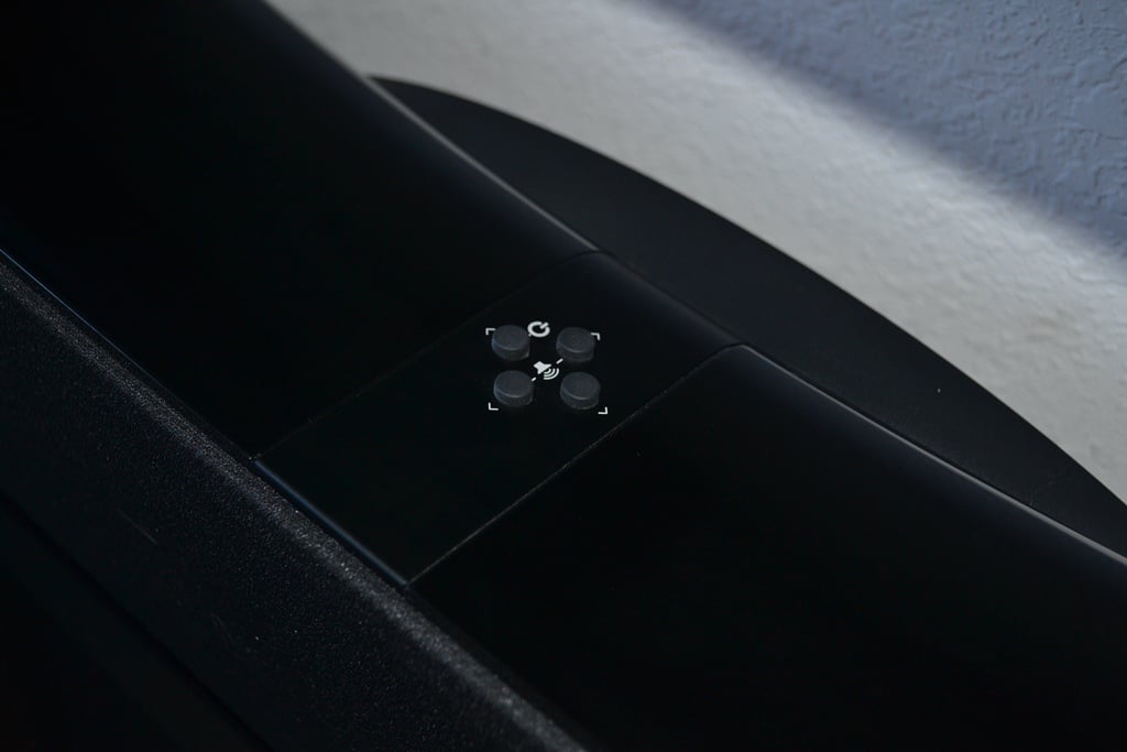

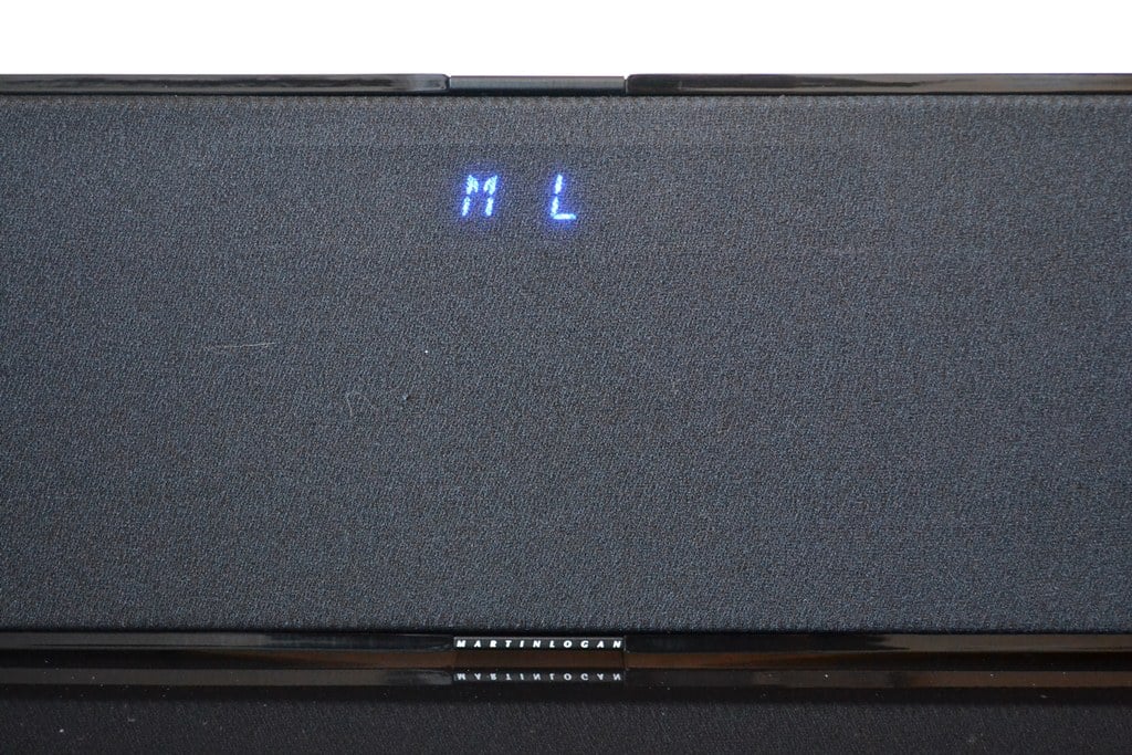

With a single line LED display, small credit card sized remote, and only 5 buttons on the soundbar itself, operation could have been a nightmare. It was, however, quite pleasant. On the top of the Vision are 4 multipurpose directional buttons that control navigation: volume (up and down), source (left and right), power (hold down left), and menu (hold down left and right). The remote also features power, mute, volume, source, navigation, and three mode buttons (night, normal, bass+). At first, the navigation was a bit confusing, but after I figured out the structure (thanks to an exceptionally well written manual), changing settings was a breeze.
Within the menu there are a number of sound related options. Bass can be adjusted +/- 10dB, simulated surround effects turned on/off, stereo mode changed between normal or voice EQs, sub output enabled or disabled, and installation switched between on-wall or on-shelf. I played around with every combination of settings I could think of during our measurements and listening tests and found that the sound can change drastically with each adjustment. For example, changing the stereo mode from voice + to normal makes a very audible difference, adding more treble to the mix. So, if you have a chance to hear the Vision and aren’t happy with the sound, peruse the settings and you will probably be able to customize it to your liking.
Control Buttons on Top of MartinLogan Vision soundbar
There are also a number of operational settings buried in the menu, such as display (bright, dim, auto, auto bright, audio dim), power (auto, full on), learn (learning commands from another remote), source name (rename sources) and reset. Although the included remote works well enough, credit card sized remotes are easy to lose, and this one lacked any backlight. Consequently, I just programmed the soundbar to work off of my Oppo remote. Learning commands was a breeze—much easier than with most soundbars I've used in the past. The only operational issue I had was the system not always turning on automatically, but that may have been because I was constantly changing settings, and powering on/off by hand and by remote.

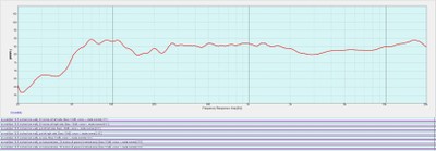

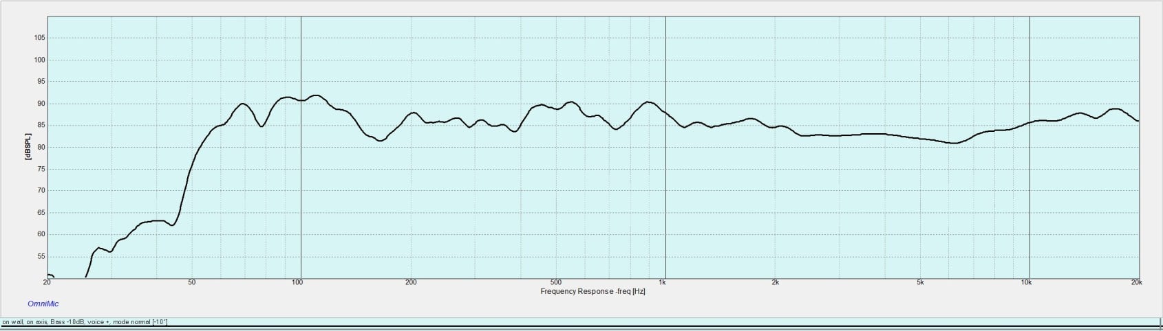

All measurements were taken in-room at 2m away from the Vision, utilizing an OmniMic measurement system. 1/12th octave smoothing was employed and a 5ms blended response to help remove room interaction from bass frequencies.
MartinLogan Vision In-room 2 meter SPL vs Frequency Response (1/12th octave smoothing)
I moved the Vision around (from right against the wall to 11” inches off the wall), changed the installation option between on-wall and on-shelf, and adjusted the bass trim until I was able to achieve the above graph. It is the flattest response I was able to get from the Vision. This measurement is taken with the Vision set to on-wall mode, -10dB bass level, voice + stereo sound, and normal mode. By dialing in each of the aforementioned settings properly, I was able to achieve a reasonably flat response. The -3dB point is about 53Hz, which is 10Hz higher than MartinLogan’s stated frequency response. It is possible that at a lower volume level, with the bass setting at 0dB, or by taking advantage of boundary gain, that a -3dB point at 43Hz is accurate, but my measurements suggest usable bass drops off around 50Hz. There is a slight boost in the midrange between 400Hz and 1KHz, which may have contributed to vocals and dialogue sounding so strong. And a steady rise over 10KHz up to 18KHz, something I also measured in my review of the Motion 15 speakers, which could explain why I thought the sound was a slightly bright (but never harsh) in voice + mode.

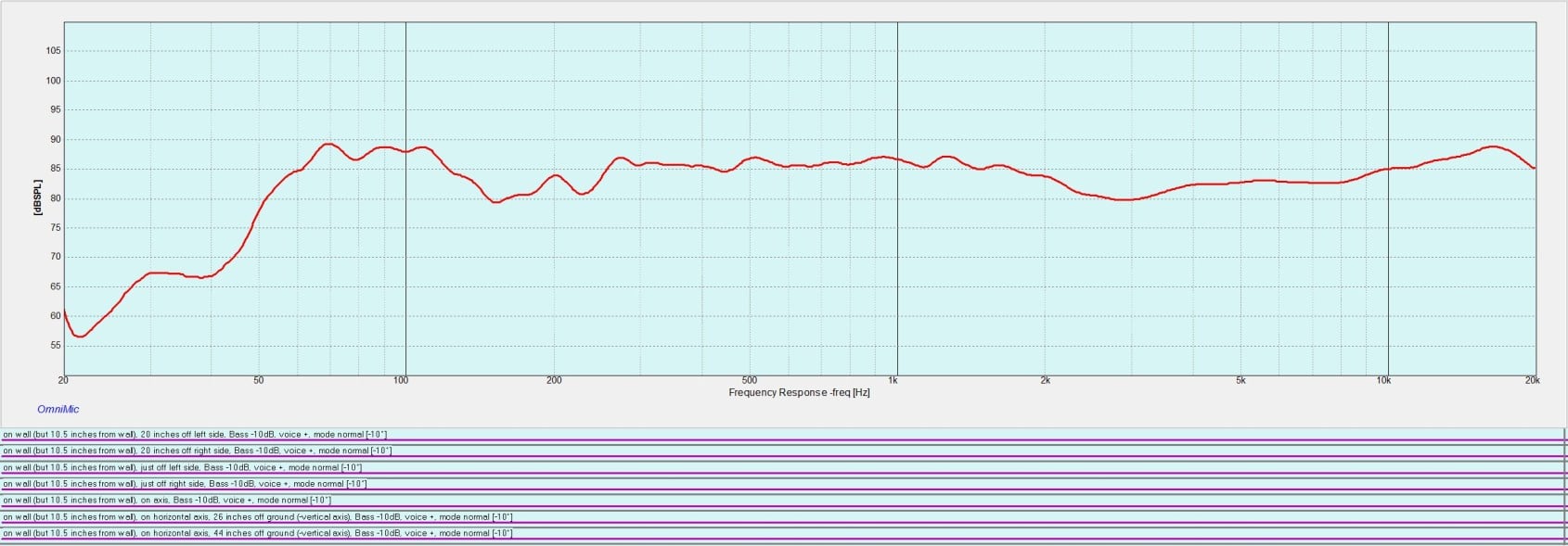

MartinLogan Vision In-room 2 meter Listening Window Response
I took a total of 7 measurements (on-axis +-15 deg & +-30 deg horizontal and +-15 deg vertical) and averaged the response for an overall impression of what listeners will hear. By averaging the responses this chart makes the final plot more linear than each of the individual 7 measurements would be. Still, you can notice a dip around 3KHz, followed by a steady rise until about 18Khz. By disabling “Voice +” mode, the steady rise up to 18Khz goes away and is actually replaced with a dip (not shown).

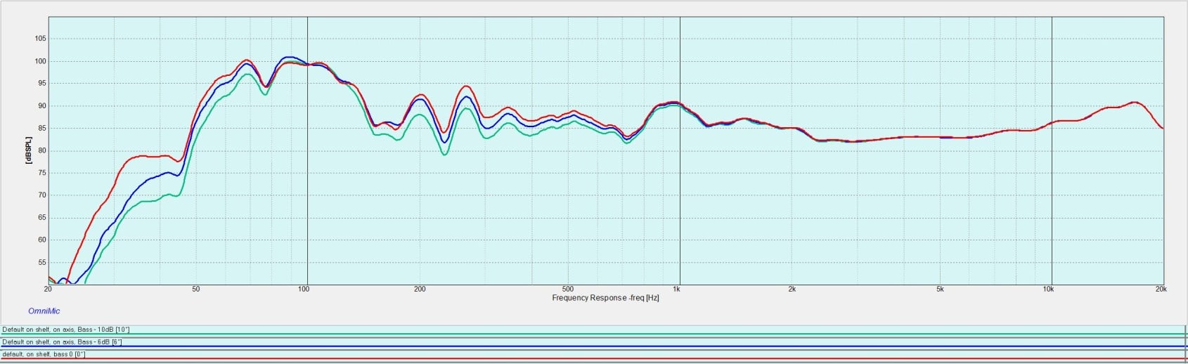

MartinLogan Vision
In-room 2 meter SPL vs Frequency Response (1/12th octave smoothed)
Red trace: bass -0dB;
blue trace: bass -6dB; green trace: bass -10dB
The graph above shows three different measurements taken from the exact same location, but with the bass setting on the Vision set to 0dB, -6dB, and -10dB. The actual frequency response is not the important part of this comparison (by switching from “On Shelf” installation to “On Wall” installation I could have attenuated the large bass bump), but rather the difference between the three plots. This shows that by adjusting the bass setting on the Vision, you are actually decreasing output below about 1Khz, which is much higher than I expected. It’s also notable that the decrease in bass isn’t consistent or as large as one would expect.
Throughout taking these measurements I discovered that the Vision can achieve a pretty flat frequency response, but that each setting in the menu system can have dramatic effects on overall sound quality and frequency response. I would advise anyone who purchases a Vision to spend a significant amount of time experimenting with the settings until it sounds best. This is especially true for the bass and installation options.

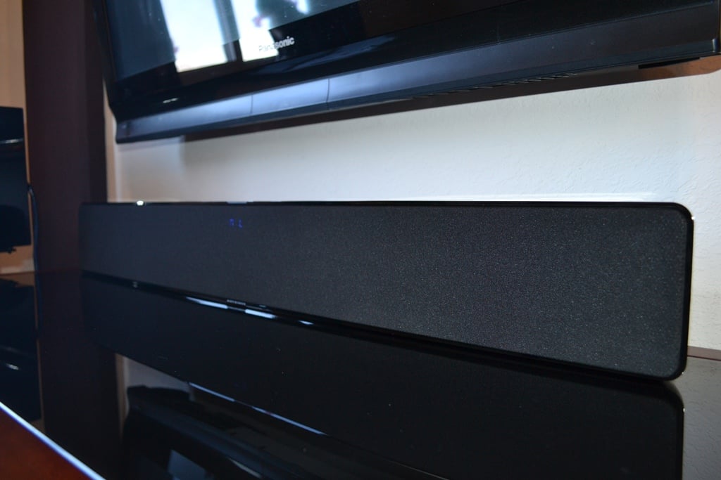

MartinLogan Vision Front Panel Close-up; Bottom Profile Shot
In my opinion, the Vision is a superb soundbar that gets many things right. It can go loud, sounds great, looks modern, and has a surprising amount of bass. It really shines when listening to music, but is no slacker when watching movies either. Still, I kept coming back to its musicality, which was far beyond any other soundbar I have heard. Some other soundbars can produce better surround effects (by "some", I actually just mean Yamaha), but the Vision can surprise you with convincing surround effects from time to time. If you are looking for a soundbar that can turn your non-believer friends into cult-like fanatics about soundbars, the Vision might be your answer. You no longer have to choose between great sound with a dedicated 2.1 system or great looks with a soundbar, the MartinLogan Motion Vision gives you the best of both worlds.
