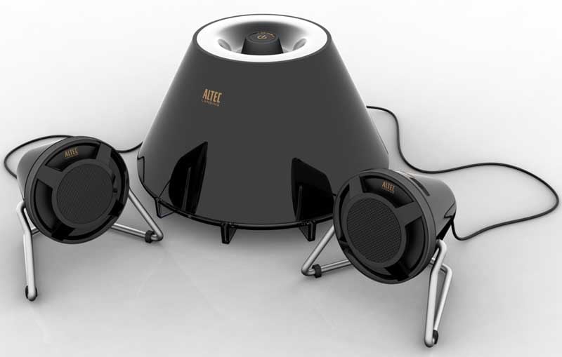

This 2.1 systems comes with a 5.25" subwoofer, whose diminutive size still allowed it to push quite a bit of audio and create a well-rounded sound that was, overall, very pleasing to both the eyes and ears. I was particularly fond of the shape of the subwoofer in relation to the satellite speakers. The small satellites, with their 2" "full range" drivers look like smaller versions of the sub turned on its side. It's a great concept and I had to admit the system looked really good as a package – something I do not say about most multimedia systems. It's evident form the get-go that the design was carefully thought-out and much time was taken to get at least the physical parameters of the design figured out.

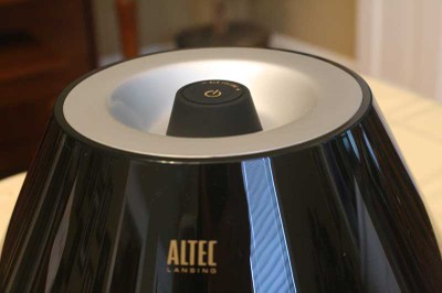

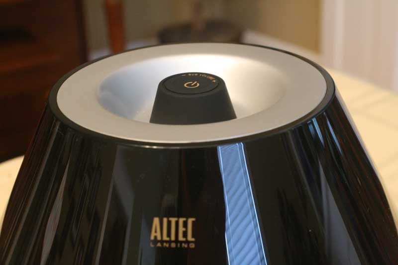

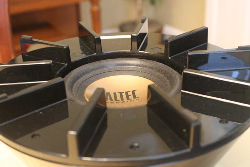

sub bottomStarting again with the sub, we liked how it's 5.25" driver was down-firing, but after tapping it with our finger we quickly determined that the resulting resonant frequency would indicate a rather limited low frequency extension from this device. Given its size and design limitations that wasn't exactly unexpected.   Flipping the subwoofer upside down we noted the beautiful acrylic fins which served as the feet on which the subwoofer stood, allowing the air below to escape as needed. Unlike the photo depicted on the Altec Lansing website, our sample had black acrylic fins to match the enclosure color, not clear acrylic. As they are on the bottom of the sub – and many will find it better to place the sub on the floor, I don't think this is a major concern. The top of the sub has a large power button that can be rotated to control subwoofer volume. I found it to be easy to use and it was a very practical solution that was much better than a small volume dial at the bottom of the sub (something we've seen – and lamented - on competitive products).

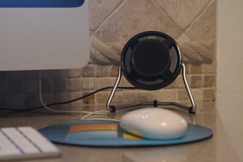

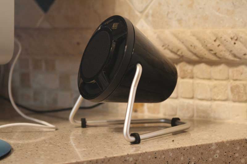

satellite sideThe satellite speakers are well-made, with stainless steel legs that allow for the conical speakers to be aimed up at the listening position. Three plastic feet are affixed to the metal legs in order to protect delicate surfaces and keep the speakers from moving about too much. The left speaker also contains a volume control, which we found a tad difficult to use without causing the speaker to move or having to grab the face of the speaker with our whole hand. The speakers are hard-wired to each other and back to the subwoofer. They allow for a reasonable amount of distance between the speakers and we found that placing them was easy and offered us a lot of flexibility, especially when we moved the subwoofer to beneath our desk area.
