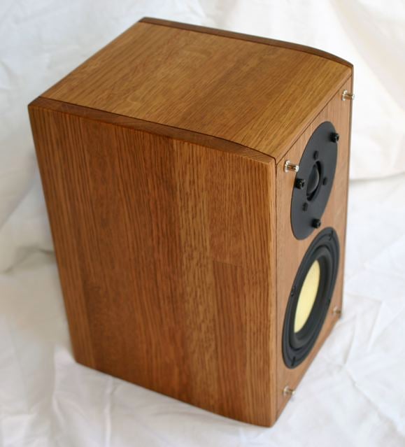

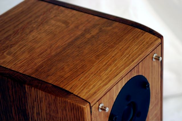

IMG_9225I was really surprised at how small the speakers were when they arrived.  I had not looked at the specs, and figured they would be a medium sized bookshelf.  But they are actually quite small, with the cabinets measuring roughly 6"(w) x 10"(h) x 8"(d).  But from the moment I removed them from their boxes I was smitten.  They are gorgeous to look at, and extremely well made.  I love hand-crafted products, and these are easily described as small works of art.  The finish is well sanded, smooth and full of the character of the barrels.  Although the pair is matched, each speaker has its own unique look due to all of the staves of wood that have been pieced together to create the cabinet.  Pioneer says that it takes an entire whiskey barrel to produce each pair of Pure Malts.

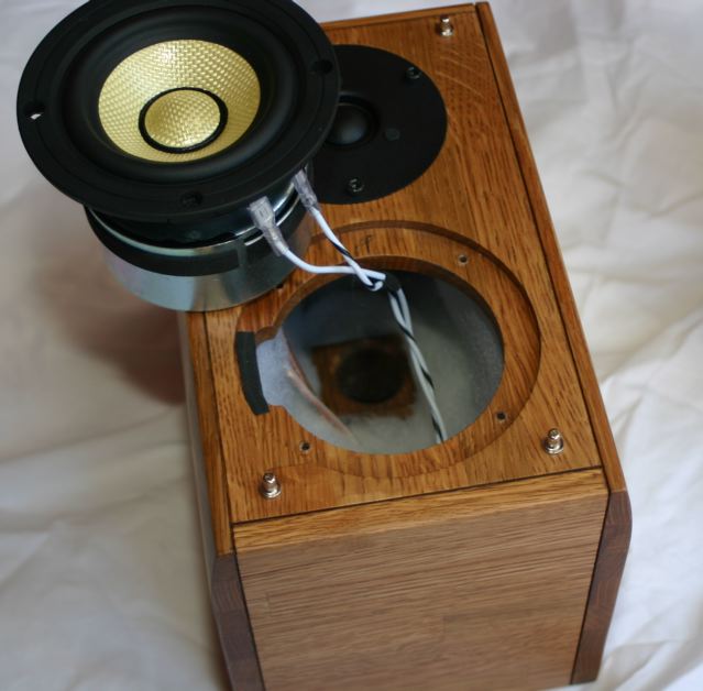

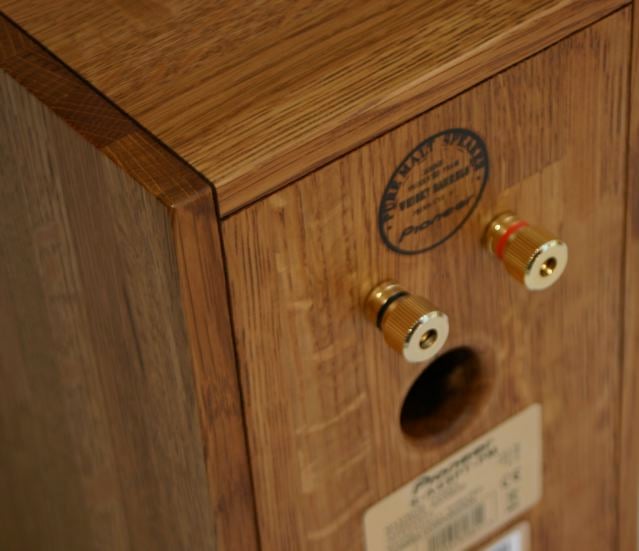

IMG_9226The Malts are incredibly well made - when was the last time you saw a speaker made entirely of hardwood?  Upon opening up the speakers, that is exactly what I found.  Even the extended port protruding into the speaker is constructed from hardwood.  The tiny woofer has a beefy, heavy magnet, and there was a modest amount of damping material covering the interior.  The gold-plated banana plug input terminals were very solid, but I do have a few complaints.  They are spaced too far apart to be able to use banana plug pairs, and the terminals were too small to accommodate one brand of banana plug connectors I have.  I have always assumed that banana plugs are standardized, but apparently not.  This sent me on a side project of testing all of the different banana plugs I had lying around the house.  In fairness to Pioneer, only the one brand did not fit (although it fits in all of the other speaker brands I have tried).

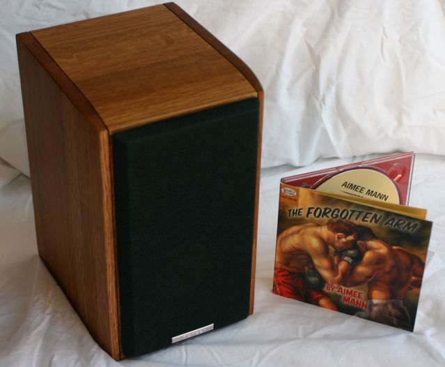

The black speaker grills connect via four solid metal nubs that worked very well and will not break.  The grill itself has a plastic frame, but is very solid - more so than many higher priced speakers I have encountered.  The cabinet itself is deep - deeper than it is wide, and has a port on the rear.  The top and sides of the speaker taper in towards the front ever so slightly, giving the speaker very high-quality design touch.
