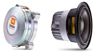

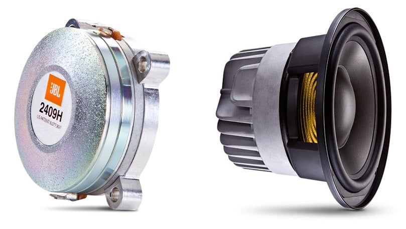

Starting at the top, both 7 Series monitors boast JBL’s new 2409H high frequency transducer, which features a lightweight annular diaphragm. The tweeters are loaded by the Image Control Waveguide, which allows for directivity matching of the high and low frequency drivers at the crossover point, and affords the 7 Series monitors neutral off-axis response. Covering the low end, JBL has two new custom long-throw woofers, the 5” 725G which is crossed in at 1.9kHz on the LSR705i, and the 8” 728G, which crosses in at 1.7kHz on the LSR708i. Both 7 Series models utilize vented enclosures made of birch plywood.
JBL Pro Drivers
JBL Pro's new high frequency transducer (left) and 728G long-throw woofer (right).
