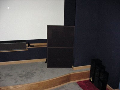

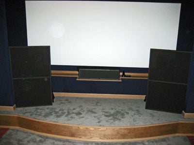

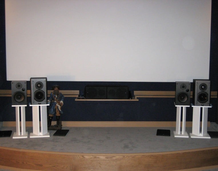

The environment was my 16' x 22' theater room - approximately 3000 cu.ft. – Perhaps just a bit large for these economical speakers, but fairly comfortable for the reviewers if I do say so myself. The front wall and 1st reflection points are treated with absorption. Speakers were placed on stands on the stage which put most of them a few inches above ear-level for front row listeners, and a couple inches below for the back row.
There were nine pairs of entry level bookshelf speakers in the face-off (originally 10, but a kit-built pair was eliminated very early due to a flaw in construction by yours truly). All comparisons were made two sets at a time, A vs. B, selected at random from the group. The speakers were set up as A B on the left side and A B on the right side so that the spacing between the pairs was about equal. Each pair was numbered on the back, and my son chose which pair competed with which, and recorded the numbers and cable attachments for each session. The speaker cables were only identified as “White” and “Black”, with corresponding tech-flex coverings to make it easy for him. An accomplished software engineer, but a total novice in audio (where did I go wrong?), he made no attempt to match up similarly sized, performing, or designed speakers. He would try to vary the cable connections when a particular speaker came around again, but didn't make that a big priority. All of this was done behind a speaker-cloth screen wall, so we never know which pairs were playing at any particular time (there were usually a few speakers outside the screened portion, so we could probably narrow the field a bit, but nobody really cared enough to try). When he completed his speaker swap, we level-matched the two pairs with an analog SPL meter and pink noise off a calibration DVD. The source was a Panasonic Blu-ray player with L/R analog connections to a Yamaha RX-V3900. Switching was done between two Zones in "Straight" stereo mode without a subwoofer (I like using the "Pure Direct" mode when trying out speakers, but apparently that won't work when using multiple zones). The participants had control over when the speakers were switched, and always knew which zone was playing, since we used the Yammy remotes to mute one or the other. There was no time limit imposed - a session ended when everyone was through with their evaluation.
Everyone used the same score sheet with 12 different items and a 1 to 5 scale on 9 of them (The other three were comment based). The items included: Quality of high/mid/low, how wide/deep was the soundstage, off-axis performance, etc. (items stolen from a forum thread - thanks!). To save a little time, we sampled various music selections, and then agreed to use a few tracks on a single CD from SevenMoore, a unique combination of blues, country, rock, and pop...electric and acoustic, male and female vocals. Even though a relatively obscure CD, most of us present were familiar with it thanks to Audioholics member Tomorrow, and agreed with him that it was a good choice and "...provided the broadest range of musical elements and included really deep bass runs and super high treble percussion instruments. Some songs demonstrated the power in their songs, and others were as delicate as falling snow. Great group." I wish I could be as eloquent (thanks for the quote, Tomorrow). We didn’t confer during the initial scoring. Later, during the non-scoring final face-off, there was plenty of discussion.

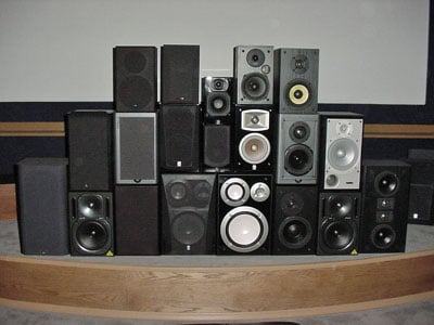

Of the 9 pairs evaluated, only 7 were really considered competitors, with a couple ringers I threw in for comparison. My attempt to be clever in adding them backfired a little as they scored the lowest of the group. The 9 pairs (by MSRP) were:
- Yamaha NS-6490 - $150/pr
- Polk Audio R15 - $179/pr
- Behringer B2030P - $190/pr
- Yamaha NS-333 - $199/pr
- Aperion Audio Intimus 4B - $260/pr
- Infinity Primus P162 - $318/pr
- EMP EF30 - $399/pr
- Pinnacle P5.2 - $550/pr
- JBL Synthesis HT1F - $850/pr
The Pinnacle and JBL were the
wildcards added when two of the planned pairs didn't make it. Current street
price for 6 of the 9 is under $200/pr.
