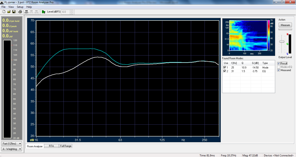

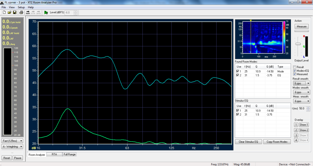

The main focus of XTZ Sound’s Room Analyzer II Pro is ... you guessed it ... the Room Analyzer function. It works by taking a series of measurements using sine sweeps at either a single position or three positions, and then suggesting filters to compensate for room modes. Before taking any actual measurements, you need to set the proper output level. This is done by dragging the output level control up or down (look at the top right of the image below), or adjusting the volume on your receiver, until the level shown is close to the green G. This system worked really well for me and made it easy to make sure all measurements were taken at an appropriate level.
When performing a 3-position measurement, the software shows a figure indicating that the first measurement be taken close to the front left speaker, second by the center listening position, and third by the front right speaker. Note that you can choose whatever positions you like. The marked positions in the figure are simply there to tell users to move the mic around. In fact, I would typically recommend not following the provided diagram, and instead focus on the main listening positions. Each position is weighted equally, so if one bad measurement taken away from the listening area can throw off the results. On a side note, it would also be nice to be able to take measurements at more than 3 locations, though it’s usually not necessary.

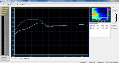

After the measurements have been completed and the EQ calculated, the software gives you a number of tools to tweak the results, as long as you are in advanced mode. Below is a comparison of standard and advanced modes.

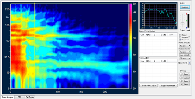

Room Analyzer Basic Mode
In the basic mode, you can view the measured curve (blue) and calculated results curve after applying the suggested EQ (white). It also displays the found room modes with suggested EQ (frequency, gain, and Q) in the table on the right. Above the table is a spectrogram that changes to show whatever curve you have selected. The spectrogram and frequency response graphs can actually be swapped by double clicking whichever one is displayed in the smaller window on the upper right.

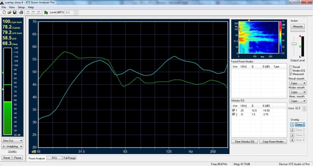

Room Analyzer Advanced Mode

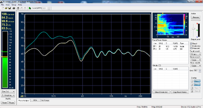

As you can see by comparing the screenshots above, the advanced mode offers users much more control than the standard mode. For starters, the time can be changed so you can view the frequency response at different decay times. You can also now view a third curve, Modes + EQ (green), which helps visualize exactly what the filters are doing. Maybe more useful than either of those features is the ability to copy Found Room Modes filters into a Stimulus EQ section. Any filters in the Stimulus EQ are added in-line to the signal sent to your receiver. This allows you to test the effects of different filters without actually loading them into your equalizer. The gain, frequency, and Q of the filters in the Found Room Modes and Stimulus EQ sections can be manually edited. This gives you plenty of power to try out different filters quickly and easily. You can also add extra filters by right clicking the frequency response curve and moving the cursor to the frequency and amplitude you want.
Up to four different measurements can be saved and overlaid by using the overlay button on the bottom right of the screen. The idea seems simple: take a measurement and then save it by hitting one of the numbered overlay buttons. You can then show or hide each measurement by selecting the “Show” button. In practice, I found XTZ Sound’s management of loading, saving, and overlaying measurements to be a bit of a hassle, though a few changes could remedy my complaints. First, the inability to name each overlay is a big drawback for me. It’s difficult to remember exactly what each curve stands for, especially if you revisit the project at a later time. I found myself having to take notes to remember exactly what I adjusted in my system to achieve each overlay. A limit of four also seems odd, and is one of the reasons I didn’t use this system during my review of MartinLogan’s Perfect Bass Kit (PBK) to verify the accuracy of PBK. There’s also no option to average curves, which would be useful when trying to show the average frequency response across a variety of locations. There are no controls to change the color, dB offset, or frequency range of curves. Finally, saving each individual curve as a file, for reference later, is confusing. When saving or loading a curve, there isn’t an option to select which overlay you want to save or load. XTZ Sound clarified for me that Ithe latest performed measurement that has visible and correct spectrogram is what gets saved. All other overlays only include frequency response. They also indicated that the reason for the current system is for simplicities sake, as adding more features tends to make software more difficult to use, but that this system may be re-visited in the future.
The frequency response and spectrogram windows can be swapped
The last advantage to using advanced mode is the ability to independently adjust the smoothing applied to each curve. It took me a minute to figure out what smoothing options were available because they are labeled as PPO (parts per octave) and shown as whole numbers, not fractions. The options given are 2, 3, 6, and 12 PPO. Once my brain kicked in, I realized that these are the same as 1/2, 1/3, 1/6, and 1/12 octave smoothing. Most people will be fine with 1/3 octave resolution, but when taking speaker measurements I prefer to use 1/6 or 1/12.
Noticeably absent is the ability to change the dB scale of the window, which is locked in at 50-100dB. Frequency is also locked in at 16-315Hz. A nice touch is a little display at the bottom of the screen that shows the exact frequency and magnitude (dB) of the wherever your mouse curser is located.
The only device I own that allows for manual PEQ adjustment is the Emotiva X-Ref 10 subwoofer, so I used it to judge the accuracy of XTZ Sound’s calculated and suggested filters. I ran the room analyzer, applied the suggested filters to the subwoofer, and took another measurement to compare the results. Time and again the XTZ Sound Room Analyzer II Pro measurement system proved to properly find room modes, suggest filters, and calculate a results curve that very closely followed what I actually measured after applying the filters. In the end, that means that the Room Analyzer achieved its main goal of helping me EQ my system. From this perspective, the previously mentioned limitations (overlay, dB scale, etc.) don’t seem to be all that important because the system still excelled at its core mission.

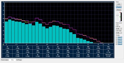

Real Time Analyzer (RTA)
An RTA allows you to see how loud particular frequency bands are in real time. It has limited usefulness when calibrating a home theater system, but still serves a few purposes. XTZ Sound recommends using it to adjust the phase/polarity of your subwoofer. This is done by monitoring the SPL shown on the RTA at the crossover frequency between your speakers and subwoofer and then adjusting the phase dial to achieve the highest SPL possible at that frequency. Each time you adjust the phase control, you can save an overlay of the measurement (just for this session, not permanently save). The RTA is locked in at 1/3 octave resolution, which is a little low, but good enough for the needs of most users.
RTA Screen Dump directly from Room Analyzer II
Unlike the Room Analyzer, the scale of the RTA window can be adjusted. It’s not continuously variable, but offers a range adjustment of 50 or 100dB, and top limit of 120, 100, or 80dB. The bottom limit is always set to 20dB. The nifty chart under the RTA window gives you better look at the exact frequency of each band.
I would like to see the option for higher resolution than 1/3 octave, which would simply require a software update. Otherwise, the RTA offers an easy way to measure the frequency response of your system using the built-in tone generator, and the Listen function is a great way to see happens when playing other material through your system.

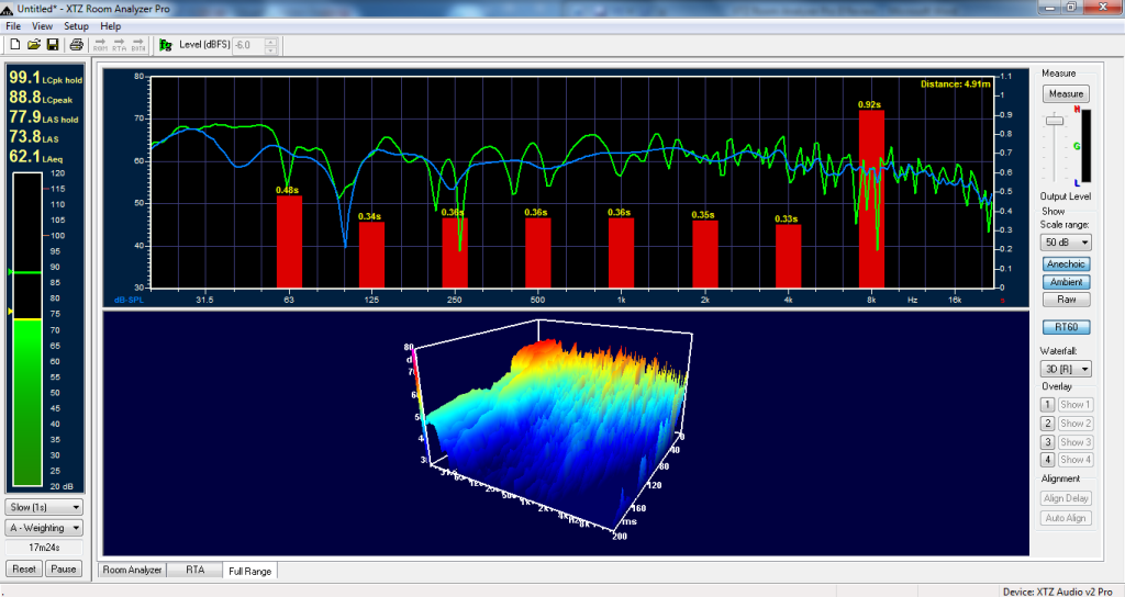

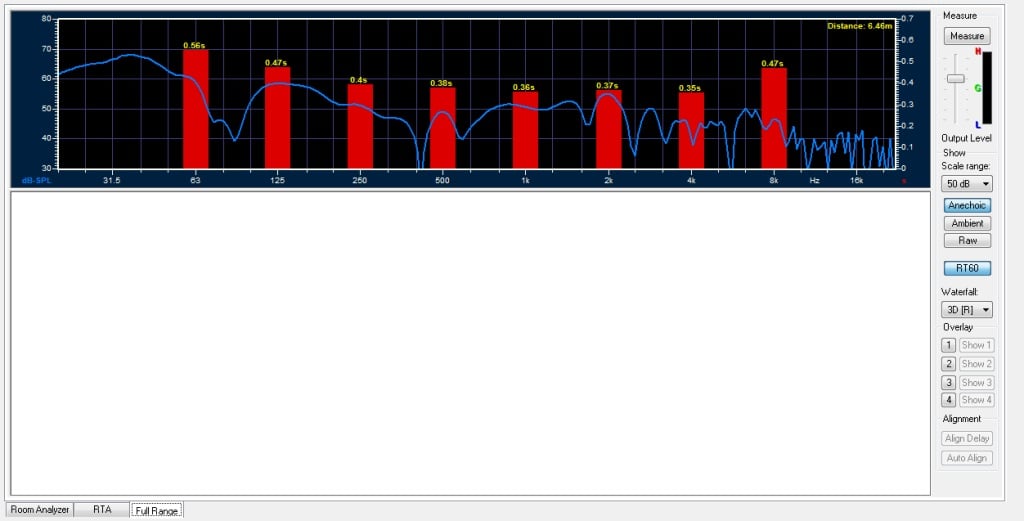

The last major component of Room Analyzer II Pro is the Full Range window. This window gives you the type of controls that you would expect from an acoustic measurement package, such as 20Hz-20kHz sweeps, RT60, and a waterfall plot. The controls are very similar to the RTA and Room Analyzer windows, including an adjustable scale (30, 40, 50, 60, 80dB) and four overlays. The scale cannot be adjusted along the x-axis (frequency), nor can smoothing be adjusted. For most people, the available scale adjustments will work great, I’m just used to more customizability.
Full Range Results with 3D Waterfall Plot and RT60
The screen is split into two panes, a frequency response plot on top and waterfall plot on bottom. The divider between the two can be moved up or down to adjust the size of each plot. In the frequency response window, you can toggle on or off the display of RT60 (1 octave resolution) and switch among three different types of curves: anechoic, ambient, and raw. The anechoic curve (blue in the above image) is supposed to remove room interference by gating the response to 4ms. The ambient curve (green in the above image) is supposed to show room interaction by gating the response to 8ms, and Raw is full FFT. I think the RT60 and different curve options are handy, but would prefer a manually adjustable time gating instead of only three options. Then again, the three options probably make things easier for new users.
One feature unique to Room Analyzer II Pro is an Auto Align option that compares the acoustic distance between your speakers and subwoofer. You start by taking a measurement with a single speaker, then saving it using the first overlay, and then taking a second measurement using only the subwoofer. Next, you click the “Align Delay” then “Auto Align” buttons. The program tells you the acoustic distance difference between the two measurements (displayed in milliseconds and meters), which you use to set speaker distance in your receiver. Upon first testing out this feature, I was unable to get consistent results. I later determined that excess background noise and incorrect settings in Windows for the playback and recording devices (both were set to 44.1 kHz sampling frequency instead of the correct 48 Khz) were at fault. After these changes, I was able to get the software to help me dial in my speakers to the exact millimeter. It took a few minutes, as I needed to take a new measurement of the subwoofer every time I changed the distance, but that was easy as it could all be done from the luxury of my couch.

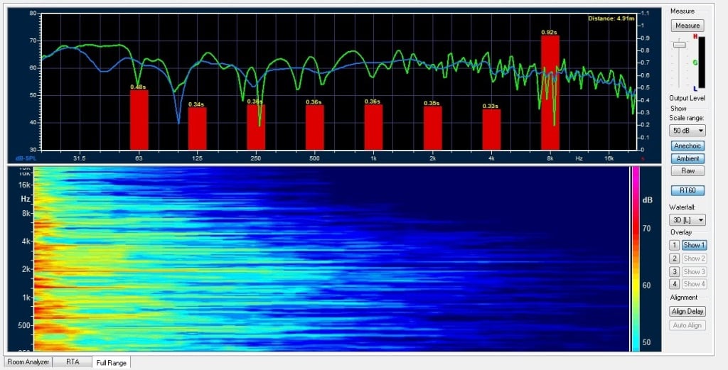

I did come across a few oddities when saving curves and screenshots. The above screenshot was taken using Windows’ Print Screen feature and accurately reflects what the software shows. The two images below were exported directly from the software. The left should show a 3D waterfall plot, but the software would only export an image of the 2D plot. This is too bad since the software can display the plot from an impressive array of 4 different perspectives (3D from 3 different angles, and in 2D). These options make it easy to interpret the plot, though dB, frequency, and time scales cannot be adjusted, which can make it more difficult to interpret with accuracy. XTZ indicated that this was a known issue and will probably be sorted out in the next version of the software.
                             Should show 3D
waterfall
Waterfall plot missing
In the image on the right, the waterfall plot is completely missing. Obviously, it would be annoying to export a screenshot only to find that the waterfall plot is missing, but this anomaly is particularly worrisome because there is no way to save and reload waterfall plots. There’s also no way to save the entire project as one file. Let’s say, for example, that you are using all 4 overlays and want to exit the program and reload everything as it was, that’s not possible. Each curve needs to reloaded to each overlay individually, which isn’t a big deal, except that it gets really confusing when trying to remember which overlay corresponds to what curve, especially since the most recent measurement isn’t assigned to any overlay and cannot be hidden.
