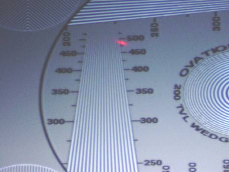

Resolution
Before putting the unit though a number of DVD's, I thought it would be a good idea to use the Avia Guide to Home Theater DVD and check out a few of the digital calibration images. I started with some Resolution images at 100 TVL and 200 TVL such as the one in this picture.
DVP-NS999ES resolution
There are a multitude of calibration images found on the Avia DVD which can be used to calibrate a TV Monitor, check the resolution or chroma delay of a DVD Player or compare component video cables. For the purpose of analyzing this DVD player, I used 100 TVL and 200 TVL images and compared the resolution between this player and other players. With the Sony DVP-NS999ES, both vertical and horizontal lines, and circles were solid with no jitter, indicating that the player is fully capable of creating high resolution images up to the maximum limit of 540 lines or 540/80 = 6.75 MHz. Some players, especially interlaced players, have a hard time producing higher resolution lines to this degree. When viewing these images through them, it is easy to notice that the lines near the 480+ mark begin to jitter or move rapidly, making the end look like a clam shell that is opening and closing rapidly. This was not the case with the Sony DVP-NS999ES. The entire calibration lines were solid with no jitters all the way out to the very end which is the theoretical limit for DVD.

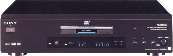

Build Quality
DVD players can be vulnerable to vibrations in the disc or optical pickup. Vibrations can occur during play of a loud, deep base movie, or other external sources. Sony implemented a frame and beam construction to provide rigidity and an anti-resonant design by implementing vertical and horizontal beams.
Further ensuring optimized performance and design, the model's spindle, motor and optical pick-up base are bolted to a sub-chassis.
The base unit is mounted on the subchassis called the mechanical deck. This is a self-contained box formed of Sony's Buck Molding Compound, which resists vibration and resonance.
The Precision Drive» 2 with Dynamic Tilt Compensation is Sony's second generation optical pick-up, which provides fast access and steady tracking by applying a high responsive serve tilt to the pick-up in order to compensate for some imperfections found in some discs.
A word of caution though. The loading tray has four low profile guides to help the user align the DVD/CD. Since the profile of these guides are so low, it is possible to load the DVD/CD slightly off axis and it can result in potentially jamming the unit. Just be careful when loading a DVD. Fumbling around in a dark room may not be the best idea when loading another DVD into the player.
