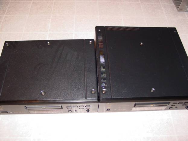

The player on the left, is the solidly built DVD-2900. The unit on the right is the overshadowing DVD-5900. The comparative dimensions are as follows:
Model#
Width
Height
Length
Volume
Weight
DVD-2900
17"
5"
13"
1105 cubic-in
17.6 lbs
DVD-5900
17"
5-1/2"
16-1/2"
1543 cubic-in
27.7 lbs
insideside-by-sideAs you can tell by the dimensions, the DVD-5900 is about 1 ½ times the volume or 50% larger than the DVD-2900. Along with the size difference, is a notable difference in weight by approximately 10.1 lbs.

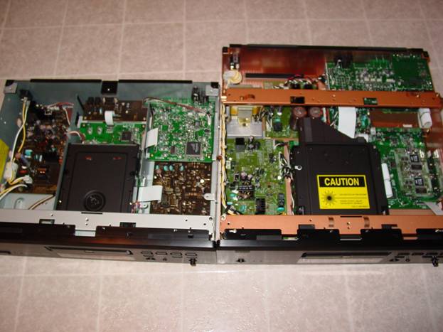

But dimensions and weight are not the only deciding differences between the players . Once the top covers were removed to reveal the internals, was easy to quickly observe a host of different design and hardware implementation features.
Grounding
Let's start with the differences between the grounding of the players . The DVD-5900 has a series of grounding strips along the top brackets and all along the side of the unit to assure the chassis and cover are securely grounded to each other. The DVD-2900 does not have this feature. In addition, the chassis of the 5900 is coated with a copper colored material. We will confirm with Denon as to what this coating is. It's either some form of copper impregnated coating or another possibly another conductive coating. This is most likely for better grounding, but it may also reduce EMI.

Aside from the differences in output, the mechanism in the DVD-5900 is more robust with a better tracking guide than the already beefy DVD-2900.

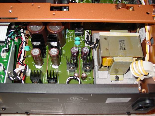

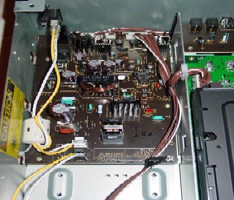

Power Supplies
This is another area where the two units differ, and likely where the weight and volume differences are justified. The DVD-5900 has discrete and isolated power supplies for digital and analog, whereas the DVD-2900 appears to integrate both together on the same CCA with separate regulators for the digital sections . The makeup of the analog PS for the 5900 consists of a 2" transformer with two large 50V and / 3,300µf capacitors and two 50V and / 470µf, along with additional smaller decoupling ones. The digital PS has a separate 1" transformer coupled with one 400V and / 100µf capacitor and a host of 16V caps. The DVD-2900 implements only separate supplies via smaller one 1" transformer for both digital and analog PS's with only one 400-V and 100µf capacitor coupled with smaller 16V, 15V and 100V caps. There are no large storage caps as found in the analog PS of the 5900. It is likely that the added horse power of the 5900 (implemented dual SHARC processors) demands a more robust power supply.

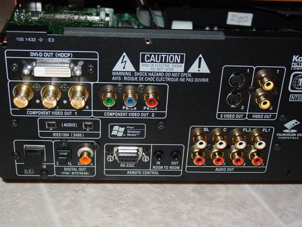

The back panels of the two units are certainly different. Kudos to Denon for providing true 75-ohm BNC component video output connections on the DVD-5900. This will simplify connections for those with front projectors, and will help decrease signal degradation for long cable runs . In addition, the 5900 also has two IEEE 1394 (S400) connectors, one DVI output (more on this later), a Denon link to connect to the Denon AVR-5803, two S-Video output connections and one RS-232C connector.
DVI Connector
The DVD Forum has officially approved the DVI-HDCP output on DVD players. With this announcement, Denon will be activating the DVI connector on all 5900 DVD players. This is great news for those with true digital TV displays .
backcloseup
Denon DVD-5900 Rear Panel

powersupply2900
DVD-2900 Dual Purpose Power Supply (Digital and Analog)
powersupply5900
DVD-5900 Discrete Analog and Discrete Digital Power Supplies
Note: Digital Power Supply is on the top right of the picture and the analog is on the bottom right.
