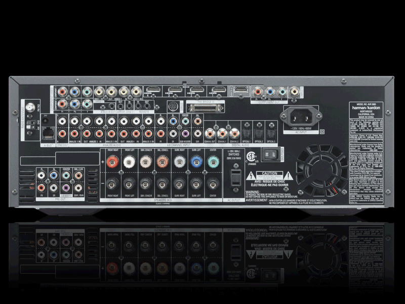

If you look on the back, the AVR 3600 has four HDMI inputs with the ability to decode all the current HD audio formats. There are two component inputs, plenty of composite inputs and, like with many receivers these days, the dreaded S-video connection has been eliminated. Good riddance. Harmon's also includes their proprietary setup & EQ technology which uses an included microphone to automatically configure your system to work optimally with your speakers and in your particular room.
There is also a completely discrete second zone. That means you can run a 5.1 system in your theater room, while playing stereo music in a second room. This is very cool, though there are some limitations. For one, the Zone 2 speakers outputs are shared with the Surround Back speakers, so you have to decide and then use the menu system configure the receiver. The second big limitation is that Harman didn't provide any digital to analogue audio conversion for Zone 2. It's strictly analogue only, so you can't use a digital source like a CD player, unless you also hook up its analogue outputs. Harman even included a separate Zone 2 remote. This is separate from the 8-device backlit learning remote that also comes with this receiver. All-in-all the remotes mean that you at least have a fighting chance to bring all of your other sources together onto a single remote.
AVR 3600 rear
