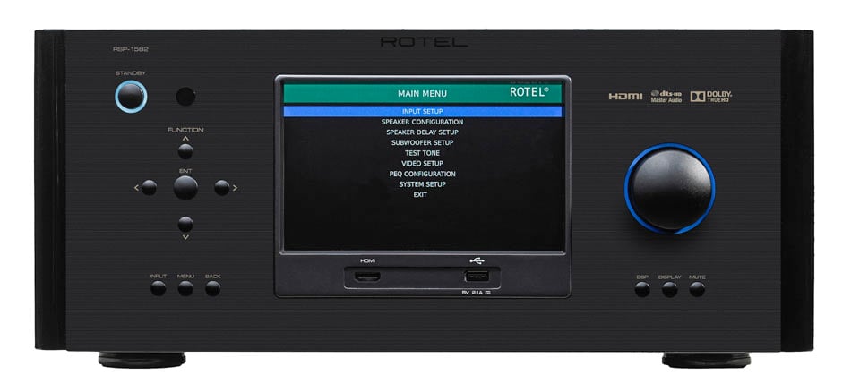

Rotel just took things up a notch in their product line by introducing their RSP-1582, a new 7.1 channel, surround-sound preamplifier/processor home theater component that can serve as a master control for all audio and video components in an upscale home theater system.  Although Rotel and Classe are part of the same B&W Family, the RSP-1582 does NOT share the same design platform as the new Classe Sigma SSP.  The RSP-1582 has ALL of the latest hardware to support HD Audio and Video but is missing  support for Dolby Atmos just like its Classe Sigma SSP brother.

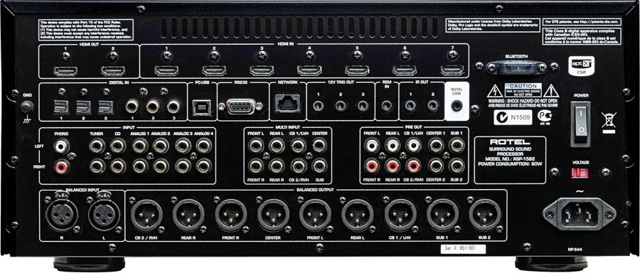

The RSP-1582 has an analog Bypass function for relevant input signals, which circumvents the DSP section to obtain the purest analog signal path.   Digital inputs include: optical (3), coaxial (3), PC-USB input supporting 24bit/192kHz audio, and an embedded aptX Bluetooth receiver for CD quality wireless connectivity.  The analog inputs include: Phono stage, Auxiliary (4), XLR balanced input, 7.1 channel input, and conventional stereo analogue inputs (6). The analog pre-outputs are presented on fully balanced XLR and unbalanced RCA connectors, both with twin subwoofer connections.  The volume control permits fine adjustments of level in increments of 0.5dB with .5ft distance configurability.
Although the spec sheet for the RSP-1582 shows the unbalanced analog outputs to be rated at 1Vrms and the balanced to be 2Vrms, this is NOT a maximum rating.  The voltage output on unbalanced RCA connections can reach 4 Vrms  with XLR Balanced outputs 8 Vrms measured before the clipping point with a THD+N measurement of < 0.008%.  This is plenty of output to drive any power amplifier to full power so there should be no worries about premature preamplifier clipping from the RSP-1582.

  • A 7” TFT display on the front panel facilitates easy adjustments of all audio and video parameters.

In addition to the RSP-1582’s prowess for upscale audio and video performance, custom installers will find it ideal for any installation, for these reasons: RJ45 network connection, USB front-panel connector to support software updates, three source independent trigger outputs, a wired IR remote input, RS232 and IP network interfaces for automation system control, two IR output connectors for IR pass-through, and front-panel navigation of setup menus.
