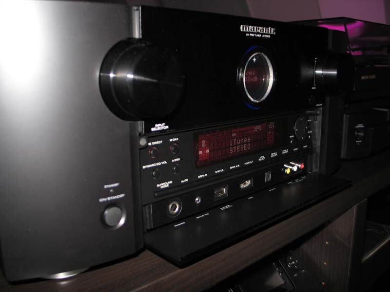

Because I replaced my SR6003 I'm not sure if I've got a strong opinion about build quality and appearance. Or do I? To be quite honest with you, I'm a sucker for Marantz's new design. The AV7005 is immaculate: the buttons are hidden from view by a panel. Just like the rest of the front, the panel itself is metal (plastic on the backside, visible when opened). The infamous “Marantz cheeks” on both sides of the unit are plastic. To some, this might come as a disappointment. Perhaps a high-end unit such as the AV7005 should come with an all-metal front? Obviously plastic doesn’t look as good as metal does, plus it scratches more easily. Then again, who flies a R/C helicopter into their $800 SR6003 AV receiver? Well, I did. Never you mind! My room is strictly a no-fly zone now! Poor flying skills aside, the plastic cheeks do look like they hold up pretty well design-wise, as they blend in nicely with the metal parts of the unit.

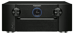

The “port view” screen offers source input and volume read out. Around the screen is a blue circular-shaped LED that can be turned off. The front panel design seems to have lead to some discussions on Internet forums. A lot of people argue it’s illogical to hide a display behind a panel. A valid point indeed! However, I found it’s not big a fuss opening and closing the panel. To me, it kind of adds to the experience of operating this behemoth.

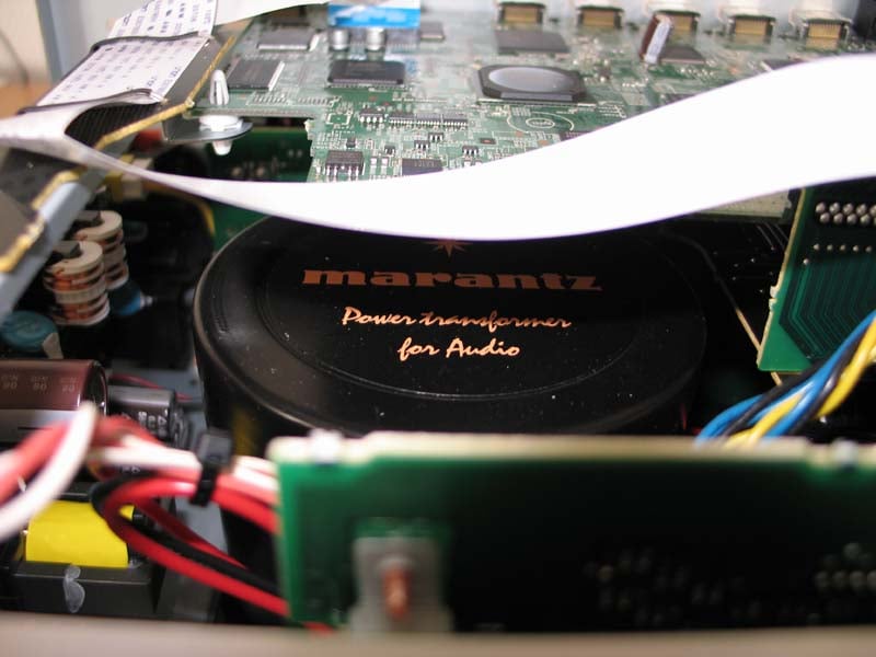

Construction and Build Quality

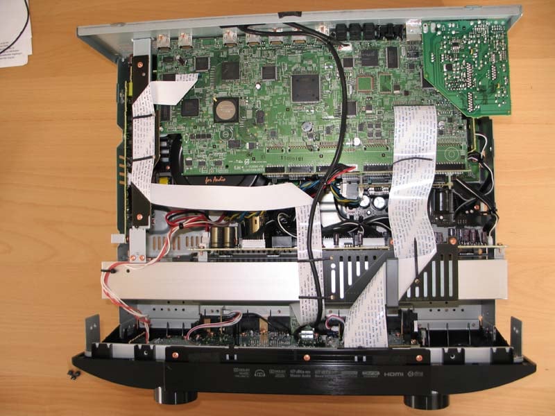

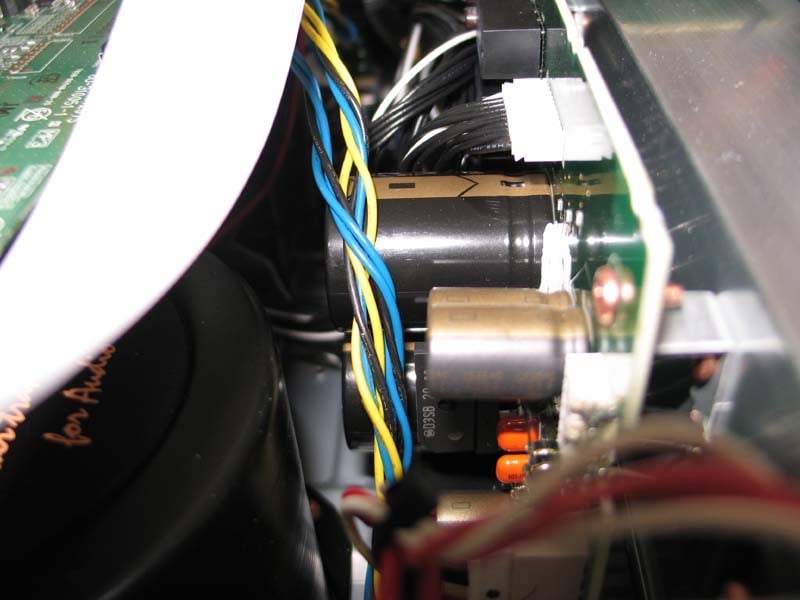

I actually bought this unit for myself, so I didn’t feel very comfortable taking it apart. But curiosity got the best of me. The AV7005 is built rigidly and a big proprietary power supply immediately stands out. A heavy-duty casing to prevent signal leakage encases it, labeled “Marantz Power transformer for audio”. If my sources are correct, this is a copper shielded EI core power transformer. The AV7005 has a symmetrical HDAM layout and gold-plated relays on the power supply board, though I couldn’t locate them myself. The pre amp section is located near the front panel and is mounted on a steel base plate (1.2 inch thick) that acts as an electromagnetic shield. Main capacitance is provided by two 3300 µF @ 25 volts audio capacitors, built by Elna. These are specifically designed audio capacitors from their “For HI-FI” LPO series II range, costing $10 each. Next are five smaller 100 µF @ 50 volts Elna SILMIC capacitors. Quite impressive, wouldn’t you agree?
Each row of connectors on the back has their own circuit board. For instance, the analog video circuitry is separated from the analog audio and 7.1Ch inputs. Moving further down is a specific board for the analog audio inputs and unbalanced pre outputs. The XLR connectors are neatly placed on their own board as well. The top mounted circuit board contains digital audio connectors and HDMI circuitry. Here, the 10-bit Anchor Bay video-processing chip can easily be located.
Every circuit board is mounted firmly to the frame by numerous golden-colored screws. Cables and other wiring are all neatly bundled by tie ribs. To be honest with you, it’s been quite some time since I looked at such well laid out electronics. The unit looks like it’s easily serviceable and components could be easily swapped out. It kind of reminds me of Apple Mac Pro’s immaculate electronic design.

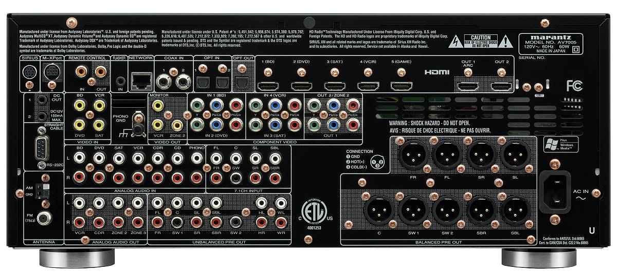

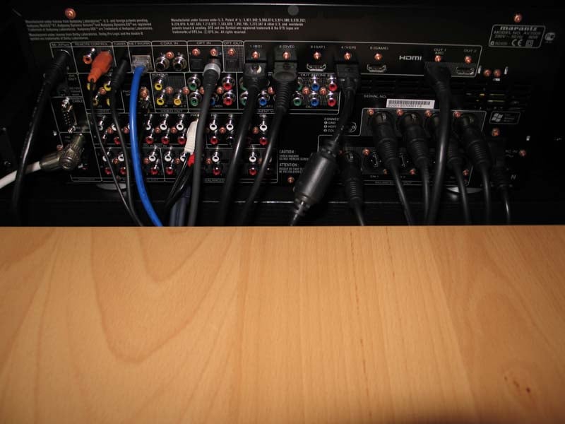

The rear panel is clearly laid out, but once again, Marantz doesn’t go the extra mile. There are two optical and two coaxial inputs (plus one optical out). Two of each might not be enough for some. A noticeable omission is the absent of s-video inputs / outputs. Though quite a brittle connector, S-Video does offer a massive quality improvement over composite by separating brightness and color information. An adaptor can easily convert a S-Video signal to composite, but you can’t go the other way around. Most manufacturers are now eliminating S-video all together to free up back panel space. Moving forward with HDMI and component video should be applauded. Still, to me it makes more sense ditching composite connectors instead.
Lastly, there’s some talk on Internet forums that the AV7005 is more susceptible to ground loop hums, but I haven’t encountered this problem.

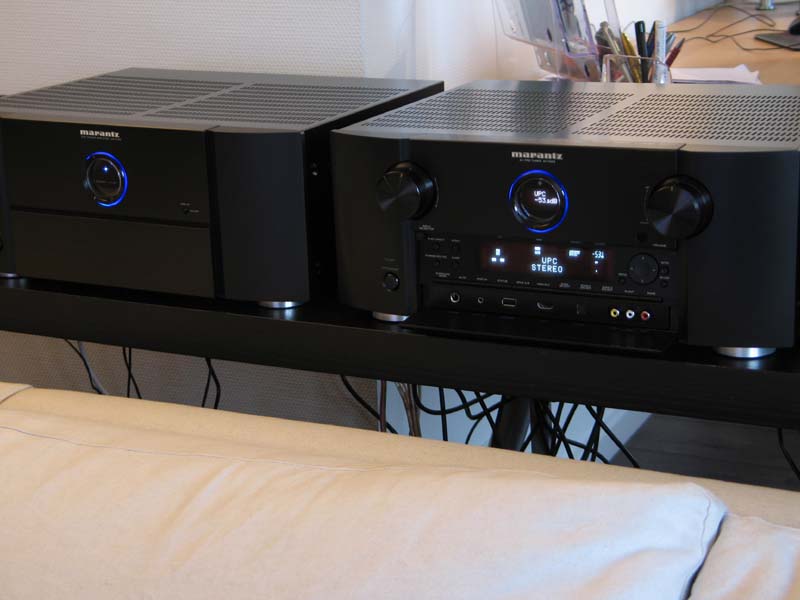

For this review I've paired the Marantz AV7005 Pro/Pro with the MM7055 multi channel amplifier. Music sources came from an Apple MacBook Pro, using Apple lossless songs, as well as 256kb/sec purchased music. The computer is connected to the AV7005 using an HQ Products optical cable. For movie sources I've used a Marantz BD6003 Blu Ray player, connected by an HDMI cable.
I have a 4.1 channel set up. The front speakers are Phonar Veritas 5.5 EdMa with Cap+ upgrade. They are hand built by a German company, called Phonar and modified by a Dutch audio expert called Edwin Maas (EdMa modification available exclusively through Stassen HiFi Netherlands). The speakers contain a modified Seas tweeter (manufactured in Norway, I believe) , modified midrange and woofer drivers, improved dampening materials and uniquely designed filter electronics. This particular set-up contains the optional Cap+ upgrade; a beefed up capacitor to improve filter performance.

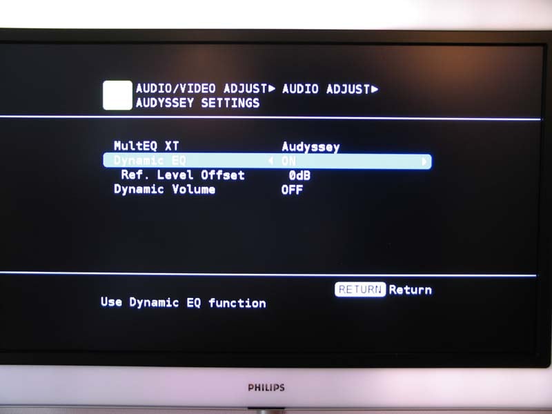

I'm one of those guys who don't really like giving a metal box control of EQ settings. I set up everything manually on my SR6003 and stubbornly refused to use Audyssey room correction. Now that I tried it on the AV7005, I wonder how good the new XT32 must be. This is another of those things I’ve been mentioning, where Marantz doesn’t quite go the extra mile. It’s too bad / a shame / apocalyptic (your mileage may vary) this high-end unit doesn't come with Audyssey XT32. XT32 supports a much higher filter resolution (512 times for XT32 versus 16 times for XT), allowing finer adjustments to be made. To Marantz defense, very few manufacturers are supporting the new XT32 Audyssey implementation at the time of this review.

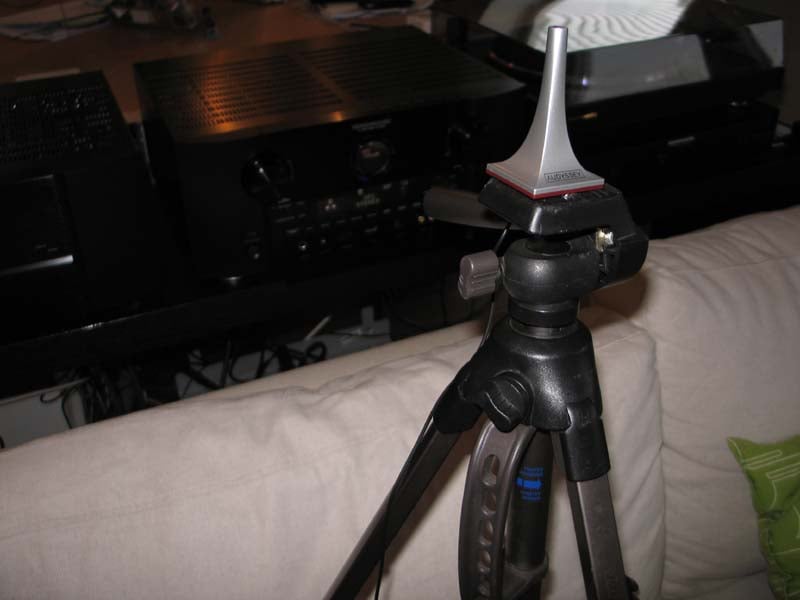

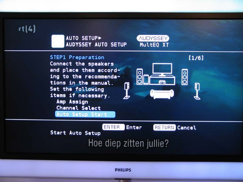

The Audyssey Auto Setup is very easy to use. To ensure proper measurements, make sure your room is as quiet as possible. For some this is a challenge by itself, so here are some tips. Remove any ticking clocks, turn off your fridge, air-conditioning, cell phone and dimmable lamps, close doors and windows, shut down heaters and stop breathing during set up. I was stupid enough to run the setup during Friday evening rush hour. Just to make sure, I repeated the process on a quiet Sunday afternoon. My efforts were in vane: the outcome was pretty much the same!
Connect the supplied microphone, mount it on top of a tripod (a cheap camera tripod will do) and place it at ear level at the primary listening spot of your room. It will then measure acoustical room properties (such as reverb time and bass response) and the frequency response of the speakers. It does this by emitting ten loud “pings” per channel. It also checks for correct speaker polarity. Repeat measurements in different locations (6 to 8 points recommended) to give Audyssey a more detailed sonic image of your room. I advice you to measure a second listening position and then continue the other measurements in between the primary and secondary positions. Don’t forget to set your subwoofer’s volume the twelve o’clock position (50%) and the crossover frequency to its highest setting. Skynet, I mean Audyssey, will take control from now on.

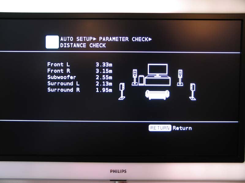

Reviewing Audyssey settings after set-up was a revelation and a lot of fun. I recently hired a professional to perform room acoustic measurements (for future improvements I have planned). I am happy to say that Audyssey's "second opinion" matched up just fine! It correctly spotted a nasty dip around 125Hz ~ 200Hz in my room and a drop off near 8kHz.
Firstly, speaker distance measuring was spot on. It "misread" one of the front speakers by just 10 cm! My left front speaker is closer to the wall than the right channel, because I have a non-symmetrical room. This also means the stereo image is slightly of, which Audyssey now corrects. My subwoofer is located between the left front and left surround speaker. Audyssey's EQ tackles these issues by giving less bass to the left channels and a tad more highs for the right channels.
Measure all you want. I want to hear it! What kind of difference can all this equalizing possibly make? Well, it turns out the difference is night and day. For over an hour, I listened intensely to Freddie Mercury and Montessat Cabellé's master piece “Barcelona”, Dire Straits' "Industrial Disease" and Seal's "If I'm any closer" while toying with available Audyssey settings. I tried both the normal Audyssey setting and the “Flat” setting, which is more suitable for music listening. In general, both settings deliver a huge amount of sonic detail that isn’t there with Audyssey turned off. The stereo image is a whole lot better and high frequencies are a lot brighter. In my case this translates into the main vocals being boosted quite a bit. Before, main vocals seemed to be hidden behind the music. Now they correctly stand out again. Definitely two thumbs up.
I also learnt Audyssey is not a silver bullet. It can’t overcome every problem and sometimes it introduces them. I was taken aback by the channel level settings of the speakers. FL -7.5, FR -8.5, SW -12, SL 4 & SR -4 (Yes, I use a 4.1 set up). Audyssey lowers the maximum output of the unit by quite a few decibels, presumably for some more headroom. It’s not a problem for me because I don’t need my neighbors to burn my place down. I had to manually tweak channel levels a little bit for a dead-center stereo image.
I played "Life in Technicolor II (Vocal)" by Coldplay and "Wonderful Life" by Hurts. Before I tried Audyssey, both songs sound like the way my mornin' poop looks like (all mashed up and one big pile). And after you ask? Same thing! So I guess it has nothing to do with EQ. Then I remembered what they taught me back at the university: "garbage in = garbage out". Nice songs, sure, but obviously mastered by a deaf three year old. Audyssey won’t change any of that.

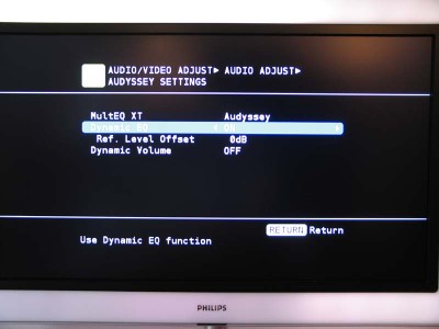

There’s also an option to set “Dynamic EQ”, which takes into account human perception and room acoustics. To me, this made a positive change to sound quality as well. While listening at higher volumes to Filter’s “Take a Picture”, it does seem to overdrive high frequencies just a tiny bit.
Lastly, “Dynamic Volume” could be handy watching TV as it fixes volume changes between the program and commercial breaks.

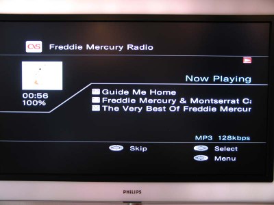

The new network functionalities are the primary reason why I upgraded from the SR6003. I plugged in a CAT-5 network cable into the AV7005 and within seconds the unit set-up itself. Absolutely no manual set-up required. Do make sure your router has a DHCP-server built in. I checked the Internet Radio program of the AV7005 and it automatically found 619 stations! The AV7005 selects stations based on your geographic location. In my case: the Netherlands. All those world famous Dutch stations are included, along with loads of foreign ones as well. BCC, French stations, the Germans, you name it really.
Sound quality is somewhat disappointing: around 128KB/192KB. The best stations compare to FM, I suppose. FM stations here in the Netherlands have a tendency to pitch up songs, boost bass frequencies and compress the life out already overly compressed songs. The same is true for Internet radio stations, unfortunately. Let’s hope bit rates increases as time goes by.

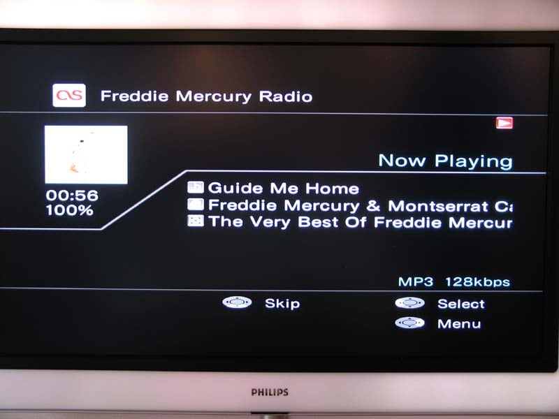

My Last.FM subscription just increased in value. The initial hype I had with Last.FM died down recently. I started thinking whether or not I should continue my subscription. The AV7005 has a pretty cool Last.FM interface that gets the most out of my subscription. Friend's radio channels, Artist channels, all easily selectable via the OSD interface. Skipping songs, "loving" and "banning" them are a breeze. Personally, I like it a lot more than the Last.FM app on my Macbook. From time to time the OSD seems a little bit slow to react but I suspect this has more to do with the network connection.
I’ve had some issues connecting to last.fm. When manually changing the input on the unit to NET/USB and then selecting Last.FM, it won't connect. But, when using "source sel" on the remote and then selecting Last.FM, it connects just fine. Strange, huh?

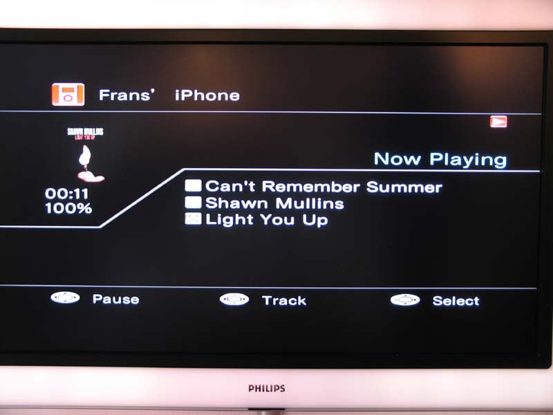

As expected, connecting my iPhone was a breeze! I plugged it in and seconds later it was selectable in the NET/USB menu. My iPhone 4 isn't listed in the manual as supported device but works flawlessly. I’ve also tried my mother’s fourth generation Nano with no problems encountered. The AV7005 connects to iPods pretty much instantaneously.

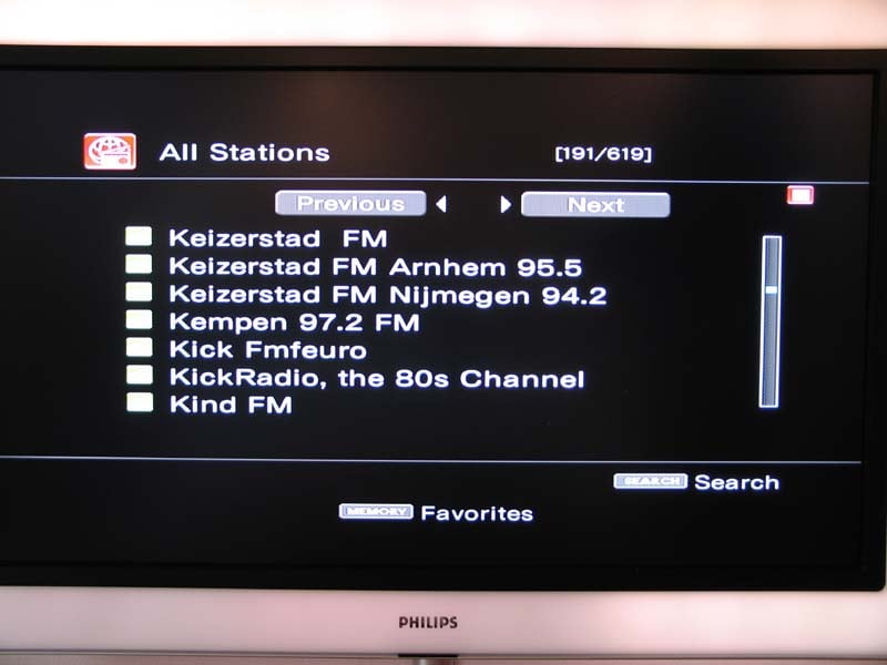

Again, I really dig the OSD interface, though the album art is a bit small. When browsing a playlist, there are seven songs displayed alphabetically per page. Use the remote to go up & down a page. Simple and effective, it beats Apple Front Row's solution that "glides" through a playlist. There, I "over-slide" the song I'm looking for EVERY single time. Loading time of a page could be quicker but still the lag isn’t too bad. However, you will over shoot pages if you try to browse through them too quickly.
There’s also another handy search option available. Press the "search / info" button on the remote once for "page up & down" mode. Press twice for an alphanumerical bar that appears on top of the playlist. No matter how many songs you have, you can quickly go from A to Z, selecting the letter of choice. What I didn’t understand was an unhelpful message "Unsorted list...." when selecting a certain letter. It took me a while to figure this one out. It so happens that it gives this message when there’s no song in the playlist starting with the selected letter. I know my English is crappy, but really, “Unsorted list”? Lastly, there’s no "current song" option. After browsing a playlist, I have to wait a few seconds for it to display the current song. For an impatient guy like me it is asking quite a lot.

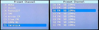

It can search the entire FM band to store stations automatically, sorted on frequency. A preset channel is stored in a so-called "memory bank". Memory bank? - Not so good. What's this, a moon rocket? There are eight of these "memory banks", labeled A to G - each containing 8 slots. Thus allowing 56 stations to be stored as a preset. Are you still with me on this? Why not label them "preset 9 or 40" instead of "G3" or "A5"? I just don't get it.
The AV7005 allows extremely fast preset channel browsing, as it shows RDS station name information on its main liquid crystal display almost immediately. On the other hand, the OSD much is slower to respond and browsing preset channels using the OSD can be a little bit confusing. Normally, the OSD neatly displays all the relevant RDS data, frequency and tuner settings onscreen. When changing a preset, a pop up window appears with one of those dreaded memory banks. Frequencies are listed, but it will not show RDS station name information at all! Bummer. Luckily, there is a solution. The AV7005 allows you to manually add station name information for presets. It would have been more useful if the AV7005 could automatically name memory slots in the OSD, based on RDS information.
Memory bank C with station names renamed (left) versus memory bank G without renaming (right)

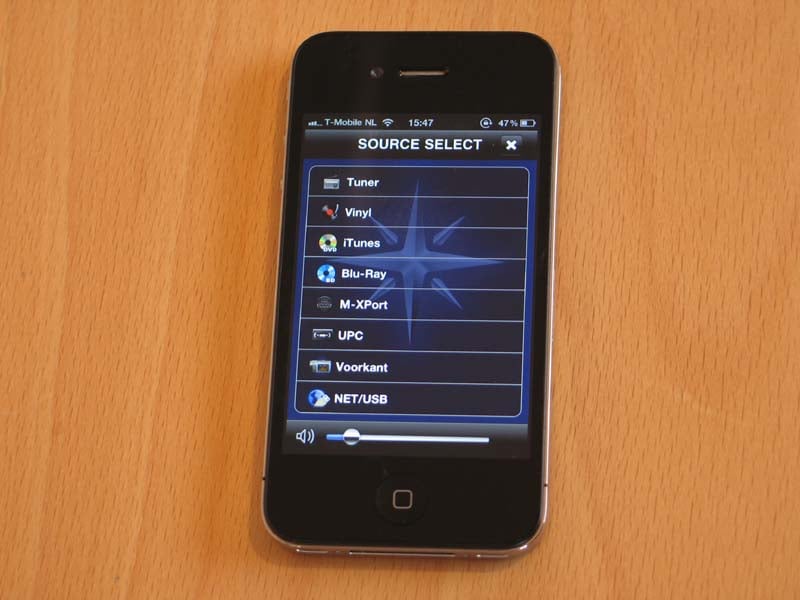

Wizz Iphone app
Marantz offers a free app in the Apple App Store called “Wizz App”, that allows you to control model numbers SR7005, AV7005 and NA7004. You can read Audioholics’ review about Wizz App here. In general, the app is nicely responsive and doesn't suffer from that annoying "reconnecting lag" Remote App for iTunes has. It must reconnect for some reason when you leave the iPhone unused for some time. Using both Remote app and Wizz App is a pain, even with iPhone 4’s new multitasking feature. So my first recommendation for future updates is definitely having some sort of iTunes browsing built in.
Generally speaking, the app doesn’t have a lot of functionality and should only be considered a gimmick at this point. One nice thing Wizz app does have - both the AV7005 and its remote do not - is the ability to set a DSP mode directly. Unfortunately, the list of DSP modes is not complete.
These last few days I haven’t been able to use Wizz app, due to a persistent connection error. It tells me to check the device, then quits, but what part am I to check exactly?
To sum it up: Wizz app has huge amounts of potential, but don’t throw away your remotes and TV display just yet. It is clearly in its infancy. At the moment, the best way to controlling the AV7005 is using the remote and the OSD.

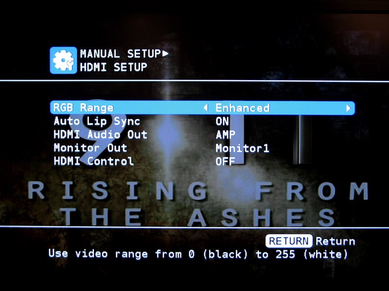

The AV7005 allows for a number of video settings to be made. In the Audio/Video Adjust menu there are basic adjustments for contrast, brightness, chroma level (color saturation), hue (color tones), DNR (reduces picture noise) and Enhancer (emphasize picture contours). You might want to use these last two settings for standard definition TV only. With high definition material, the DNR and Enhancer adjustments didn’t really make a difference to me.

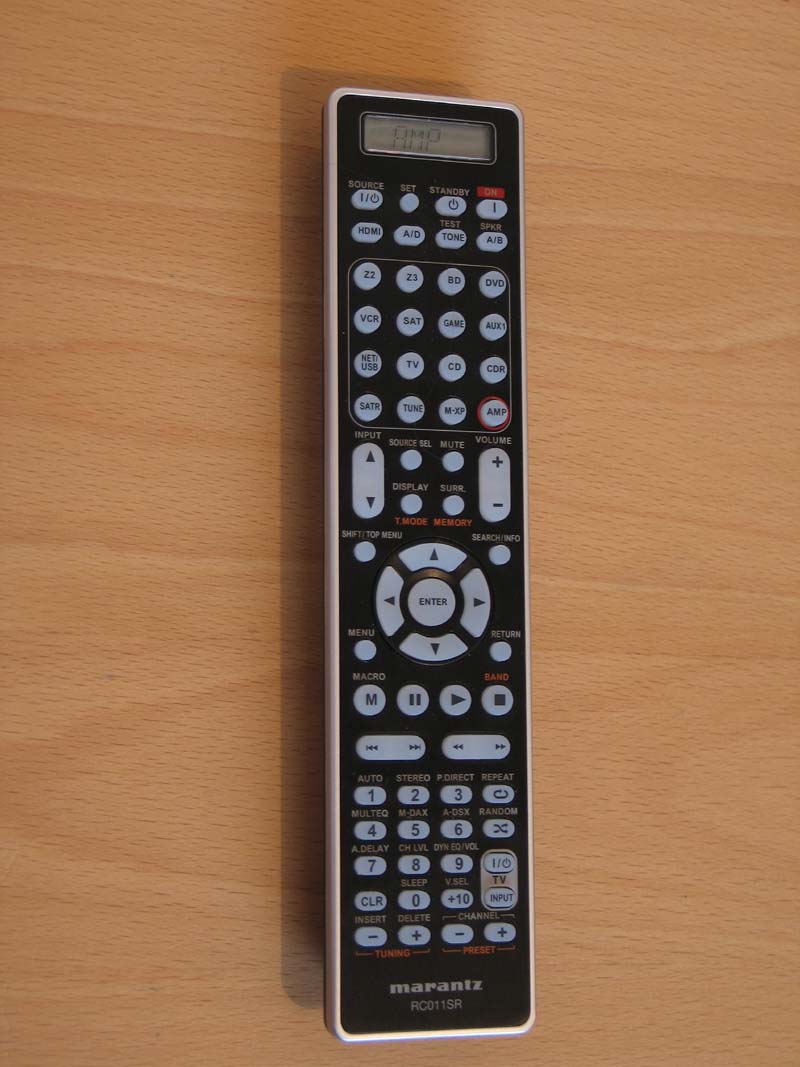

It's rather poor, to be honest. Ergonomics are good and the backlit buttons are very handy and cool looking. A big part of the remote is taken up by direct source selection buttons, such as BD, DVD, VCR, SAT, GAME, etc. They are confusing. Worst yet, their “source sel” implementation, along with the tradition “input up & down” buttons makes those direct source selection buttons obsolete.
The remote has several buttons with more than one function, so every source has different options. For instance, pressing the NET/USB source button twice will change the AV7005 to this source input, but it will also change the remote setting from "AMP" to "NET/USB". Now, the specific “NET/USB” source buttons become available. I always forget to change the remote back to “AMP” whenever I want to control an AMP-option. I find myself pressing a button 5 or 6 times, before I realize why it's not responding, Grrrr!
Also, I have changed just about every source input name using the OSD source rename function (you are going to love the new OSD keyboard function they came up with!). On the remote however, you’re stuck with the pre-labeled buttons. Luckily the “source selection” buttons helps out. The OSD will display a neat-looking menu with the source names correctly labeled.
There are two buttons on the remote to power on / off your TV and change input. This worked out of the box with my Philips Aurea.
Poor remote aside, the AV7005 introduces so many useful functions over the SR6003 that I don't think I will ever be able to set up my Logitech Harmony properly.
