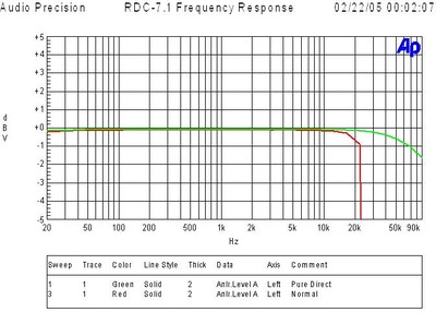

The red trace shows the frequency response via the analog inputs after they go through ADC and DAC conversion stages. As you can see, there is about 0.5dB roll off at 20KHz followed by a sharp brickwall filter response rolloff at ½ nyquist frequency of 22kHz (44kHz sampling rate). The green trace represents "Pure Direct" mode, where the 3dB point was well above 100kHz.
When the analog preamp was driven at 1Vrms (typically ½ signal strength to achieve ½ of max power of most power amps with voltage gain of 29dB) distortion levels were (+.0446 + 100.511)dBv = 100.957dBv or 100*alog(-100.957/20) = .000896%! The yellow trace represents "Pure Direct" mode, while the red trace represents DSP analog input. As you can see it is only slightly higher in distortion, certainly not dramatic enough to be audible. This is good testament to the ADC design and implementation in this product!
Integra Research distortion spec at 1Vrms was .05%, about 5 times higher than I measured, or 35dB worse. Talk about conservative!
When I drove the analog preamp to its limits it was able to output 7Vrms unbalanced and 15Vrms balanced (about 10dB more gain than you should ever need) and distortion levels were (+18.298 + 68.449)dBv = 86.747dBv or 100*alog(-86.747/20) = .00459%!
Note: In "Pure Direct" mode the analog inputs were able to handle about 7Vrms before clipping input circuits and 2Vrms when engaged in analog DSP. Most consumer equipment (ie. CD players, VCR, etc) drive 1-2Vrms max via their analog outputs so there shouldn't be any compatibility problems here. If for some reason you find the input levels too high, causing clipping, the RDC-7.1 provisioning for independent level trims for each input will come in quite handy here. This is great foresight on their part!

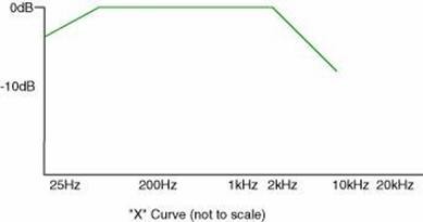

For those wondering what the typical response of THX ReEQ™ looks like, here is a frequency response plot with it engaged. While it's not the preferred two biquad solution, it just passes, since the total droop in energy in the 2K to 10K pass band closely mimics the original X curve correction. This response curve follows the digital, single biquad, low pass filter response. Sonic differences between these two types of filter responses are likely not audible in most applications given the much large variance of speaker responses and room interaction.
Editorial Note About THX ReEQ™ by John Dahl of THX
ReEQ was developed by THX's Tomlinson Holman in response to a request from the movie sound editors and mixers at Lucasfilm's Skywalker sound. The mixers found that when they listened to master tapes of their work on their home systems they sounded consistently too bright and edgy compared with what they heard in the movie dubbing stage where the masters were created. Movie dubbing stages are set up and calibrated to sound exactly like good movie theaters and vice versa. It's important to movie sound artists that they create the sound track while listening to the same system as the theater audience. In the movie biz this is known as accurate venue to venue translation.
In a movie theater the audience sits a long way away from the speakers, a theater is acoustically absorbent and the theater speakers have the high frequencies turned down slightly. In a home you sit close to the speakers, the room is acoustically live and the speakers do not have the high frequencies turned down. So you can see that a soundtrack recorded in a theater would sound bright when played back at home. The THX ReEQ filter compensates precisely for the response difference between a perfect movie theater and a perfect home theater.
The dubbing stage to theater translation is usually quite good but home theaters are another matter entirely. For example, a film played on a small TV without ReEQ may actually benefit by the high frequency boost while a decent home theater will almost always sound hard or edgy and therefore benefit from ReEQ.
Then there's the matter of the very small percentage of DVDs that have been "remixed for the home". That sounds like a good idea but who's system is it remixed for? How close will you sit to the speakers? How reverberant is your room? Etc, etc. Even when a disc is marked as remixed (which it may not be), these questions are impossible to answer in a technically and consistently useful way. This makes the THX ReEQ a known quantity based on idealized systems which can then be used or not as preferred by the individual listener.
Bottom line is… THX ReEQ, based on an ideal set of circumstances turns out to be quite useful even though home theater systems have wildly variable in-room responses making perfect corrections impossible 100% of the time.
