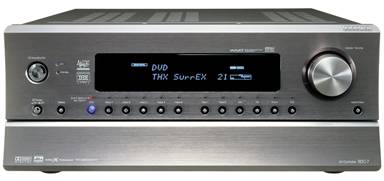

Integra Research RDC-7 Processor Review
- Product Name: RDC-7
- Manufacturer: Integra Research
- Performance Rating:
- Value Rating:
- Review Date: September 15, 2003 19:00
- MSRP: $ 4500
Formats: THX Ultra-approved with Dolby Pro Logic, Dolby Digital
(with THX EX), DTS

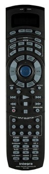

- Mediocre remote control

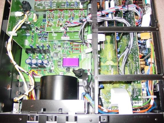

By modularizing the RDC-7, Integra Research has increased the service life of this
processor by reducing the chance of obsolescence.

Integra RDC-7 Digital Architecture
The digital architecture of the RDC-7 includes a vast array of cutting-edge technology combined with several unique features. From superior DAC's to proprietary technology, the RDC-7 is a sophisticated processor capable of audiophile performance. The sections below outline the digital/analog architecture that serves as the backbone for the RDC-7's impressive performance.
Digital to Analog Converters (DACs) for front channels
The Front channels employ dual differential Burr Brown (now part of Texas
Instruments) PCM1704, SoundPlus (TM) 24-Bit, 96kHz BiCMOS Sign-Magnitude Digital-To-Analog Converters .
This is an improvement to many "high-end" processors that utilize single ended DAC's for their front
channels. The PCM1704 is a precision, 24-bit digital-to-analog converter with high dynamic performance,
ultra-low distortion and excellent low-level signal performance. The PCM1704 supports 8X oversampling
at 96kHz.
Dual differential DAC implementation can offer quite an improvement over a single-ended configuration, especially if the entire design path is complimentary. Integra Research takes it one step further with a low jitter Apogee clock that ensures the full performance of the DAC's can be realized.
Digital to Analog Converters (DACs) for other channels
The center, surrounds, rear surrounds and subwoofer channels
implement Analog Devices AD1853
24 Bit, 192 kHz, Multibit Sigma-Delta DACs
in
a single-ended configuration. The AD1853 is fully compatible with sample rates from 32 kHz up to and
including 192 kHz. It also achieves 120 dB of dynamic range and Signal-to-Noise ratio without muting of
107 dB THD+N. The AD1853 also features a superior Digital Filter with 115 dB stop-band-attenuation. The
AD1853 uses Analog Devices' exclusive Multibit Sigma-Delta Modulator with "Perfect Differential
Linearity" for reduced idle tones. It also features Analog's patented Data Directed Scrambling to
minimize sensitivity to jitter.
Just to note, while these are quality DAC's, Integra Research implemented them in a single-ended configuration. This single-ended configuration is similar to that found in the Integra DTC-9.4 and many other receivers and processors currently available. Even with the low jitter Apogee clock and Vector Linear Conversion described below, we wonder if including dual differential DAC implementation with full complimentary circuit topology on all channels would have offered an audible improved performance from these channels. However, our listening tests did not appear to reveal any major sonic limitations in its current configuration.

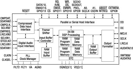

Digital Signal Processing (DSP)
There are two 493000 series Cirrus Logic
Crystal Enhanced, Dual Engine, Multi Standard Digital Audio Decoders (otherwise known as DSP chips) in
the RDC-7. One DSP chip is devoted to Dolby Digital and DTS decoding, while the other is devoted to
secondary functions. By implementing two DSP's, Integra Research has employed technology above that of
many other processors we have reviewed in this price range. However, we wonder if their next generation
platform will require more horsepower to handle new features such as room correction or digital video
processing which seems to be the next evolutionary step in home theater products.

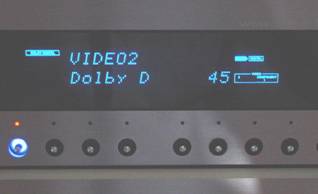

Display
The display colors match that of the blue recessed lighting found in the mode
switches. The size is sufficient for easy reading of source selection mode, digital surround mode, and
direct mode while viewing from across the room. But as with most other receivers and processors, there
are many other secondary items displayed that are too small to read unless you are up close. With the
RDC-7's ability to automatically identify an incoming source signal and set the processor to the exact
mode of operation, most of these smaller features are for informational purposes only and not critical
to normal operation.

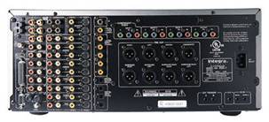

Back Panel
The back panel of the RDC-7 is laid out in a concise, logical manner which ties into its
modularized internal electronics. All balanced connections are located in the mid section with
component video inputs nestled above. Digital coaxial and optical connections are in a straight line
down the unit. There are five video, one monitor, one DVD video and one Zone 2 video inputs (a total of
8 video inputs) all with an optional S-Video connection. All analog inputs for two-channel sources are
located on the left side of the panel. The far most left corner is where the 6-channel input DB-25 and
RS-232 connections are located.
The DB-25 connection used for the 6-channel input provides a simplified connection with the Integra Research RDV-1 DVD Player or other players that have matching connector. But when connecting DVD players with standard RCA's, it somewhat complicates things. Since there are no well established standards for color coding the 25-pin connector cables (except for a THX guideline that few cable companies follow let alone know about) it can become a challange to connect. The processor comes with an adapter that combines a DB-25 male connector with 6-female RCA's to allow the user to connect via standard RCA's. If you care to attempt a simplified connection, there are a few cable manufacturers that actually make a DB-25 male connector directly to 6 RCA males to allow direct input to your DVD player. But with no governing standard for the color codes, you'll need a pin-out diagram to ensure your connections are accurate. Furthermore, due to the nature of the DB-25 connector, these cables can not be easily shielded like quality RCA cables. In our opinion, a DB-25 connector for 6-channel input offers few advantages over standard RCA's, save the space savings on the rear panel.
The bottom left corner of the back panel includes an IR in Main , IR in Zone 2 and two 12-volt triggers. The two 12-volt triggers are a useful feature when tied to the Integra Research RDA-7 power amplifier, for example. This feature allows for instant power-up of an amplifier with matching trigger input. The second trigger is useful for tying into any other devices that have a 1/8" mini-jack 12-volt connection.

Integra Research RDC-7 Remote Control and Conclusion
The
Pronto-Style RC-418M remote was sufficient for easy operation of the
RDC-7. It was well laid out, clearly marked and backlit for nighttime
use. What was especially helpful was the dark black lettering provided
directly on the buttons. This made them readable when backlit in
darkened rooms during viewing of DVD's.
The remote was somewhat lacking in regards to programming it for other products in our Home Theater setup. This was primarily due to it not having any pre-stored codes. Every function, from turn-on to operation, had to be manually "learned" into the unit. What was even more challenging was when we decide to use the Universal Remote's MX-700 home theater remote control as there were no codes for Integra Research found on any Universal Remote product, though there may be some independent online resources available to users.
If you are patient, and plan on having the RDC-7 for a long time, then programming this remote for your entire home theater system will not be that big of an issue. When completed, the RC-418M remote offers many useful features that will make it easy to operate your entire setup.
