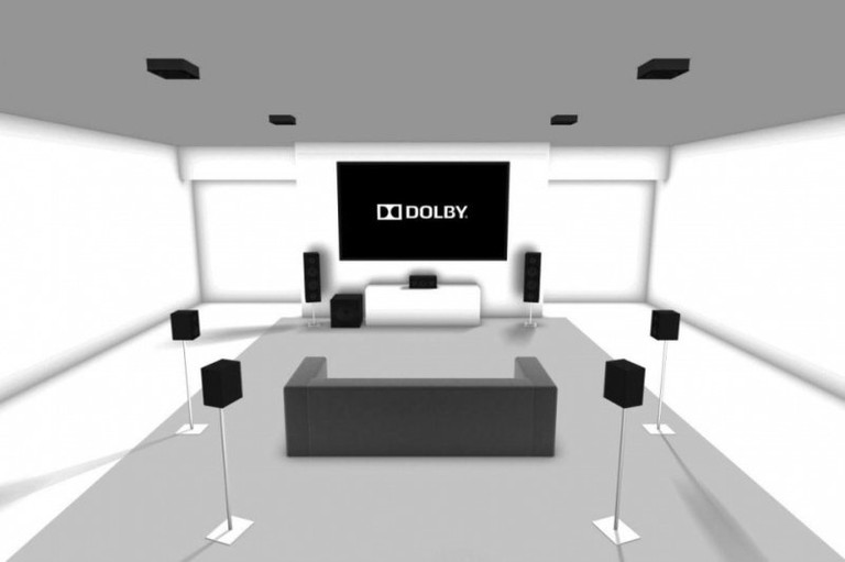

Illustration of an Atmos 7.1.4 system

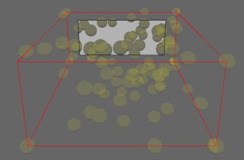

Irrespective of what consumers may think about Atmos, there’s no question that it’s a boon for the engineers who mix film soundtracks. The move to an object oriented format makes mixing for an ever increasing number of discrete channels substantially easier. The idea is simple: place objects within a 3D soundscape, and it’s up to the system to actually steer the sound to the appropriate speakers. If you’re dealing with >7 channels of audio (Atmos in the cinema can support up to 64 speakers), it’s not hard to see the appeal.
Objects
Representation of objects within a virtual 3D space.
At the same time, an object oriented soundtrack has the benefit of serving as a master mix. Regardless of whether you’re running 2.0 or 34.1 channels at home, a single object oriented mix is all you need, again simplifying the lives of mixers. Suffice it to say, even if relatively few consumers opt to purchase X.X.2 or X.X.4 Atmos setups, the format will live on behind the scenes.

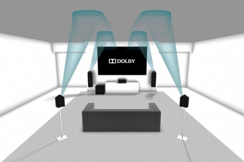

While we’ve ragged on Atmos enabled speakers a bit, there’s no denying that they make the upgrade path much easier relative to dedicated in-ceiling speakers. While you’ll still need some extra wiring and amplifier channels to make use of them, Atmos enabled speakers (and separate add-on modules) boast a driver array that fires towards the ceiling, which combined with some DSP tricks from the Atmos engine will theoretically trick your brain into thinking that sounds are coming from above you.
Atmos Enabled Speakers
Illustration of a 5.1.4 Atmos system utilizing Atmos enabled speakers.
Now we’ll be frank here: some of these speakers do look a bit chintzy to us (i.e. a couple models that feature a single 3” paper driver). However, we’re not prepared to throw the baby out with the bathwater. Implementations like that seen in the Pioneer Elite speaker line which feature a concentric driver have piqued our interest quite a bit, and we’ve heard rumors that other high end manufacturers will be throwing their hat into the ring as well.
