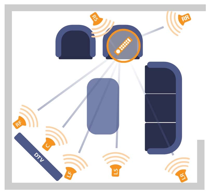

For
proper set up, knowing the speaker locations is key. Summit
Wireless accomplishes this by using ultrasonic technology to locate each speaker’s
position within a room. This solution not only is fast, accurate, reliable and
cost effective, but is also inaudible by the listener. Summit’s patented SpeakerFinder™
technology, identifies the number of speakers in the system, their location to within
one inch, assigns the correct audio channel and establishes a
default sweet spot in the center of the room. Amazingly this is all done on system
power up in less than a few seconds. Summits’ MyZone™
technology extends the ultrasonic location technology of SpeakerFinder by
embedding an ultrasonic transducer in the remote. With a simple press of a
button, the users’ location is found, and the audio sweet spot is moved to that
location by adjusting each speaker’s volume and delay instantly to the
listener’s current position
To break it down more succinctly, the Summit Wireless system employs what they refer to as a "fast set-up methodology" that works as bulleted below:
- Automatic discovery of speakers
- Automatic channel assignment
- Mapping of speaker location within 1 inch
- Automatic sweet spot configuration
- Automatic scalability from 2.0 to 7.1 speakers
- Instant
volume and time alignment adjustment from your listening position

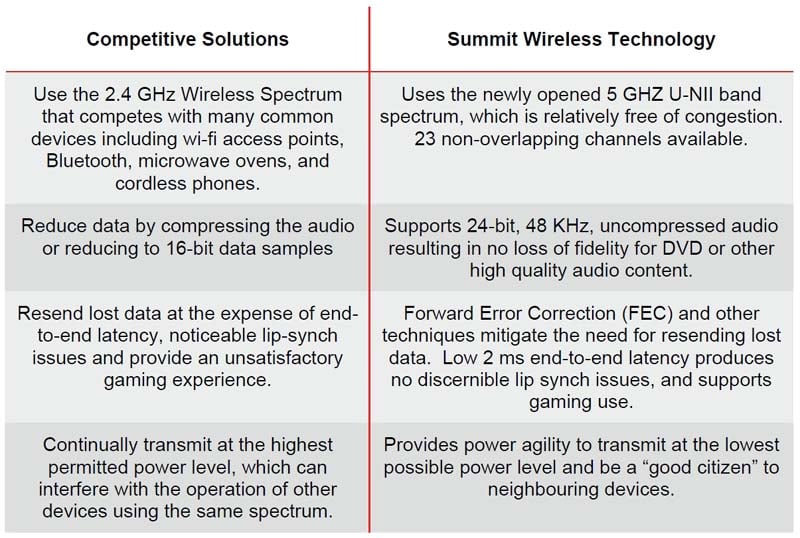

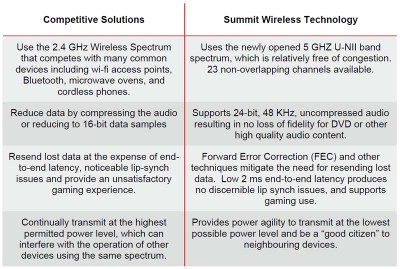

Robust Wireless Network
Today’s
wireless audio networks operate in the congested ISM bands found at 2.4 and 5.8
GHz. Congestion occurs in these bands due to WiFi, Bluetooth, microwave ovens,
cordless phones, and other equipment, and operate
with few rules to avoid interference. Typically, the loudest or strongest radio
will gain access to the frequency by overpowering all
other devices running in the same band. A limited number of channels
(3 in 2.4 GHz, 5 in 5.8 GHz) coupled with increasing demand severely
limits channel availability. Current wireless audio technologies attempt to
solve these issues by using large amounts of buffering that
create significant latency, or they heavily compress the audio signal
to reduce bandwidth needs. Regardless of technique, the end result is
poor audio with audible clicks, pops, and dropouts.
Summit delivers uncompressed HD quality audio which is scalable up to a 7.1 home theater configuration. HD audio at 48k/96k sample rates and 24-bit sample size requires a large amount of dedicated bandwidth. To accommodate the increased bandwidth Summit leverages the recently opened worldwide spectrum in the 5 GHz band, referred to as U-NII (Unlicensed National Information Infrastructure). The U-NII band offers 24 non-overlapping channels with strict access rules ideally suited for audio and video applications. For reliable reception, sophisticated error recovery and interpolation techniques are employed to ensure that all of the data from the source is received at the speaker. Using these techniques in this spectrum, Summit Wireless is able to achieve interference free audio with virtually no latency.

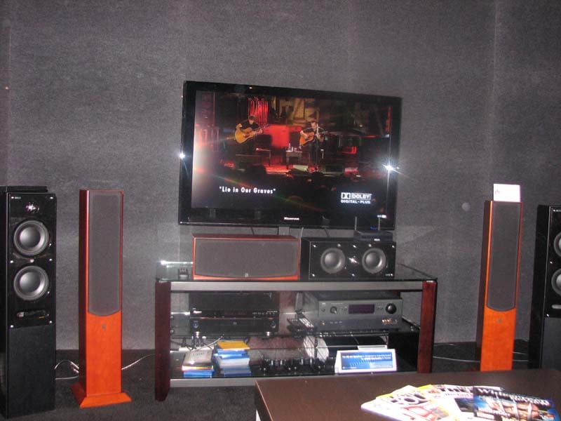

Last year I attended numerous audio demos at CEDIA.
Aperion Audio suggested I sit in on a demo of their new
wireless speakers featuring Summit Wireless technology.
I wasn’t expecting much from this wireless demo
since all of the past wireless audio solutions I’ve heard have been less than
satisfactory (mildly stated). Most of the staff from Focus that greeted
me where degreed engineers, so that gave me a good feeling that this solution
could be different. I sat down to take a listen. They put on the
Dave Matthews Live at Radio City Music
Hall Blu-ray disc which instantly won
them points. I was enveloped in the great Aperion sound we often write
about in our reviews but this time it was different. This time I was enjoying great sound without
the shackles of the cabling. I was quite taken back
from this sonic marvel I was hearing so I glanced behind the speakers to look
for hidden cables. Instead I found nothing other than the power cords
plugged into the B&O ICE amplifiers that were running each of the Aperion
speakers. WOW, a wireless solution
that doesn’t suck was the first thing that came to my mind. The
second of course was when would Aperion Audio or their competitors integrate
this marvelous technology into an outdoor speaker system for my backyard patio?
The Summit Wireless team informed me that they could integrate this solution into virtually any loudspeaker design and eliminate the need of a passive crossover, thus creating a truly active bi-amplified speaker solution with perfect driver phase and time alignment. Very cool!
They handed me the remote during the demo so I hit the calibration button and within a few seconds the sweet spot converged at my seat. It just doesn’t get any easier than that!

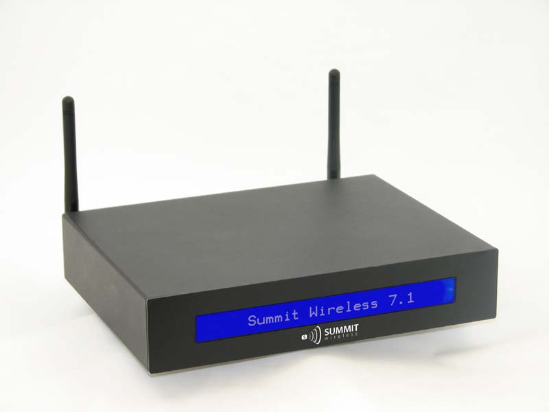

The Summit standalone box which is bundled with the speaker package includes TOSlink and coaxial digital inputs and 5.1 analog inputs. Future models will include HDMI connectivity and decoding.
