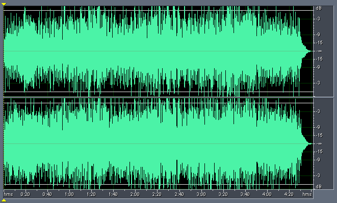

As you can see, the CD version clips in hundreds of places on a track lasting just over 4:42 minutes long. This seems hardly excusable, and is a sad indictment of the quality of mastering in the recording industry today.
This is how the waveform looks like:

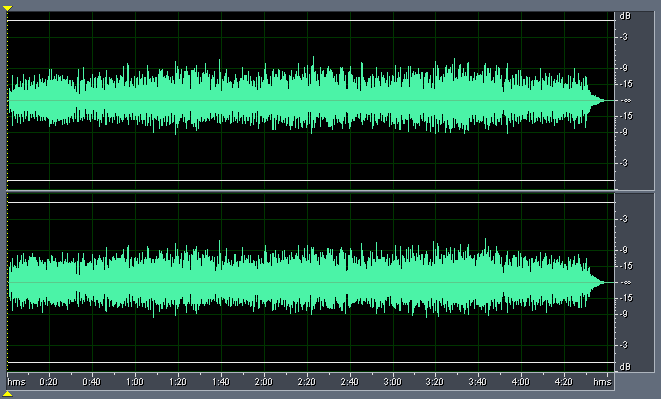

This is how the CD recording looks like:

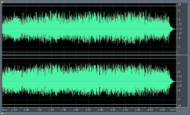

By contrast, the DVD-A recording is less compressed:
However I can still observe the instances of the clipped waveforms on the DVD-A recording. I haven't bothered showing pictures, since they look identical to the previous article.

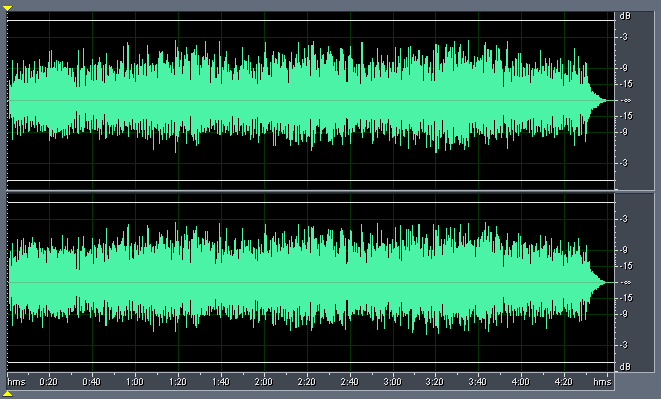

By comparison, this is the SACD recording:
As we can see, even on the same player, the SACD playback is about 4dB quieter than DVD-A. If a listener compares the two discs without adjusting for the level differences, there will be a tendency to prefer the louder version (DVD-A).
So it now looks like the differences in dynamics may be more fundamental than differences between players. Given that both DVD-A and SACD transfers come from the same analog master, the differences can now be narrowed to either the transfer process or the underlying format.
Late breaking news: After I wrote an article exploring the ability of various players in handling 0dBFS+ levels, I realised there is potentially a much simpler explanation, and it's to do with the players' inability to handle levels above 0dB FS. Given that neither the Panasonic DVD-RP82 nor the Denon DVD-2200 handle 0dBFS+ levels, the very slight reduction in relative dynamics could be due to this limitation (assuming that the DVD-A is recorded with digital samples peaking at 0dB FS). The reason why the SACD is not affected is the lower level of the recording (-6dB).
