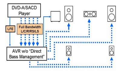

I might as well kill two birds with one stone. These first two issues are perhaps the most critical of all, in my opinion, as they severely undermine the benefits of these technologies. Currently, in order for us to enjoy a DVD Audio or SACD disc, short of buying a costly proprietary solution from Denon, Pioneer, or Meridian, the special player must be connected to your Receiver / Preamp Processor via six analog RCA type connectors (seven if a discrete rear center is included).
Bass Management for DVD-A Player
Connection Diagram for DVD-A/SACD Player to an AV Receiver (analog connections only)
Since very few Receivers / Processors have bass management via the analog inputs, you must rely on the DVD-Audio / SACD player to handle the bass management. This would be fine, except that only a few of the current DVD Audio or SACD players have bass management out of the analog outputs for DVD Audio or SACD signals. In fact, those that do, usually have limited bass management capabilities in that many of them have a fixed crossover setting between 100-120H, and/or the bass management may apply only to DVD-A or SACD on hybrid players.
only a handful of DVD-A/SACD players offer bass management
The internal bass management circuitry for a majority of these players, which is usually mediocre as best, usually only accommodates DVD Video Dolby Digital / DTS decoding. That being the case, you must realize at this point that if you are reliant on the DVD/SACD Player or your Receiver / Processor to handle the bass management for DVD Video Dolby Digital / DTS, and have bypassed the LPF of your subwoofer, you will be sending full frequency range to all your speakers, including the subwoofer anytime you decide to listen to DVD Audio or SACD software via the 6 channel analog connections. This is especially deterimental since many DVD-A/SACD discs are mixed for six full range channels, as per the specifications of these formats. Thus there is no hard requirement for a dedicated LFE channel, and thus the sixth channel is often used as an overhead channel meant to be placed above your head in a centralized location. This can basically cause a serious compatibility issue with your current 5.1 system as most of us use that channel for a dedicated subwoofer. I find this most problematic on one particular DVD-A disc from Toy Matinee. I realized this when I heard vocals and cymbals coming out of my subwoofer. The sixth channel appeared to be used as some sort of ambient overhead center channel which of course my system, as well as the majority of home theater enthusiasts systems, does not support. Because of these bass management issues, you may need to go behind your subwoofer and enable the LPF each time you listen to the DVD Audio or SACD format and pray that the other 5 or 6 channels will not be overloaded by the full frequency and dynamic range of a bass management-less system. Even worse, if the sixth channel is not mixed for LFE, you will have to connect another speaker in your system and place it God knows where, or disable your subwoofer completely. For more information on bass management, please see our many articles written on the topic.
