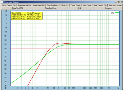

inputting the driver’s T/S parameters from the data sheet into SoundEasy, various

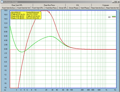

cabinet volumes and tuning frequencies were modeled. The figure below shows the system response
for a 2.2 cubic foot vented enclosure tuned to 27Hz in red and a 2.2 cubic foot
sealed enclosure in green.
10” Woofer Ported Versus Sealed Response
The 2.2 cubic foot vented cabinet tuned to 27Hz was selected even though it represents a slight misalignment. Although a tuning frequency of 22Hz would have resulted in flatter response, the cabinet design limited the length of the port tube as lower tuning frequencies require longer ports. Note here that the sealed alignment in green would yield a pretty flat in-room response and is probably a better overall choice for many listeners. However, our goal of +/-3dB from 35Hz to 20kHz and high SPL could not be realized with a sealed enclosure. Most people have heard a woofer or two bottom out and it is important to consider how much abuse a woofer can take before employing it in a design. Once the T/S parameters are input and the enclosure is modeled, SoundEasy allows a designer to analyze acoustic phase, internal acoustic pressure on the box, port air velocity, group delay, phase and system sound pressure level. The Peerless woofer used in this design has a linear excursion of +/- 12.5mm. Below is a graph showing the expected cone excursion with a 150 watt input signal with the vented enclosure in red and the sealed enclosure in green. Note that this power level yields over 105dB sound pressure level before the driver rolls off for both enclosure types.

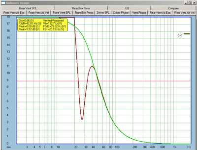

10” Woofer Ported Versus Sealed Excursion
Clearly, vented enclosures allow significantly more power handling above 20Hz but there is no free lunch here. Group delay is severely affected by the vented alignment and this means that vented enclosures are sometimes considered to have a less desirable transient response. Considering the majority of music content is above 40Hz, the group delay for the vented enclosure will suffice for this project.
10” Woofer Ported Versus Sealed Group Delay
At this juncture, it is important to note that the T/S parameters from the loudspeaker manufacturers do not always match the actual T/S parameters. Many loudspeaker design programs and other tools allow extraction of the T/S parameters. If precision is key and you do not want to risk cutting cabinets or ports twice then it is important to determine the actual T/S parameters of a loudspeaker before moving forward with the design. It is often useful to model response using the manufacturer’s data sheet for a ballpark before purchasing a driver and then measure the actual T/S parameters before proceeding with the design using a program such as SoundEasy or Dayton Audio’s WT3 system.

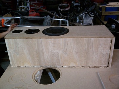

This project was designed in SolidWorks but could easily be done in Google SketchUp. The 3D CAD programs allow for easy calculation of internal volume and are really handy for test fitting drivers and ports before building the cabinet. I once designed a simple sub cabinet but didn’t realize the port length would interfere with the driver until the cabinet was finished. I ended up rerouting the port using a series of bends that ended up causing port noise when the volume was cranked.
In this project, we used 3/4” Baltic birch with a 3/4” MDF baffle and bottom plate. This was selected because the loudspeaker sides were subsequently covered with album covers and Lexan for a unique finish. The panels were cut using a table saw and all chamfering and circular cutouts were completed using a quality plunge router. A circle-cutting jig is a worthwhile investment as it provides accurate results in short order. The bottom of this speaker is removable with weather stripping between the detachable bottom and the rest of the cabinet. A bottom firing port is attached to the bottom plate, which requires 2-3 inch long feet or spikes for clearance. Although it is probably obvious, it is highly recommended to test fit everything before final assembly. When test fitting drivers, it is a good idea to drill holes and use hurricane nuts to allow secure mounting and remounting of drivers. It is also recommended to use biscuit joints when gluing panel walls together although it is acceptable to use screws to hold panel walls together for gluing. Once the glue is cured, all screws should be removed. For this project, the baffle, bottom and back of the speaker were spray painted. Spray painting MDF is time consuming because it requires several iterations of sanding and painting to obtain a smooth finish since MDF absorbs some paint, especially on corners that are rounded over. Finally, album covers were glued to the cabinet and the covers were protected with a thin layer of Lexan.

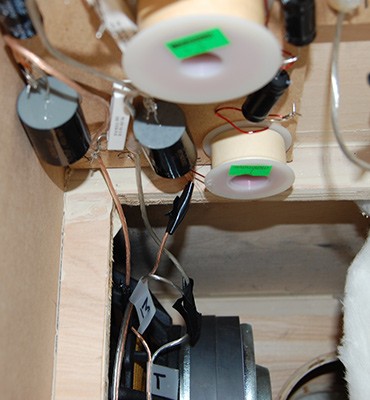

Before designing a crossover, the cabinet must be fully assembled including ports and drivers. I typically run a separate speaker wire from each driver out of the port and label each wire. For sealed loudspeakers, connect the woofer to the binding post as this is the first driver measured in the cabinet. Using SoundEasy, each driver is measured in the cabinet to obtain frequency response and electrical impedance. These parameters are obtained following the test methodology outlined in our Loudspeaker Measurement Standard. Please note that any measurements taken near field must factor in the effects of baffle diffraction. SoundEasy allows modeling and application of baffle diffraction estimates to any frequency response data. Getting good measurement data is one of the hardest parts of loudspeaker design. It is crucial to validate your results by taking measurements using both near field and quasi-anechoic gated techniques and compare the measurements before proceeding. The measurement data is subsequently used in SoundEasy’s crossover design tool.
DIY Crossover Installed in Cabinet

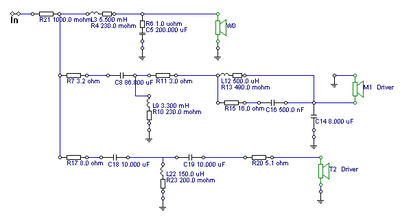

Although CAD has come a long way, designing a loudspeaker crossover benefits from some background in electronics. SoundEasy has 2-way to 5-way crossover templates covering 1st order to 4th order crossover topologies. Additionally, there are templates for a wide array of typical filters and compensation circuits. The CAD framework allows implementation of any circuit or filter topology imaginable so long as it uses inductors, resistors, capacitors, operational amplifiers, potentiometers or logic gates. If you have not ever studied filter design or do not know what the previously-mentioned elements are, you may want to consider studying up to improve your chances of pulling off a working and affordable solution.
The first step I take when designing a crossover in SoundEasy is to determine workable crossover frequencies and filter orders. This requires careful inspection of the driver data sheets, frequency response measurement and driver impedance. It is imperative to make sure that response anomalies, such as the breakup of a metal cone driver, are sufficiently attenuated by the crossover so that they are not audible. It is generally a good idea to keep the crossover frequencies low enough to prevent driver beaming but high enough to prevent driver failure. For example, crossing over most tweeters below 1.5kHz is a bad idea if it is meant to play program material at 110dB or has a resonant frequency above 750Hz. Crossing an 8 inch bass driver at 5kHz will result in poor dispersion and transient response at higher frequencies. As a rule of thumb, the max frequency for a given driver diameter can be equated by taking 13560 and dividing it by the drivers effective diameter. For an 8” driver with an effective cone diameter of 7”, this means that the maximum crossover frequency should not exceed 1937Hz.
A 4th order crossover rolls off frequencies at 24dB per octave where as a 1st order crossover rolls off frequencies at 6dB per octave. Lower order crossovers have less phase shift but tradeoff power handling and masking out of band response anomalies. The designer has to determine the best set of tradeoffs for an intended design goal. SoundEasy has built-in filter templates for delay networks if a designer desires to design a time aligned loudspeaker for higher order filters. It is also important to note that the filter order does not have to match for each driver in a system but it does simplify the design.
Once approximate crossover frequencies and filter orders are determined, a filter can be developed in CAD. For the purposes of this design analysis, a 2nd order crossover was designed which approximately matches a Butterworth filter target. Additional response shaping elements were added where needed to meet the design requirements. This circuit was determined based on using a 2nd order low-pass for the woofer, band-pass for the midrange and high-pass for the tweeter. Due to the response anomalies and differences in sensitivity, additional elements were added. The final circuit design is shown below.
Crossover Circuit in CAD

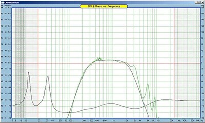

The component values for the circuit design are determined using SoundEasy’s ingenious optimization technique. It is as simple as setting a target response for a single driver and selecting the components SoundEasy should manipulate to attempt to meet the target response. In this example, a 2nd order Butterworth band-pass filter target was setup in the optimization dialog as shown in black in the figure below. SoundEasy will modify the selected crossover components and employ trial and error to arrive at the optimum component values required to meet the frequency response target. The optimization technique will attempt thousands of combinations and may be run multiple times to determine the best component values. While running optimization, it is important to pay attention to the component values set by SoundEasy because it may set values that are very high inductances or capacitances and therefore expensive. This may take some playing around to get right. If you are unable to get close to the target curve you might consider changing the filter topology. The midrange for the sample project tracks the target curve pretty well but is not perfect at the high frequency knee due to response problems with the driver itself. It is possible to shape the response further but more crossover components equate to a more expensive crossover. It is easy to spend hundreds or even thousands of dollars on crossover components. It is often better to solve extensive frequency response problems with better drivers or a more in-depth diffraction analysis.
Midrange Crossover Optimization

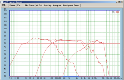

The optimization process is applied to the low-pass, band-pass and high-pass filters and a combined response is generated. Due to response issues, it may be necessary to attenuate a target or move the crossover frequency slightly to obtain a flatter response. Ultimately, it may take several rounds of moving crossover frequencies and even filter orders to get to an acceptable system response. The combined system response after optimization for this design is shown below.
3-Way Crossover Summed Response
During the design process, it is important to pay close attention to system impedance graphs. It is no fun perfecting frequency when your design has a minimum impedance of 1.5 Ohms. SoundEasy has an option to set the minimum acceptable impedance during optimization to help reduce the risk of developing a network that dips too low for the amplifier you are using.

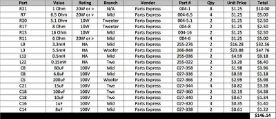

As a final step, it is absolutely necessary to set the values of capacitors, resistors and inductors in the CAD editor to values you can actually purchase. This usually involves rounding up or down to values you can purchase. If the crossover parts are expensive, you can attempt to reduce component values and subsequently plot their effect on the final response. This is time consuming but can save you a ton of money. A 3-way crossover of this complexity is not cheap. Using cheap electrolytic capacitors this crossover costs close to $150 for components alone.
3-Way Crossover Bill of Materials

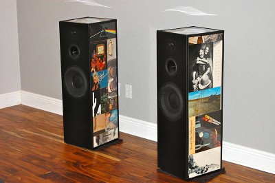

DIY speaker Finished Product
Ultimately, designing your own loudspeaker is something you do because you like the creative side of designing things. If you are after bang for your buck sound, it is much cheaper and less time consuming to use someone else’s well-established and well-documented DIY design with pre-fabricated cabinets.
