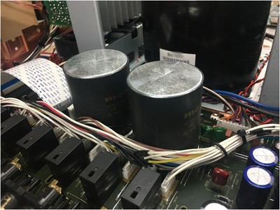

Marantz SR8012 Top View (left pic) ; Power Supply Caps (right pic)
Marantz SR8012 Advantages over the Denon AVR-X6500H:
- HDAM SA2 current feedback topology between preamp and power amp
- 22,000uF, 81V capacitors x 2 vs 15,000uF, 73V capacitors (X-6500H)
- Torodial 835VA transformer vs 750VA E-Core (X-6500H)
- Separated symmetric construction vs single in-line (X6500H)
- Copper plated chassis
- More rigid top cover
- Teflon tape on oscillator circuit for better damping
In my opinion, these are all noteworthy improvements and a justifiable upgrade path if you're a serious audiophile and plan on using the internal amps of this receiver to drive your entire speaker system.

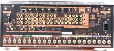

Marantz SR8012 Backpanel View
The SR8012 is equipped with an arsenal of connectivity including 8 HDMI 2.0/HDCP 2.2 HDMI inputs and 3 outputs, component video connectivity for legacy devices, 11 pairs of speaker outputs to run a fully amplifier 7.2.4 speaker configuration and a detachable power receptacle. The SR8012 also features 11.2CH preamp outputs incase you want to use external amplification for ALL channels. It even has a 7.1 multi-ch input should you ever have the need to run an older legacy SACD or DVD-A player that support HDMI.

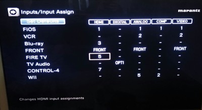

Marantz SR8012 Input Assignments
The SR8012 has some of the most flexible input assignability I've seen in an AV receiver, rivaling even some dedicated AV processors. Unlike many competitor products, you can actually assign analog and digital ports to ANY input instead of having prescribed HDMI ports assigned for specific inputs. This came in handy when I was integrating and configuring my Control4 home automation system.

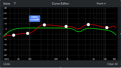

For those that want more control over the calibration, the Audyssey editor App allows owners of compatible Denon and Marantz receivers to customize the curves and limits of correction. This is an invaluable tool in your calibration bag of tricks.

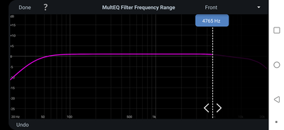

Audyssey EQ Editor App - screenshot taking from mobile device
Note how the correction is limited to < 5000Hz (bottom pic)
This app allows users to:
- View the Audyssey MultEQ speaker detection results, to check and modify the configuration, and adjust for any unusual speaker set-ups
- View before and after results of the Audyssey calibration, making it easy to identify room problems and see just what changes the system is making
- Edit the Audyssey target curve for each channel pair to suit individual tastes
- Adjust the overall EQ frequency roll-off for each channel pair
- Switch between two high-frequency roll-off target curves
- Enable/Disable midrange compensation to make the sound brighter or smoother, perhaps making dialogue even clearer or taming those hard-edged soundtracks
- Gives the home theater enthusiast even greater control over the performance of their surround sound system
- Save calibration results for ‘piece of mind’, ready for instant re-loading should one ever need to reset their system

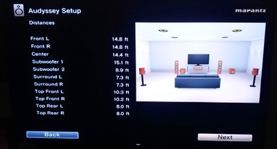

It took about 20 min to run Audyssey in my 5.2.4 setup using 6 mic positions, with 3 at the primary couch and 3 in front of couch. I always kept the mic positions within a 3-ft radius of the primary measurement position as recommended by Audyssey. Never just randomly place the mic around the room for calibration, else you will get very unpredictable and inaccurate results. If you have a side couch, don't calibrate it. Instead focus on the most important seats that are in close proximity to each other for best results.
Audyssey nailed speaker distances and only needed minor tweaks in levels. It set subs too low, so I boosted it about 4dB for the front sub and 6dB for the back sub. During the step when Audyssey makes you set the subs within the green range of 75dB, I'd set it towards the higher side towards the red zone and continued with the calibration.

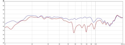

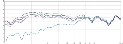

Frequency Response @ Primary Listening Seat with Audyssey Engaged
Red Trace - Audyssey, Purple Trace - phase tweaked on both subs to improve response
I had to adjust phase of both subs to 90 deg to optimize bass response in the 50-100Hz region. This is something you may want to get optimized prior to calibration, since Audyssey has no control over manual adjustments from your subwoofer(s). Audyssey did find the best subwoofer distances, which is critically important when trying to get the best blend between the subs and satellite speakers.

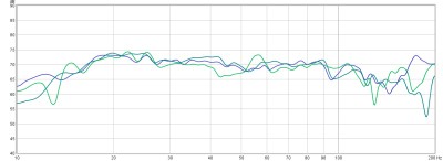

Frequency Response @ 3 Primary Seats with Audyssey Engaged
Despite the fact that my dual JL Audio E112 subwoofers aren't exactly optimally placed in my family room (diagonal corner positioned), with the help of Audyssey, I was able to achieve 18Hz to 100Hz +-5dB across the 3 primary seats in my family room. This is the best bass response I've ever measured in this room!

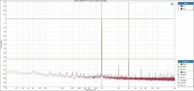

I was unable to do a preamp frequency sweep exceeding 1.2Vrms as it tripped the protection circuits since the power amps were still engaged and exceeded full rated power (140 watt/ch, 8 ohms, Av = 29dB). Unfortunately, Marantz doesn't offer a preamp only mode to disconnect the power amp from the circuit if you're using only external amplification. This is something I'd like to see ALL receiver manufacturers offer that include preouts to avoid this very problem I noted. It would also be more energy efficient as well. We will be testing this on receivers going forward and lobbying the manufacturers to include a preamp mode if they already don't. Please note it's unlikely you will ever run into a problem driving external amplification as normal program material doesn't behave like continuous sinusoidal sweeps like what was used on my bench tests.
At 1Vrms, the FFT of the SR8012 was good but I was surprised at the 3rd order harmonic byproduct that was about 3dB higher than I observed on the Denon AVR-X3300W prior but it was very low at .0018% THD. Still the noise floor (-140dB) of the SR8012 was exceptional as you can see in the FFT below, almost -20dB lower than I measured on the Denon AVR-X3300W.
Marantz SR8012 Preamp Out FFT Distortion Analysis @ 1Vrms

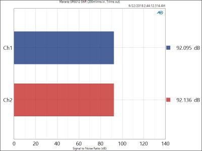

Marantz SR8012 Signal to Noise Ratio (1Vrms) - Pure Direct
The SR8012 preamp output exhibited a low noise floor (92dB unweighted, 100dB A-wt) with 200mVrms input drive and 1Vrms out. This is excellent.

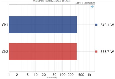

Marantz SR8012 Dynamic (2CH) Power Test - 4 ohms
The SR8012 performed well for CEA 2006 short dynamic burst tests by delivering 336 watts/ch with 2CH driven at 4 ohms and over 165 watts/ch with 7CH driven at 8 ohms.

Marantz SR8012 CH-CH Crosstalk (1CH, Undriven)
The channel-channel crosstalk was excellent for a multi-ch receiver, especially one packing 11 channels of amplification. With ACD except for the one under test, the SR8012 provided > -60dB of CH-CH isolation.

amp section again. The SR8012 brings me back to my fond memories of the SR18
from yesteryear. The build quality is top notch as can be seen with the large
torodial power supply, and dual heatsinks with monolithic amp construction and
premium grade parts throughout the chassis. It has plenty of power to drive all
but the most difficult speakers in the largest of rooms. In those cases, you
could always make use of the pristine preouts to power up to external
amplification.

SNR | ![]() ![]() ![]() ![]() ![]() |
