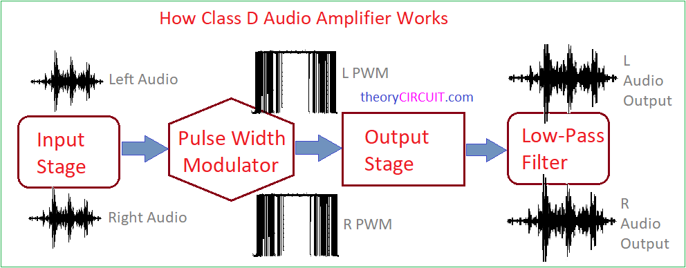

Class D Amplifier Block DiagramClass D amplifiers are gradually replacing class AB amplifiers for  their higher efficiency. These amplifiers have a filter capacitor connected directly across the output to remove ultra-sonic switching noise. These capacitors also absorb a fraction of energy at 20Khz, which they are rated to do under real world conditions, but if stressed by a sustained 20KHz full power tone may over heat or need to be up-rated, needlessly increasing cost and physical size.  amplifiers protect against this by shutting down when a continuous high-power high-frequency tone is detected. Such conditions normally do NOT occur during real-world music or movie program material. This useful and intentional protection can put these amplifiers at a significant disadvantage compared to traditional Class AB amplifiers when tested at the upper frequency range, particularly at 20 kHz for a full five minute duration. As a result, such amplifier designs may be significantly derated in power, despite the fact that many of these designs can potentially offer more dynamic headroom and higher sustained output power than their less efficient Class AB counterparts when multiple channels are driven. Even most Class AB designs are usually limited in power above 10KHz. This rule will result in the majority of amplifiers simply being rated for the maximum power they can sustain at 20KHz, while quite ironically, this is the frequency band that demands the least power in real-world use!

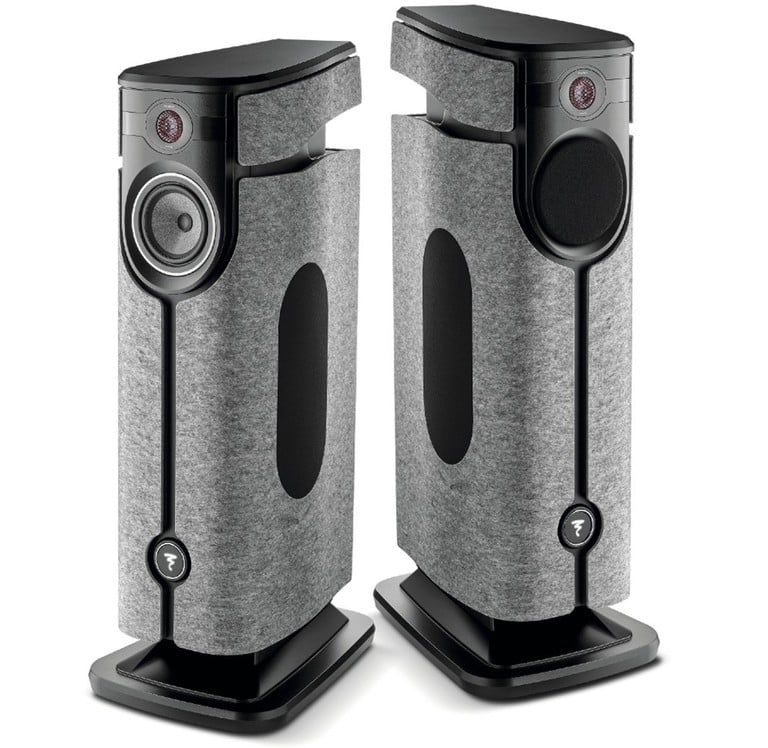

Watt About Powered Speakers?
Focal Diva UtopiaPowered speakers and subwoofers are considered closed systems and in our opinion, rating amplifier power is meaningless since the actual SPL output of such products is dependent on system efficiency and driver sensitivity. In an active speaker/subwoofer, the amplifier only needs to be as capable of delivering power as the voice coil is capable of taking it. What instead should be rated for such loudspeaker products is system bandwidth, and max SPL at rated distortion. More work needs to be done here to perhaps align with the efforts of the Consumer Technology Association (CTA) who commented extensively during the rule making process on the need to reconsider the proposed standard test conditions as well as the required and optional disclosures.
