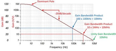

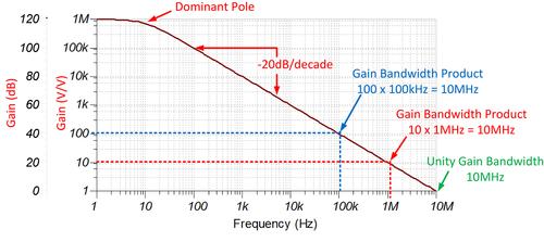

Amplifier Feedback Actually Increases Bandwidth

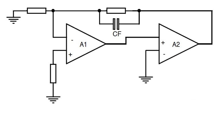

Designers quickly found out that “just adding more feedback” is actually a hard core engineering problem. The basic methods from the 70’s were limited by the speed of the power transistors. Gradually designers discovered ways of increasing feedback without needing more bandwidth. The easiest and most common is nesting a local feedback loop inside a global one. Even though both are individually limited by bandwidth, the two combine together to make a large amount. This was a major victory. Sadly by now (the early 80’s) feedback phobia had already become audio gospel. So, manufacturers decided to hide the fact that they had just massively improved sound quality by adding a lot more feedback. Instead, the myth was softened to say “use mostly local feedback and avoid too much global feedback”.

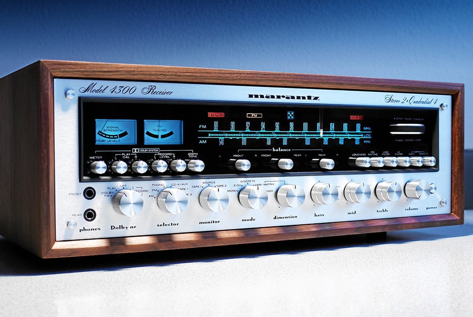

In the early 90's I was quite fond of a Pioneer VS-X4500S 100wpc receiver I had powering my JBL LX-44 speakers. I remember reading the spec sheet which boasted a vanishingly low distortion something like .008% THD+N. As a budding student studying electrical engineering, I thought this was truly a SOTA design until I brought home a Rotel 2CH amplifier with a much higher distortion rating. The Rotel absolutely spanked the internal amplifiers of my Pioneer. The bass was much tighter and the sound was much cleaner and more dynamic. I didn't have test gear at the time to measure what was going on but I recalled a tech at the hifi shop I worked for declared my Pioneer "used too much negative feedback". I didn't even question this assertion and it took me years to overcome my fear of "too much negative feedback" in amplifiers. It wasn't until Bruno and I discussed this topic at length that I realized that Pioneer probably didn't have that much feedback after all.
This was helped by the fact that getting the equivalent amount of feedback with a global loop alone is not at all obvious. Reliable methods are math heavy and were only developed in the 90’s by designers of sigma-delta ADC and DAC chips. Naturally unburdened by feedback phobia, some of them turned their attention to class D amplifiers. Even then it took a surprising amount of work to mature the technology. The current high degree of acceptance of class D amplifiers in hi-fi is almost entirely due to work on feedback loops, so feedback avoidance has not much traction in class D circles.
