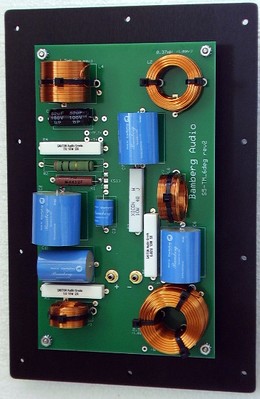

The most obvious visual cue is simply size. A small cheap crossover is just that. Small and cheap.
Poorly designed crossover (left pic); a high quality crossover (right pic)
The crossover (above left pic) is from a two-way bookshelf speaker system we have previously reviewed. The speaker system employs a stiff cone driver which has no crossover circuit (namely a LPF) to limit its bandwidth to reduce its audible break up modes at higher frequencies. The manufacturer chose to use an electrolytic capacitor as a measure of cost savings at the expense of performance as these parts have higher resistance and performance variances than quality and more costly poly designs. This is bottom of the barrel crossover design unbecoming of any serious loudspeaker design, despite the claims of “science and research” behind its products. At low power levels these speakers don't sound bad but once the volume is cranked up, audible driver break up was identified by our panel of listeners in blind comparisons.
The crossover image (right above pic) is of a much higher caliber design by an engineer making no outrageous claims. Instead, the engineer understands the importance of proper crossover design and execution to get the most out of the drivers. The designer invested an appropriate portion of the budget of his product to arguably one of the most important aspects of the speaker design – the crossover. Notice how air core inductors are used in critical circuit paths and they are properly oriented and spaced from adjacent magnetic inductors to avoid unwanted cross coupling.
The tweeter circuit runs vertically up the left side of the photo. The woofer circuit is on the right. You can see how the inductors are located in the corners, while the smallest inductor is in the middle of the board. Tweeter/woofer nearby inductors are oriented at dual-right-angles with each other. There literally is more woofer/tweeter crosstalk from single-wiring than there is through the inductor mutual coupling.

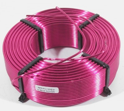

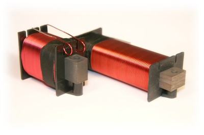

Myth # 2 – Magnetic core chokes are as good or better than air core chokes because they offer a lower resistance for a given inductance.
Audioholics has already published a series of articles on the ills and compromises associated with the use of magnetic cores in inductors. Inductors used in crossovers are usually by far the most expensive parts of the least visible and unfortunately most neglected parts of a speaker system, the crossover.
Air Core Inductor (left pic); Steel Laminate Core Inductor (right pic)

If the listener does not push the system to a high output level, OR if the drivers used have considerably more distortion than is added by the use of magnetic core chokes, then it is a reasonable compromise to be made in a system with a tight budget. It does not follow because any set of listeners fail to detect a measurable difference due to cheap crossover parts that this is a difference which is “inaudible”. It simply means the rest of the system is distorting so badly that the distortion added by magnetic core chokes in the crossover is hidden by other distortions which mask it.
Given the high levels of measured distortion noted in our article: The Crossover: The Brains of the Loudspeaker Part II
The inability to hear this distortion would not constitute much of a recommendation for the speaker under test, or the listener doing the testing who swears he or she cannot hear the difference. “There has never been any shortage of people willing to claim a given level of distortion was inaudible” - Dave Hadaway, DB Systems
The argument is sometimes made that a lower impedance driver is more affected by changes in DCR of a coil than a higher impedance driver. This assumes the Re of the coil is constant, but it’s not which is paramount. Is it the ratio of Re in the crossover coil to Re in the voice coil that matters. Magnetic cores are chosen over air cores because of size and cost, not performance.

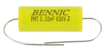

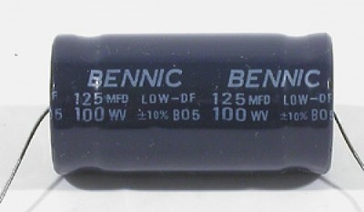

Myth #3: There are no Advantages of using Polypropylene or Polyester (Mylar) capacitors over Non-Polar Electrolytic Capacitors in a crossover.
It may be that your box is so very small that trying to put a 25 uF Mylar capacitor in two places on your crossover along with those big heavy large diameter wire air core chokes makes the PCB (printed circuit board) SO big you can't fit it through any of the holes in your box. (I know because I have done it!) That said, an electrolytic capacitor will ALWAYS consume more power, run hotter, and have a shorter working life than a film (i.e., mylar, polypropylene, Teflon, etc.) capacitor of the same value and voltage rating as an electrolytic. That said, NO electrolytic made will work as well in a crossover as a film capacitor. However, their advantages over film are twofold:
1) Size (much smaller for a given value and voltage) and
2) Way less expensive than a film capacitor.
Metallized Polypropylene Capacitor (left pic); Electrolytic Capacitor (right pic)
This does not imply in any way that all electrolytics are created equal. They can be made with less packing density (capacitance per volume) and less loss (dissipation factor or DF for short.) While pretty much everyone uses electrolytics, it is always a decision based on size or budget or both, but many designers feel their use compromises performance.
Manufacturers that truly care about the sound quality of their products typically won’t use electrolytic capacitors in series with a tweeter. Unless the higher inherent DCR is desired in the circuit path of the crossover, they should typically be bypassed (connect in parallel) with smaller value film capacitors to greatly minimize the disadvantages of the electrolytic capacitors if used alone. If you ever get to take a peek inside of a loudspeaker you’re considering buying, looking closely at the quality of the parts and how they are implemented speaks volumes. We are not advocating the usage of uber expensive esoteric parts touting questionable performance characteristics. However, quality vs bad performing parts is easily quantifiable.

Editorial Note by John L Murphy on Electrolytic Capacitors
If you elect to use electrolytic capacitors in a loudspeaker you take on a bit of an obligation to make sure that your loudspeaker does not become a fire hazard when operated at its rated power for long periods of time. Capacitors that operate safely at modest sound levels can rise in temperature quickly as the input power is increased to become actual fire hazards. Always check the temperature rise on ‘lytics. This is not a lesson you want to learn the hard way.
Editorial Note by Phil Bamberg
In some networks I use a single electrolytic cap in the RLC string placed across the tweeter terminals to flatten the resonant hump in the tweeter impedance curve. Typically this cap is around 50 microfarads – neither a small or large value. It is effective below around 500Hz, where the SPL is also far down in level. Placing a cap in series with the midrange driver may require a large value if the driver impedance is high, and/or the cross point is low. In such a case, a polypropylene cap is desired. But the large component value truly adds to its cost (tens of dollars).
Bottom Line: Electrolytic capacitors are cheaper than air poly or mylar parts so the loudspeaker engineer must pay extra care in design to ensure critical series circuits are bypassed with better parts in order to reduce deleterious effects caused by such parts if used within their crossovers. Using tight tolerance parts (5% or better) ensures consistent performance from speaker to speaker but many manufacturers skimp here solely for cost savings.

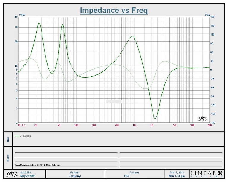

Impedance Graph of Poorly Designed Crossover Network of “High End” Bookshelf Loudspeaker
Here is an impedance graph of a pair of $2k/pair bookshelf speakers I was working on a review for. These speakers sounded pretty good but they kept shutting down our reference Marantz PM-11S2 200wpc Integrated Amplifier at high output levels during our listening tests. An impedance sweep of the speakers revealed a huge crossover design flaw as you can see by the 2 ohm dip at the systems 2kHz crossover frequency. This appears to be circuit resonance by incorrectly placing two components in parallel with each other. The speaker system was also tuned too low for a two-way bookshelf speaker using the driver they employed as you can see by the 40Hz saddle point in the impedance graph. Not only was the woofer bottoming out at around 75dB at the listening position, but even when we limited the bass output to the speaker, it was shutting down our amplifier because of the nasty 2kHz impedance dip. Sadly the manufacturer used all high quality parts and drivers and most notably beautiful cabinetry, but they didn’t properly execute the system design.
The dip seen at 2kHz is typical for a tweeter that needs some boost near the crossover frequency. In other words, there is essentially no resistance necessary in series with the first shunt coil in the tweeter network. If the tweeter needs to be padded down some, in order to better match the midrange efficiency, then there is an alternative method that both accomplishes the level matching and keeps the impedance high in this band. I believe that a good designer always “keeps one eye on the impedance” during crossover system design. While there may be an infinite number of circuit topologies that lead to virtually identical SPL responses, many are still not friendly from an impedance aspect. Below is the impedance curve with an easier impedance load. The 3kHz minimum impedance is still there for this different speaker, but it is now up at 5.5 ohms.

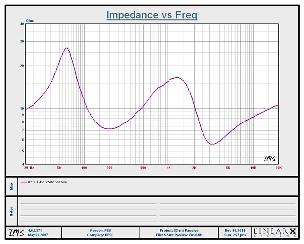

System impedance for properly designed 2-way bookshelf loudspeaker
The lesson here is that high quality parts and layouts are themselves no guarantee of success. An inept design will cancel out the advantage of superior components.
Bottom Line:
A trained observer can tell a great deal about a loudspeaker by just looking at the impedance and phase plots it produces. While we don’t hear what we measure from an impedance plot, it can predict how well a speaker will perform when being powered by a wide variety of amplifiers.

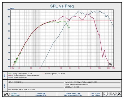

Raw driver response for 7” woofer / 1” dome tweeter 2-way bookshelf Loudspeaker
Here is the raw (no crossover) woofer (blue line) SPL graph for a 7” woofer and 1” dome tweeter (green line), mounted in a sealed 1/2cF cabinet. The thin red line was curve-fit to the woofer’s bass response, and level matched up to 200Hz. It also represents the predicted final speaker sensitivity of about 86dB. Venting the box at about 40Hz tune frequency could lift the middle bass by about 3dB, but there will be no lift at 200Hz. No matter how the 2kHz crossover is designed, it won’t impact the woofer’s output at 200Hz. Therefore it is important to “tilt” the rising woofer response back to level, starting at 200Hz. The thin brown line represents the woofer response with only a single 1.5mH coil in series with it. Notice how the woofer response is unchanged below 200Hz, but that it is also tilted down by up to 5dB at 1kHz. The tweeter is at least 6dB more sensitive than the woofer, and will have to be padded down.

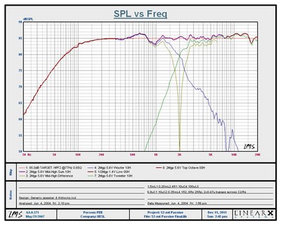

Final (with crossover) response for 7” woofer / 1” dome tweeter 2-way bookshelf Loudspeaker
Here is the same speaker, measured with the final 12-part crossover in place:
- Woofer/tweeter summed response is shown by the bold purple line. System sensitivity was reduced to 85dB to account for the losses from the two coils in series with the woofer. Cross point is exactly 2kHz. Phase coherency is proven by a flipped-polarity test measurement (shown by the thin gold curve). Final amplitude accuracy is +/-2dB.
- The bass response of the woofer is unchanged, but it is now level throughout the midrange. The woofer’s primary 4kHz peak is now 15dB below reference level.
- The tweeter output has been reduced to match the 86dB sensitivity. It is 25dB down from its raw output level at 1kHz, showing good tweeter protection during loud playback.

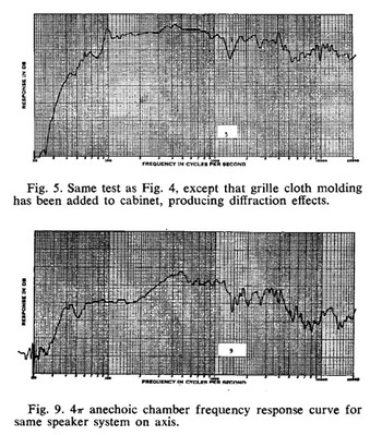

Regarding half-space measurements, they originally were the result of Acoustic Research’s (AR’s) exhaustive measurements back in the 1960’s. AR was one of the first speaker companies to do detailed, repeatable scientific speaker measurements and publish them with accurate explanations that the average consumer could understand. Back then, many speakers were in fact mounted on “bookshelves,” with books all around the speaker, constituting a measurement environment that did, indeed, approximate a true 2 Pi (half-space) environment.
When that same speaker was mounted on a stand somewhat away from the major room surfaces (the side wall, the wall behind it, and up from the floor below it), the speaker would exhibit what today we call the “baffle step” phenomenon.
The above curves of the famous AR-3a from 1968 clearly show that. In the top figure, the 3a is in a pure 2 Pi environment (“bookshelf,” surrounded by books), and its LF-to-midrange response is smooth and predictable.
In the lower curve, the 3a is stand-mounted away from the walls. You can clearly see the lowering of the woofer’s response level as the frequency transitions from a 2 Pi environment (in the midrange, where the speaker’s baffle is large enough to provide that environment) to a 4 Pi environment in the lower bass. Interesting that AR recognized this and identified it in 1968. They were ahead of their time. But not until Roy Allison’s Allison speakers of 1974 were there speakers that took this into specific account. Allison’s 1973 AES article The Effect of Room Boundaries on Low Frequency Power Radiation is particularly illuminating.
