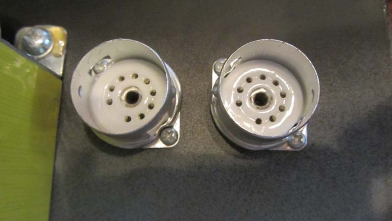

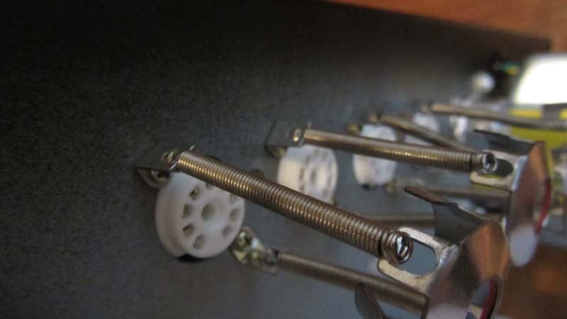

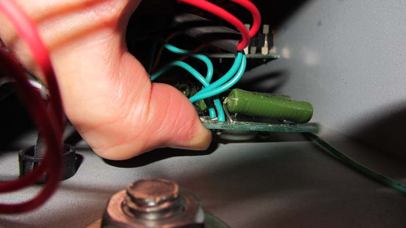

  • Power tube connectors poorly supported, directly mounted to PC boards and only one tiny set screw

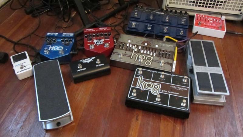

When searching for the perfect budget minded Guitar Amp, the factory direct US Master’s TVA30 rivals most of what’s out there in the local retail outlets. Although I’ve been playing guitar for nearly 30 years, I’ve spent the past 6 months obsessing on upgrading my equipment in order to stretch the envelope and to define a unique, out of the ordinary sound. I already had two custom made electric guitars with what I consider, very high end active pickups from both Bartolini and EMG, each guitar also having Piezo Electric pickups with separate output for running through a second acoustic guitar amp. Both guitars have through body necks for maximum sustain, one being made in California, the other right here in Orlando.
I’vepedals.jpg most recently gone through countless effects pedals to further define that unique sound. From distortion to chorus to synthesizers and even polyphonic octave generators, I’ve tried tons and settled for only the ones that I found to be best for that signature sound. Most recently, I turned to improvement of my guitar amplifier. This time, I knew I wanted to go all analog and have the best tubes and electronics available, my only limitation being budget. I also wanted to limit the weight because I needed my new amp to be portable without breaking my back. I held very little interest in going mainstream knowing that these mass produced products would sound exactly like nearly everyone else playing today. So I started my website search with terms like, “Customer Guitar Amp,” “Handmade Guitar Amp,” “American Made Guitar Amp” and so on. I was actually surprised to see the number of high end guitar amps that are out there. Regretfully, none of them see the light of day at the Nationwide Music Stores, and some only sell direct, meaning I didn’t have an opportunity to listen unless I purchased. What I also noticed was that the vast majority of these uncommon amplifiers were in the thousands of dollars, and after contacting many, some had waiting lists several months long. There was; however, an exception to this and it caught my immediate attention, warranting further investigation.

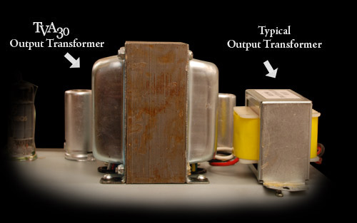

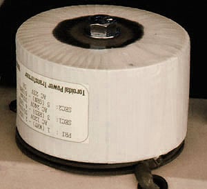

The TVA30 cabinet and head arrived only three days after ordering. Without hesitation I carved my way into the boxes quickly looking at the back of the amp head to see firsthand, what the hype was regarding the electronics. Normally, I wouldn’t post a Manufacturer’s marketing pictures in a review; however, after studying so many amps, I found their claims and these pictures to be valid and justifiable. This amp head was clearly a beast among the norm.

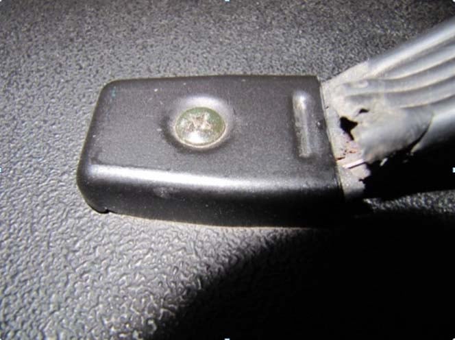

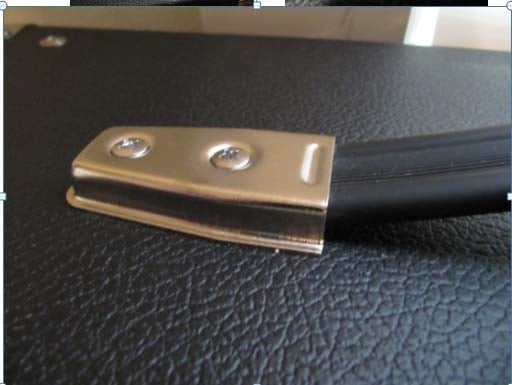

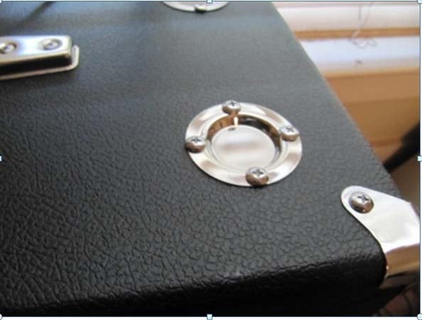

I noticed that Master used “industry standard” handles and clamps for both the speaker cabinet and head. Below are photos of what happens over time with this configuration. For the life of me, I can’t understand why this design is still used by so many manufacturers. As you will notice in the picture, the handle coating binds into the metal edge of the clamp. Eventually, it starts to tear the handle as shown below.

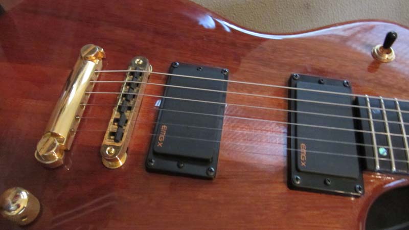

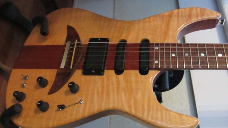

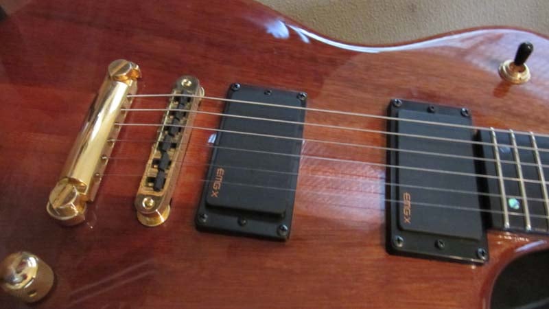

I eagerly plugged in my custom Carvin SC90 modified with EMG 89XR neck pickup, EMG 81TWX bridge pickup and Ghost Tune-O-Matic Piezo-Electric bridge. Switched to my common sweet spot, using both bridge and Neck in single coil mode, plugged into the “Hi” input and using the “Clean” channel, I hit my first open G, C and D chords with a light, steady strum. Right away, I noticed the Amp provided a liveliness and spunk to my guitar tone that I hadn’t heard in many former guitar amps. Highs were clear, the sound was snappy and I was shamefully able to hear my fingers manhandling the strings clearly and crisp. I knew I would be in trouble as this amp would require me to clean up my playing. I then decided to switch to the “Drive” channel and worked my way from little to full over drive distortion. My first impression was amazement at how natural and long sustaining the overdrive of this amp sounded. I was so moved by the tone that I felt compelled to compare it to my Visual Sound Jekyll and Hyde distortion pedal, which I’ve already put to the test verifying that it was a great sounding distortion pedal when compared to many others I’ve reviewed. I switched back to a comparable speaker volume through the clean channel and engaged the dark side of my Jekyll and Hyde. It sounded simply amazing as well, though not quite as lively. The advantage of using a distortion pedal through the clean channel was that it doesn’t overdrive the tubes thereby eliminating background noises such as hiss. In a sterile environment such as my living room or a studio, this hiss can be somewhat distracting, though as was the case with the TVA30 in overdrive, it was very minimal. My personal favorite and newfound tone was the TVA30 in overdrive. It produced a slightly more lively and natural distortion sound than my Jekyll and Hyde could emulate after playing with all the settings. A great tone for a gig.

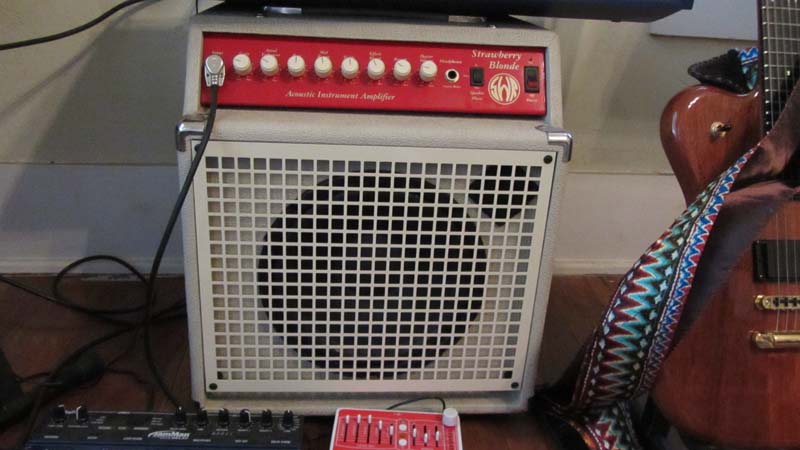

I amp1.jpgthen switched my guitar to the Ghost Piezo bridge. I have this pickup wired as a separate output on my guitar so as to allow me to run it into a separate acoustic guitar amp such as my SWR Strawberry Blonde. I also have it wired with an optional blend into the electric output so I can mix it with the EMGs and create a hollow body guitar tone. I was pleasantly surprised to hear high frequency tones of the Piezo-electric through a single 12” speaker. Though not quite as distinct as my Strawberry Blonde which also includes a tweeter, it was sufficient enough to glean the tonality of an acoustic guitar. In comparison to the Strawberry Blonde though, there was a noticeable drop in bass punch.

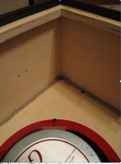

We opened the back end of the speaker cabinet to do some exploration. The cabinet was had a very impressive in build quality. The dovetail joints were barely visible and the cabinet was constructed of ¾” thick plywood. The speaker was secured with only four machine screws with flush mount metal inserts. I would have preferred more to help prevent resonant vibrations. I was also a bit unimpressed by the very thin gauge speaker wire.

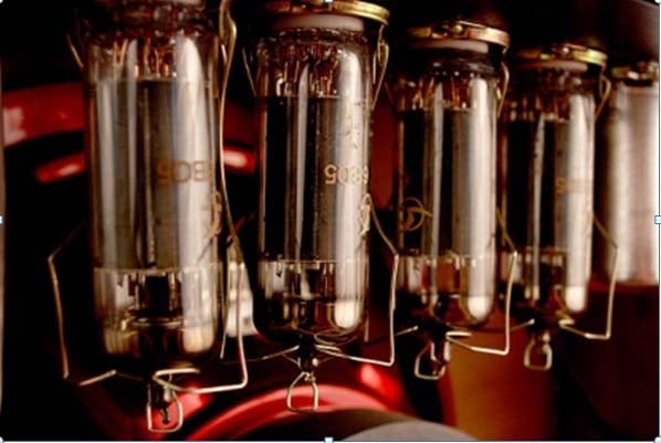

The electronics and hand wiring throughout the amp head are very high quality. This all tube, 30 watt class A power amp comes armed with four EL84/6BQ5 power tubes and three 12AX7 preamp tubes. No solid-state devices are in the signal path nor are any used for creating the rich overdrive distortion. Worth mentioning, even though it is not published by US Masters, is that the amp is self-biasing. This means that there is no need to recalibrate after changing tubes. Though, given the retail price of this amp, there’s bound to be some economic based decisions. For example, the tubes are made in China. Some would argue that the quality of their tubes is not near that of Russian; however, neither is the price. But there are a few areas that I deem unforgivable. For example, tubes are considered a maintenance item, meaning they need to be changed often (depending on usage). That said I would have expected a much more robust method of mounting the power tube connectors. As you can see in the pictures below, these connectors are mounted directly to the board with only one, very small set screw securing it. This becomes problematic when placing a new tube in the connector as the force required to secure it puts stress on the board while it flexes on the hinged design of the single set screw. This is not the same for the pre-amp tubes; however, as their connectors are more robustly secured with two screws and not mounted directly to the board.
Other items to note was that the reverb assembly was mounted with the RCA connectors facing the front of the amp. This made it impossible to remove the chassis without also removing the front cover in order to release the connectors. Prior to putting the chassis back in, I was sure to turn the reverb assembly in a more convenient orientation having the connectors pointing towards the back. Another annoyance was with regard to the “captive” nuts used to secure the chassis to the cabinet.
As you can see in the picture of the chassis, it is fabricated from sheet metal, therefore has inherent flexibility, thus making it impossible to align all the screws when placing it back into the cabinet. The poorly designed captive nuts are not forgiven with misalignments. If they are slightly misaligned with the clearance hole, it is far too easy to accidentally push them out and directly into the chassis. For obvious electrical reasons, it’s not a good idea to leave these electrically conductive nuts inside the electronics. It took me five times of mounting and removing the chassis before I was able to finally get all the screws back in without having or more pop out. This too I’d call a maintenance nightmare.

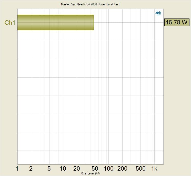

Master TVA30 Dynamic Power Output (8 ohms)
 This measurement shows a CEA 2006 Peak Power Output, which is a dynamic power rating closely resembling musical peaks. According to this measurement, the amplifier’s peak power output is 46.78 Watts when driving an 8 ohm load which is what the stock speaker for this unit was rated at.

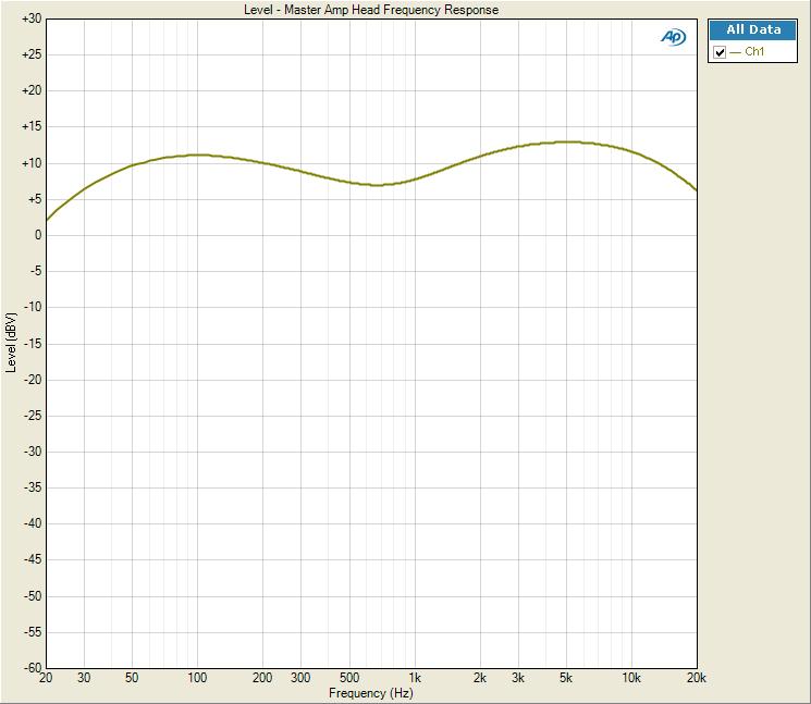

Master TVA30 Frequency Response (8 ohms)
This measure shows the frequency response of the amplifier under an 8-ohm resistive load. As you can see, it is not very linear, as expected for a tube amplifier. Some may argue that it is the non-linearity of the amplifier that defines its signature sound.

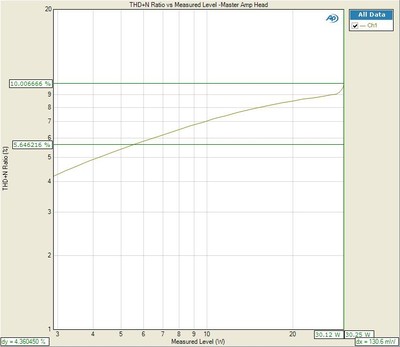

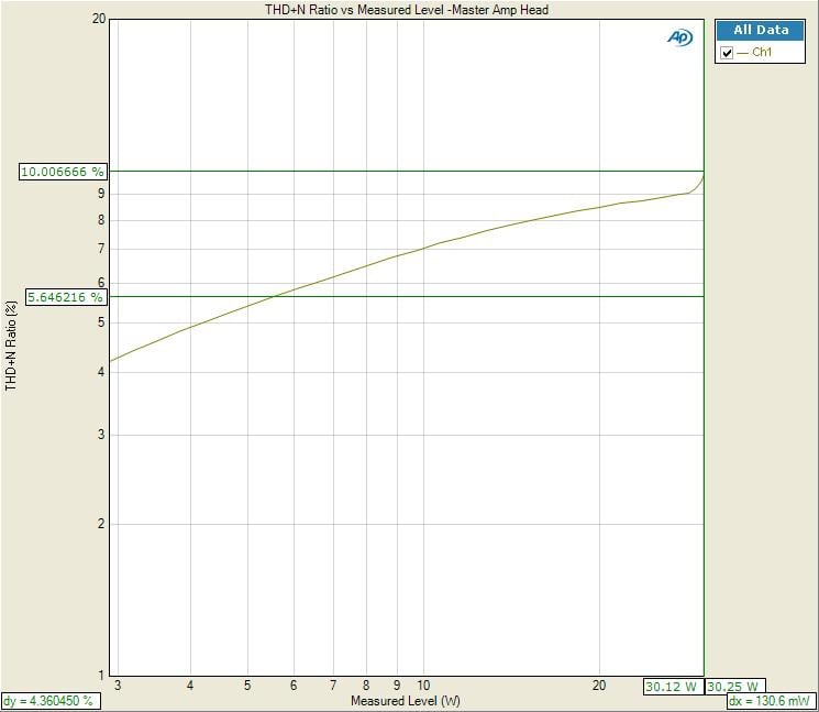

Master TVA30 Power vs Distortion (8 ohms)
This graph shows that lowest THD of the amp is 4%. It also verifies the manufacturer’s spec of 30 Watts with a THD of 10%. We suspect the high distortion is common with tube guitar amplifiers; however, future testing of other amplifiers will help us verify this as fact.

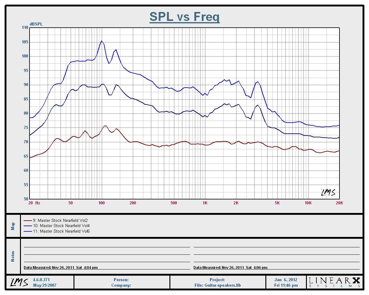

Prior to pulling the speaker for examination, we conducted a near field frequency response measurement in 1/12dB increments at three different power levels. All tone controls were set to flat.

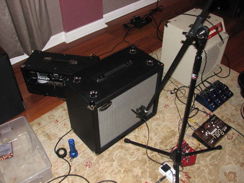

Set up of speaker cabinet frequency response testing was with near field microphone from our LMS measurement system. The home theater room had acoustic treatment. The amp head is separated to eliminate the resonance vibration discussed earlier.
Frequency Response of Master Stock Driver Loaded in the Cabinet at various power levels
setup3.jpgThere are two spikes seen on this graph, both of which are due to resonance frequencies from a vibrating cabinet at 100Hz and most likely the speaker basket between 2kHz to 3kHz. Aside from that, the speaker’s flattest response was at the lowest power setting. Once moderate volume was applied, the speaker had a large hump response that went out until about 200 Hz. This coincides with what I heard regarding the low-mids being a bit over emphasized. There’s another hump around 1.5kHz which is likely attributed to the speaker as well. Overall, the system is not linear, but considering that the amp output is not linear, it wasn’t a surprise.

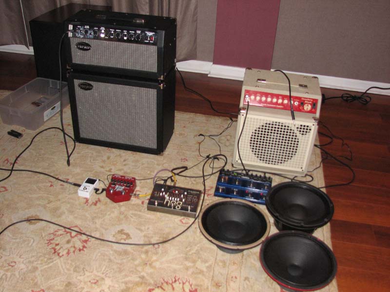

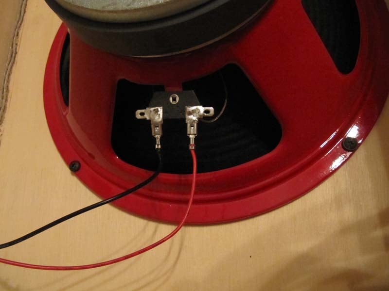

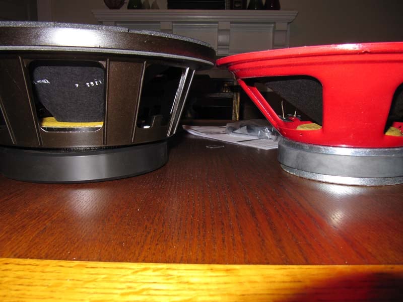

After the measurements, I removed the speaker for further examination. I believe that this was the low point design of the entire Master TVA30 Guitar Amp as this speaker was a rather run of the mill design. The basket was thin sheet metal with very little bracing. The paper material was so pliable that you can almost shape mold your finger tip around it. Other speakers used in similar speaker cabinets appear to be much more robust than that offered here as shown in the pictures below.
Eminence DeltaPro with Cast Aluminum Basket        Master, Weber Michigan and Eminence DeltaPro
There was virtually no comparison between the Master speaker to the Eminence DeltaPro-12A. The DeltaPro-12A is a mechanical giant weighing in at 18 lbs and including a cast aluminum basket and 2.5” diameter voice coil. This beast can be found through reputable on-line stores for around $120. The picture on the right shows a notable difference in the size of the voice coils between the Weber Michigan and Delta Pro when compared to the much smaller size Master. In all cases, the paper cones were considerably stiffer as was the surrounds, than that of the Master speaker. In our next review, we intend to compare through listening tests and measurements, three other speakers including the Weber Michigan, Weber California and Eminence DeltaPro. In addition, we will be doing the same with high quality Russian made Tubes.
