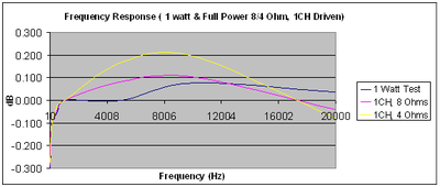

This test shows demonstrates the frequency response linearity of the power amplifier within the audible range at 1 watt and full power. As you can see, the A 51 maintains + 0.2 / -0.36 dB from 20 Hz to 20 kHz which is excellent. Notice that the linearity remains even during maximum unclipped power output into 8 ohm and 4 ohm loads indicting that this amp doesn't suffer from slew induced distortion typical of lesser designs.
Editor's Note: Parasound specs this amp at +/- 3dB from 5Hz to 100kHz at 1 watt.

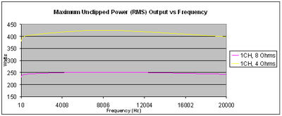

I was able to measure about 250 watts into an 8 ohm load and about 400 watts into a 4 ohm load across the entire audio bandwidth. Please note that during the 4 ohm load test, my wall voltage sagged from 116VAC to 112VAC. Without having a VARIAC to hold the line voltage constant, it is difficult to accurately measure all channels driven with such a powerful amplifier. However, given the fact that the A 52 is endowed with a 2.2 kVA transformer and 164,000uF power supply, I think it's safe to assume this amp will deliver its rated power into all channels at 8 ohms. It will deliver marginally close to its rated power into 4 ohms. In order to do a true 400 watts/ch into 4 ohms continuously, would require a power transformer about 65% larger than the one in the A 52. Of course this all assumes you hold the line voltage constant and have at least a 20A dedicated line to power it. Since a continuous all channels driven scenario is both unrealistic, impractical, and unlikely this should be of little concern to most users.
