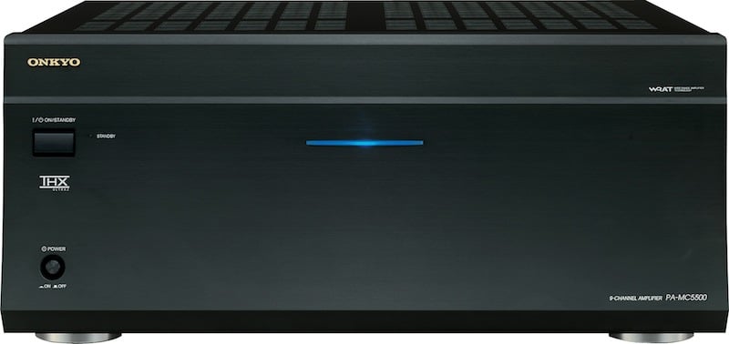

But Onkyo isn't just some garage/basement fly-by-night Internet fad organization. They have the infrastructure, the know-how, and the resources to build an amp from the ground up. They don't need to rebadge anything. When they released their PR-SC5508 THX Certified Processor, they didn't have to ask someone to build them an amp, they just designed and pumped one out on their own. And what an amp! From an aesthetic point of view alone, the PA-MC5500 is a head turner. If you are in to clean lines and a vaguely "Cylon" like look, the PA-MC5500 is going to appeal. While it has the traditional blue light (instead of the Cylon red), the single front light and slightly curved face has undeniable, "I might rise up and take over the world" feel. The front of the unit has everything you need on an amp - an on/off power button, a standby button, and a power indicator (aforementioned light). We sort of wish the light would turn red when you over-drove the amp (Editor's note: yeah, and then slowly glided left-to-right, back and forth) but there is a small light by the standby button that does that.

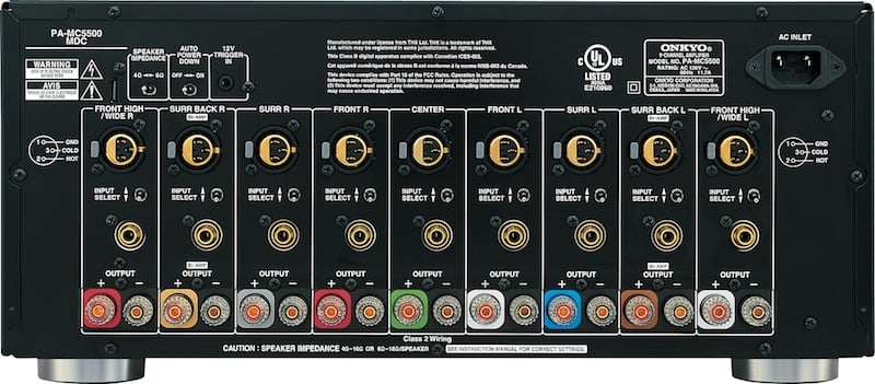

The first thing we noticed about the back of Onkyo's PA-MC5500 is that they decided to go with a two-prong power cord. While you can make any power supply and grounding system work well, this method typically yields less ground loops in our experience. The PA-MC5500 has nine channels of amplification rated at 150 watts each at 8 ohms. You'll notice in the specs above that the amp is rated at 6 ohms to 220 watts. This is because the PA-MC5500 hasn't made it to the US Onkyo site yet and we pulled the specs from the UK version. Yes, this amp has been out for a little while, but here in the states we haven't had a chance at it yet. We can take the UK specs as a guide, though, as a the reported dynamic power into 3 ohms is similar.
It seems that Onkyo has rated their amp driving a single channel into 1kHz. While this isn't exactly an invalid measure, it is one of the easier tests. The amp has a massive power supply consisting of a large toroidal power transformer and two 22,000 µF storage capacitors and utilizes Onkyo's proprietary WRAT (Wide Range Amplifier Technology) architecture. WRAT focuses on low negative feedback, low distortion, extended frequency response, and a power supply with high instantaneous-current capability. To achieve all this, the PA-MC5500 uses large, custom output transistors in push-pull configuration. It also has a three-stage inverted Darlington circuit to remove distortion.
As you can see from the back panel, the PA-MC5500 has gold-plated inputs and outputs including professional-style balanced line-level XLR inputs. There is a 3.5mm jack for 12volt control and a 6 or 4 ohm selector switch. We would have thought they'd change that to an 8 ohm/4 ohm switch for the US market (and UL) but apparently not. There is an Auto On/Off switch which allows you to let the amp power itself down if it doesn't receive a signal for a while. There are two things we like about this function on the PA-MC5500. First, the 12 volt trigger completely defeats it. Second, the power light will flash for 10 seconds before it automatically goes into standby mode. This gives you a heads up in the case of a problem. Onkyo admits in its manual that, "Depending on some sources, the auto power-down function may activate during playback." Umm... OK. At least they're upfront about it. While the size and number of channels might suggest that the PA-MC5500 is a digital amp, it isn't. It's an all-analogue solution which is confirmed by its 51 lb weight. While not heavy by some amp standards, it does suggest that the extra bracing for their "rigid, anti-resonant chassis" is in place.
