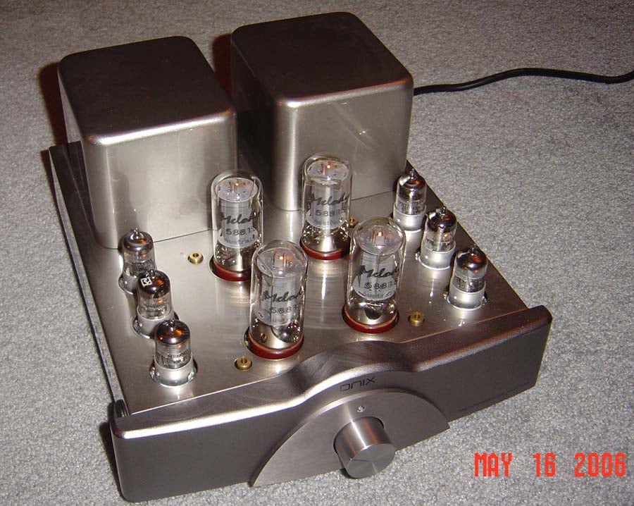

The SP3 is a ten tube stereo design that takes a minimalist approach; features are few which leads to a simplified audio path that many consider a source of improved fidelity. There are only three controls to operate and two inputs: the on/off rocker switch on the left side, an input selector rocker switch on the right side, the volume knob in the center of the faceplate, a CD input, and an auxiliary input.

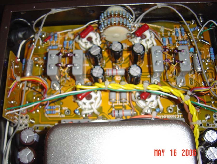

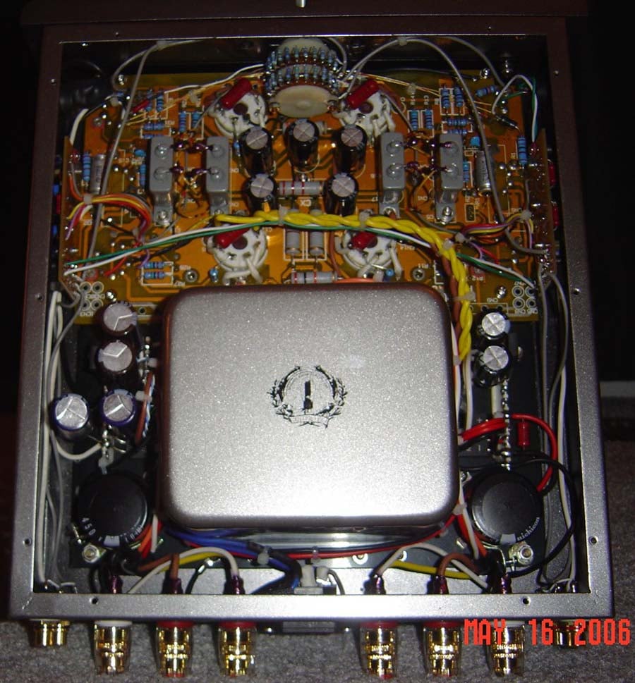

Insides Connections

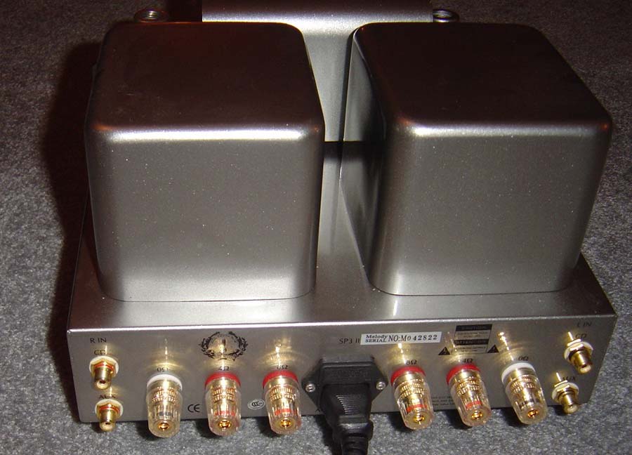

On the back there are six binding posts to hook up four speaker leads: two black and four red.  A pair of red binding posts is grouped with each of black connectors, one post labeled 8 ohms and the other 4 ohms, relating to the two options for the output transformers.  The two inputs are stacked vertically with the left and right channels at the outside of the chassis.  The SP3 also has a detachable power chord that mounts at the center of the back panel.

The tube compliment includes the four larger 5881 tubes in a push pull (AB) design and the six smaller tubes that include two each of 12AX7, 6922, and 12AU7 type tubes.  The 5881 tubes are housed under a common cage attached to the chassis using banana plugs while the smaller tubes each have their own housing on spring clips.
Adjustable bias controls are provided for the left and right channels on the respective sides behind the rocker switches.  There are two adjustment dials and three probe leads.  Biasing adjustments for tube amplifiers regulates a negative voltage across the output tubes to optimize their performance.  Typically, biasing is adjusted because sonic performance is dependant on these settings: new tubes need to be tuned because of tolerance issues even within the same specifications, as tubes age the specifications drift with deterioration requiring retuning for optimum performance, and audiophiles who really like tubes need something to play with.  Care should be taken with bias adjustments where too much current across the tubes will damage them and too little will cause audible distortion.
This unit is fairly heavy; at 56 lbs, the SP3 easily outweighs most seven channel A/V receivers on the market and some two channel audiophile amplifiers.  One issue that I would like to mention: the support feet, there are only three, two in the back and one in the front.  This is a meta-stable support condition that leaves the unit more prone to tipping while moving it.  The saving grace is that the large output transformers on the back do provide a resisting moment to counterbalance this condition to some extent.  It would be a good idea to make sure that the SP3 s properly seated and upright any time it is relocated.

One issue that may come up: with no information in the manual, those, who like me, own speakers with a 6 ohm nominal impedance are left to their own judgment as to which connection to make.  In the case of the 6 ohm speaker, it may be prudent to use the 4 ohm lead to minimize the possibility of a higher current draw than the 8 ohm lead may be designed to safely provide.
