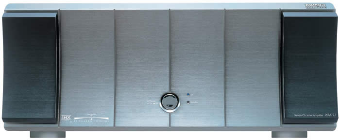

This amp is solidly constructed and has a
commanding appearance.

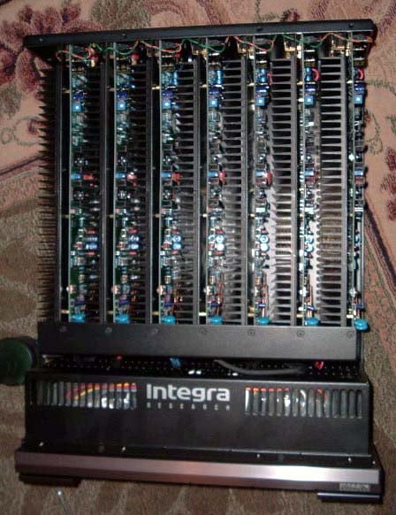

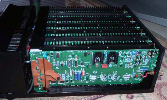

Notice the ground strapping on
each individual power amp module.
The transformers are fully isolated away from the amp
modules.
There is plenty of good old fashion heatsinking to keep each module running cool, even
during demanding power loads.

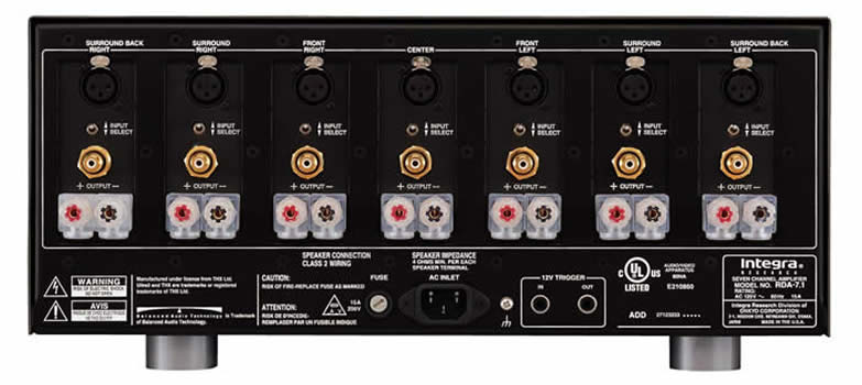

The back panel of the Integra Research RDA-7.1 is pretty standard of multi-channel amplifiers in this price class. The WBT 5-way binding posts invoke the high end appeal audiophiles love and make me happy too since I have always found them to mate better with various types of banana plugs. Should you choose to utilize bare speaker wire, the holes in each of the speaker connector shafts can be situated so that all cables will be vertically-oriented - a nice touch, resulting in a cleaner cable assembly.
The RDA-7.1 allows for both balanced XLR and unbalanced RCA input signals, so if you have a high-end processor with balanced XLR outputs you can maximize your potential. Please note the proper switch setting of each amplifier module (up for balanced, down for unbalanced). A 12V trigger connection for the amplifier is provided via single 1/8" mini plug. I would have preferred the inclusion of a Music trigger (triggers on line level input) typically found on other amplifiers for those who simply can't get a trigger line to the amplifier. The power cord is a 3-way detachable allowing audiophiles to install their aftermarket exotic cables, though I recommend putting your money to better use such as room acoustics or adding another subwoofer.

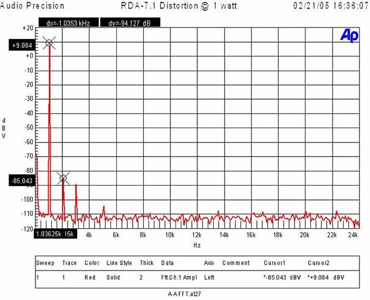

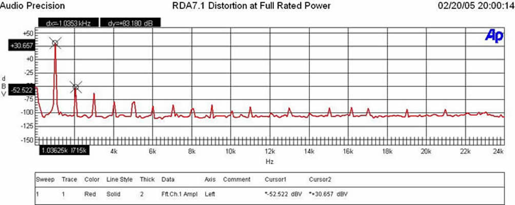

At the manufacturers rated power of 150wpc into 8 ohms, the RDA-7.1 exhibited impressively low distortion (30.657+52.55dBv)dBv = 83.2dBv or 100*log^-1(-83.2/20) = .007%
At the manufacturers rated power of 300wpc into 4 ohms, the RDA-7.1 exhibited similarly low results (30.656+49.508)dBv = 80.16dBv or 100*log^-1(-80.16/20) = .01%.

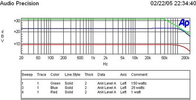

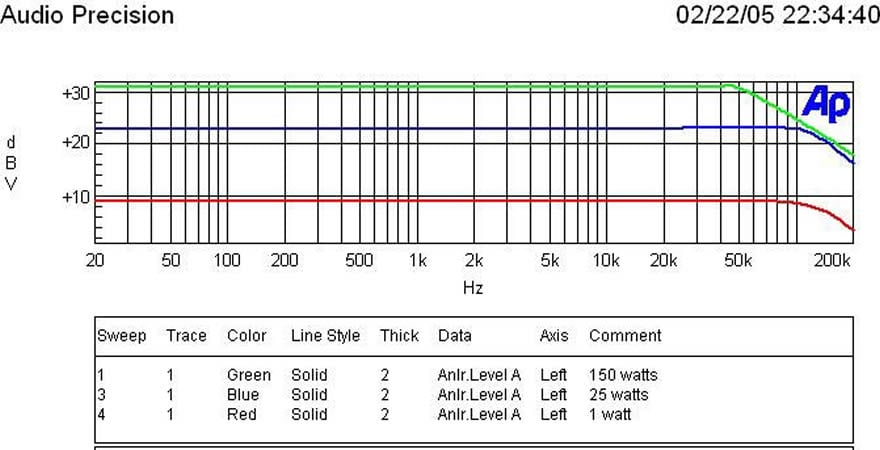

Gain Product Bandwidth (GPB) of this amplifier is excellent. Even at near full power levels, we see a -3dB point above 100kHz.

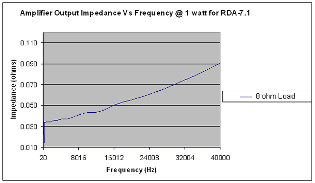

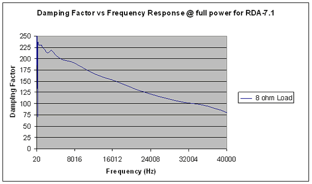

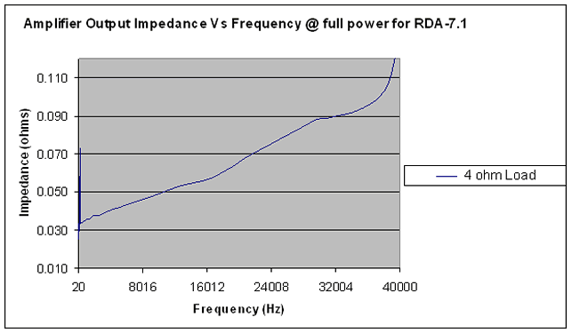

The RDA-7.1's output impedance is well under 100mohms throughout the entire audio bandwidth. This requires the right amount of negative feedback and usage of multiple power transistors to achieve this feat. The benefits of 8 BJT's per channel are clearly evident here. The reason we emphasis so much importance on minimizing amplifier output impedance is because the lower the impedance, the less chance of system frequency response variation when driving reactive loads such as speakers and/or many exotic cables.

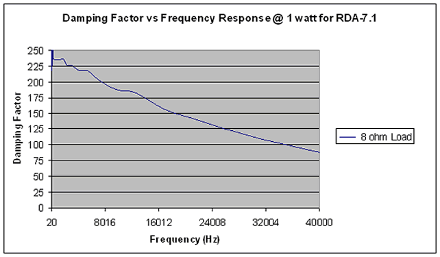

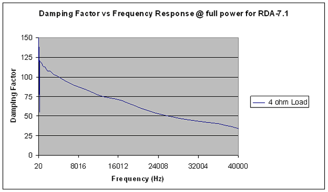

An amplifier that exhibits low output impedance will also exhibit excellent damping factor. The RDA-7.1 maintained an impressive damping factor of over 125 throughout the entire audio bandwidth. These type of measurements are uncharacteristic of tube amplifiers which is where they usually fall apart when attempting to drive low impedance, inefficient speaker loads. This design is a far departure of that design characteristic.

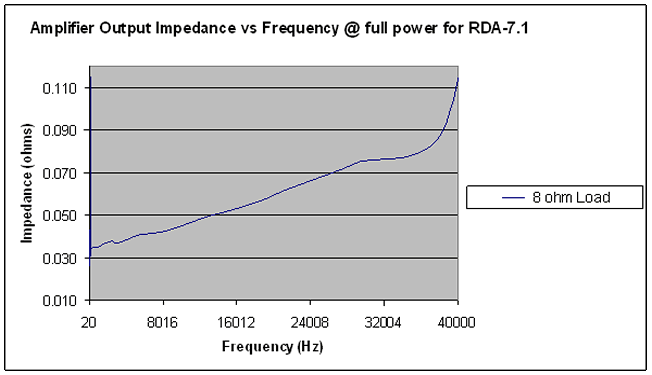

At full power we see the RDA-7.1 maintains its composure into an 8 ohm load.

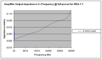

The true test is how well an amp will hold up into low impedance loads. Ideally and amplifier should act like an ideal voltage source meaning power will double as load impedance halves since output voltage will remain constant. In order to do this, the amplifier output impedance must maintain a low enough level to not be the limiting factor. It takes more than just negative feedback to keep a low output impedance, especially when driving low impedance loads at high power. You need a good stable power supply, lots out output devices and heat sink area.
As you can see, the output impedance is very similar to the 8 ohm full power test!
Based on the principle of voltage divider, we should see about 1/2 the damping factor from our 8 ohm case.
No surprises there! This amp delivered the goods.
