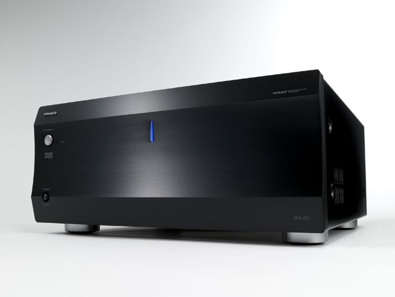

Integra has released it's first THX certified nine channel amplifier. The DTA-70.1 is designed to work in conjunction with the DHC-80.1 processor to provide not only the seven channels you'll need for a full surround experience, but two additional channels for height or width channels. For those that are saying to themselves that they have a smaller room so they don't need all those amps we once again point out future-proofing your purchases. While speakers, receivers, and transports come and go, a good amp is forever.

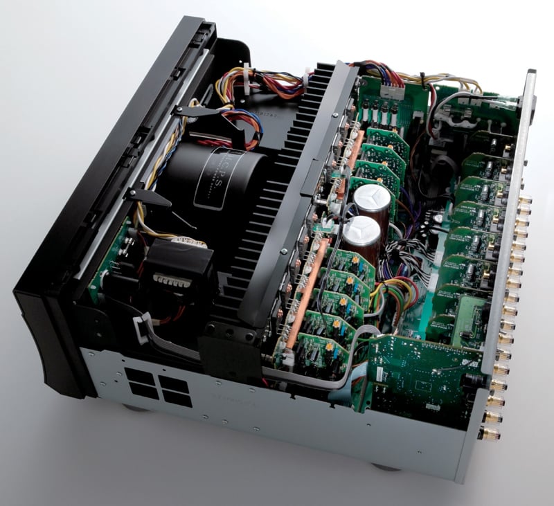

So, when you are looking for an amp from a manufacturer like Integra, what do you want to see? Since you know the price tag will be hefty, you want as many features as possible along with stunning aesthetics and bulletproof build quality. The new Integra DTA-70.1 sports an all analogue discrete-component design. It has an 11.7-Amp power supply with a massive toroidal power transformer with dual 22,000 µF capacitors. Each channel has identical symmetric circuit layouts, configured in a push-pull topology utilizing high-performance three-stage inverted Darlington circuitry and powerful custom-designed output transistors. While the specifications state the DTA-70.1 has 150 watts into 2 channels at 8 ohms, the FTC Dynamic Power specification is 180 Watts into 8 ohms, and 400 Watts into 3 ohms. The power bandwidth is 5 Hz to 100 kHz, +/-3dB, and the IHF A-weighted signal to noise ratio is an excellent 110 dB.

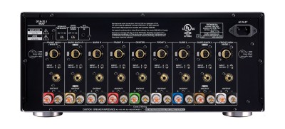

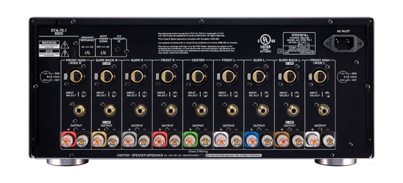

As you'd expect with a product at this price point, the DTA-70.1 sports a lot of aluminum including a solid aluminum front panel with the requisite blue LED indicator. While it doesn't have the pretty meters of something like a McIntosh, it does have an attractively concaved front and all black finish. On the back you'll find labeled inputs and color-coded outputs. You have access to both balanced and unbalanced connections and a switch for 4 or 8 ohm operation. There is twelve volt trigger input available (via 3.5mm plug) and Auto On through signal sensing. The vertical arrangement of the amps has been in use for a number of years with different products and resembles some of the blade amps we've seen in the past. This means that each channel is identical in construction and (theoretically) easier to service.
