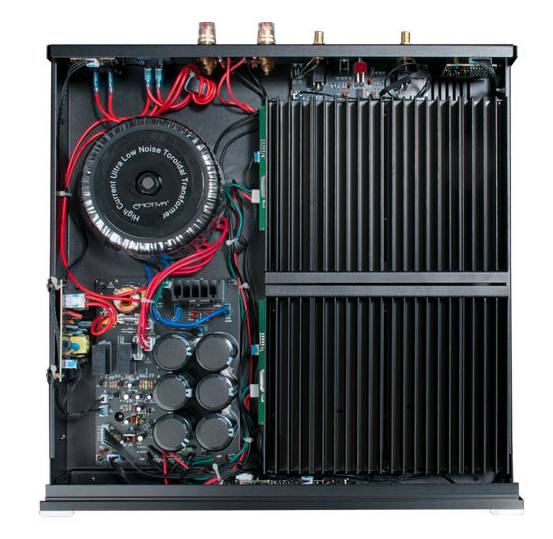

Interior Of The XPA-200
The innards of the Emotiva XPA-200, which are reminiscent of the old UPA-2.

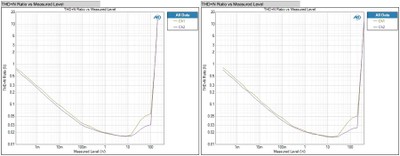

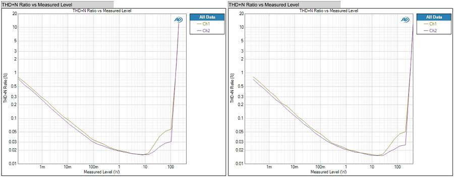

XPA-200 Output Capability
Results of a 1kHz sine sweep into 8 and 4 ohm loads for the XPA-200.
