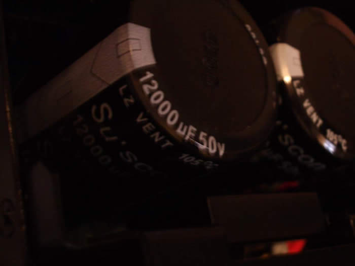

The MPS-1 has multiple high voltage (50V) capacitors in a series-parallel connection scheme, yielding 100V (2 x 20,000uF = 40,000uF per channel). In order to do 200wpc a minimum recommended cap voltage of sqrt(2)*40 + 5 = 62V should be used. Using 100V gives them plenty of design margin and added headroom since the rails can swing much higher. Individual large 350VA toroidal transformers for each amplifier module ensures that this amp can drive 4-ohm loads with no problems, while also providing excellent channel-to-channel crosstalk immunization, especially at high power levels.
While the Emotiva literature on the AV123.com website states 48,000uF of power supply
capacitance per channel (4 x 12,000uF) for a grand total of 336,000uF total power supply capacitance,
it is a bit misleading since these capacitors are actually wired in series-parallel and yield an effective power
supply capacitance of 12,000uF or ¼ stated in the literature for each channel for a total of
84,000uF.
In order to meet the height profile of the card cage, Emotiva had no choice but to use
lower voltage caps in series to achieve a higher capacitance working voltage to meet the maximum rail
voltage requirements for achieving the rated power.
Though a clever design approach, series
connecting capacitors cuts the available storage down by ¼ and also doubles the Effective Series
Resistance (ESR) as opposed to parallel connecting.
Considering this was perhaps the best way of
meeting the design profile, I would say this was a good compromise.
However, my only gripe is the
overstated literature which I am hopeful the manufacturer will change after reading this
review.

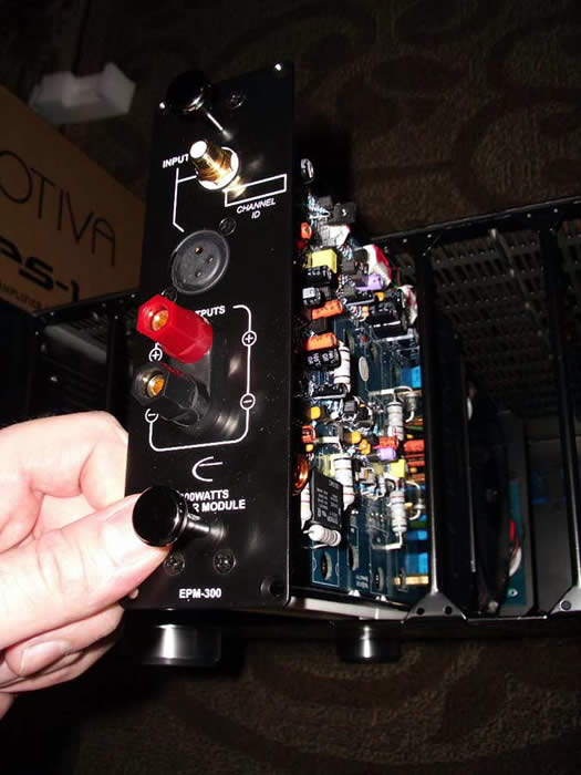

I soon found my way through all the packaging and quickly pulled one of
the amplifier modules out for a closer look.
What an impressive sight it was.
An oversized toroid power transformer, a big capacitor bank, and well
laid out circuit topology seemed apparent.
I noticed a thin plastic film over the front of the card that connects
to the chassis.
This was meant to protect the contacts from dust or debris.
Make sure you remove this thin plastic film from each amplifier module
before installing them into the card cage otherwise none of the LED
logic will work and you will be stuck with an amp with only a yellow
illumination from the Emotiva power button to give you visual
indication that the unit is working.
You don't want to make this mistake after loading up all seven modules,
cabling and placing this 115lb monster into your rack.

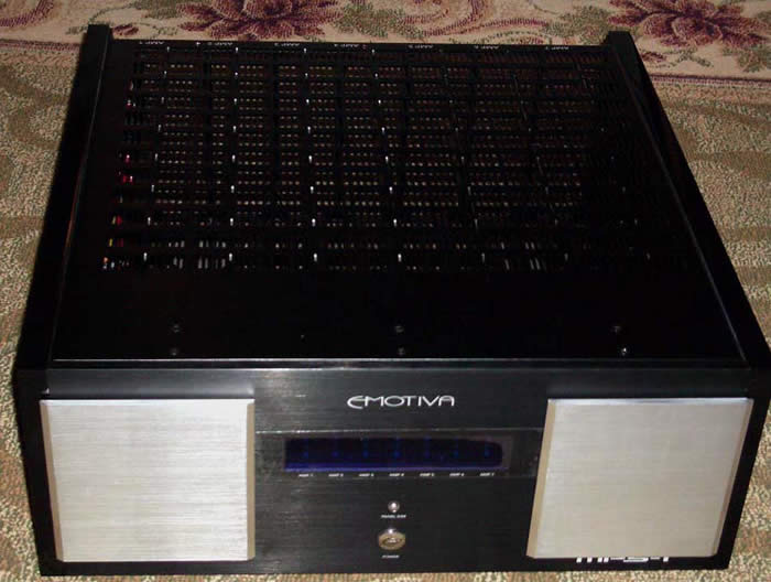

The Emotiva MPS-1 is certainly the most unusual amplifier I have
had the pleasure of reviewing.

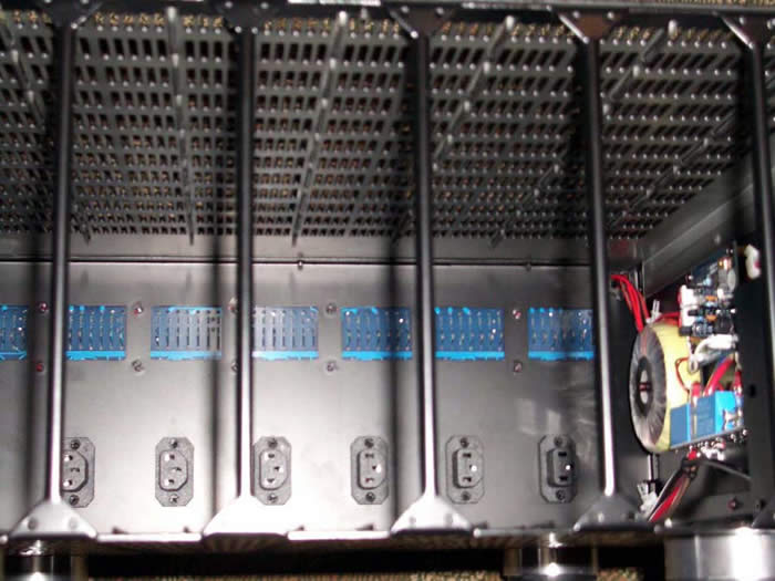

The MPS-1 card cage housing was manufactured as a sturdy metal case with a backplate
that connects power and logic to each mono block amplifier.
The power supply and circuitry to the right is for maintaining the front panel display and supporting the LED logic. Blue LEDs indicate normal operation for each amplifier module, while red indicates failure. Each amplifier module is optically isolated with 5 opto-coupled relays per module, making a grand total of 35 opto-coupled relays to ensure no ground loops or stray signal paths are present between each of the seven channels. Not since my telcom days of designing secure audio systems for NAOC and Air Force One have I seen such attention noise mitigation and ensuring the best possible channel to channel isolation.
Sliding in each amplifier module proved to be relatively easy thanks to the inclusion of slick nylon rails, but care must be observed while doing so.
Here are some guidelines to follow that I highly recommend:
- Do not apply any pressure or stack any gear on the empty card chassis housing until all of the amplifier modules are loaded.
- Guide each module into the chassis with two hands to ensure they install smoothly and uniformly.
- Push each card into the chassis until you feel it lock into the power receptacle and then install the supplied mounting screws to keep them locked down.

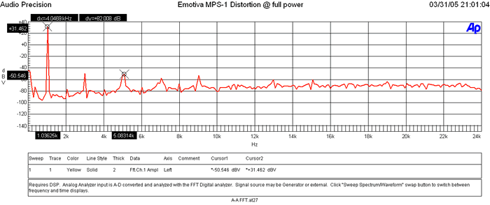

Power & Distortion Measurements

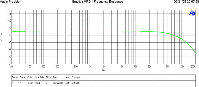

The frequency response was smooth and extended to a -3dB point of 125kHz.

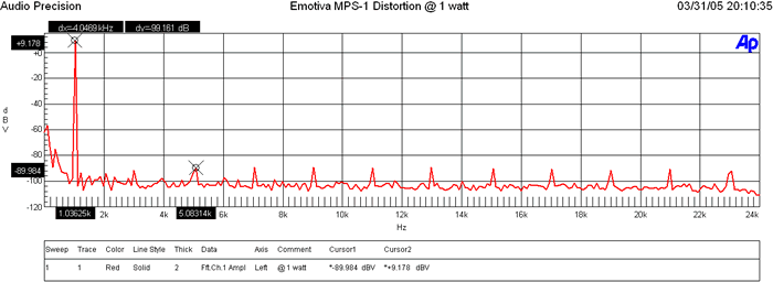

At 1 watt into 8 ohms, the MPS-1 exhibited impressively low distortion (9.178+89.984)dBv = 99.2dBv or 100*alog^-1(-99.2/20) = 0.0011%

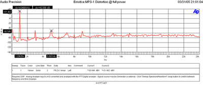

At 175wpc into an 8ohm load, we see the distortion rise, but again the amp switching effects contaminate the distortion measurement slightly. FFT analysis reveals (50.546+31.462)dBv = 82dBv or 100*alog^-1(-82/20) = 0.008% THD.

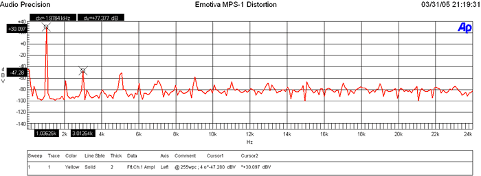

At 255wpc into a 4ohm load, we see the distortion rise, but despite the lack of the proper LPF implemented on our test setup, we still observe commendable results. FFT analysis reveals (30.097+47.28)dBv = 77.37dBv or 100*alog^-1(-54.85/20) = 0.014% THD.

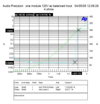

I was able to achieve a maximum unclipped power of 175wpc into 8 ohms with Vin=1.65V Vout=37.39V unbalanced and about 255wpc into a 4 ohm load with Vin = 1.42V and Vout = 32V. Once I exceeded these measurements, the clamping circuit kicked in rounding off the signal and dramatically increasing distortion. Based on this, I would rate this amp to be a 175wpc into 8 ohms and 270wpc into 4 ohm, not 200wpc / 300wpc 8/4 ohm respectively like Emotiva rated in their literature.
When I informed Emotiva on my findings, they suggested that my test conditions were preventing me from achieving their published ratings due to line voltage sag. I respectively disagree since I was only testing one channel and monitored my line voltage to be a constant 124Vrms throughout the entire test. In addition, this was the first amp I tested that did not meet its power specification. However, please note this is also the first amplifier I tested with a thoughtful limiter circuit which does make it a bit tricky to accurately test.
I asked Emotiva to furnish their power measurements for this review as displayed below.
From Emotiva Engineering Labs:
According to Emotiva, this measurement was taken at 4 ohms (1% purely resistive load) and with a line voltage of 120V ac (1KHz input frequency). In this graph you can see they achieved 300W at 1% THD. Though my contention here was they were using an automated script in Audio Precision to find maximum power of the amplifier whereas my tests were using continuous tones. What likely occurred here is their measurement captured the power of the amplifier before the clamping circuit kicked in and limited the power output. This is a common measurement some publications use which I don't really like for that very reason. I like seeing steady state full bandwidth power response to see what the amp is really doing.
Despite that I was unable to measure their claimed power, I still believe maximum power ratings should be specified as unclipped ( usually 0.1% THD or less) not 1% which can clearly be audible and seen on an oscilloscope as a clipped waveform. For more information on our abilities to discern audible distortion, we recommend reading our Human Hearing Article Series.
In any event, I never found the Emotiva MPS-1 to be lacking in power or dynamics. I suggest not getting too caught up in power games since in most cases only a fraction of the amplifier power will ever be utilized under real world listening conditions.

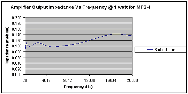

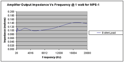

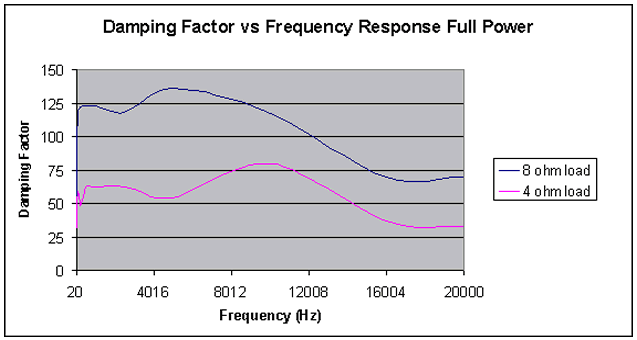

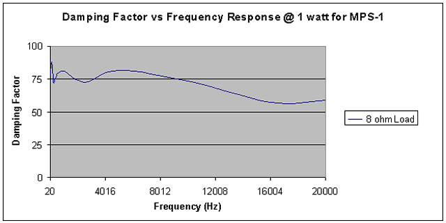

Amplifier Output Impedance & Damping Factor Measurements
Amplifier output impedance when the MPS-1 was driving an 8 ohm load at 1 watt was below 140mohm from 20Hz to 20kHz. This is a very good measurement.

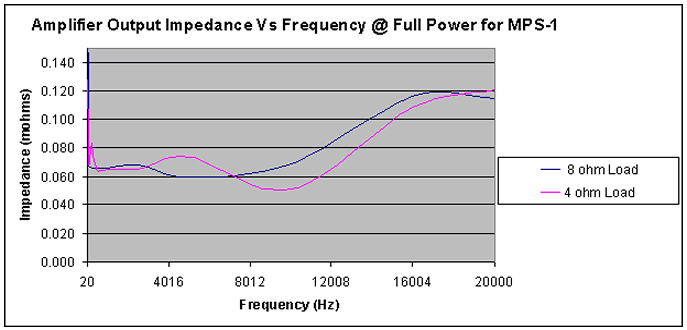

The true test is how well an amp will hold up into low impedance loads. Ideally an amplifier should act like an ideal voltage source, meaning power will double as load impedance halves since output voltage will remain constant. In order to do this, the amplifier output impedance must maintain a low enough level to not be the limiting factor.
As you can see, the output impedance is very similar (actually better) to the 8 ohm 1 watt test! Perhaps what's most impressive about the MPS-1's drive capability is its output impedance composure when driven at full power. Many lesser designed amps fall apart here, especially into 4 ohm loads. The MPS-1 sails by with vanishingly low output impedance, very similar for 4 and 8 ohm load impedances.
There is no substitute for good old fashion amplifier design with plenty of power devices to maintain a low output impedance, an ample power supply to keep the source resistance low and in the Emotiva case, a well executed switching topology to ensure high efficiency to minimize heat dissipation and maximize power transfer to the loudspeaker.

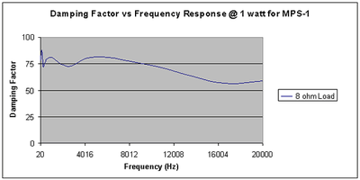

Damping factor remained stable and uniform at full unclipped power into an 8 ohm and 4 ohm load. Based on the principle of voltage divider, we see roughly ½ the damping factor for the 4 ohm load, but this was close to our minimum recommendation of 50. For more information on this topic, read our article on Damping Factor: Effects on System Response .
