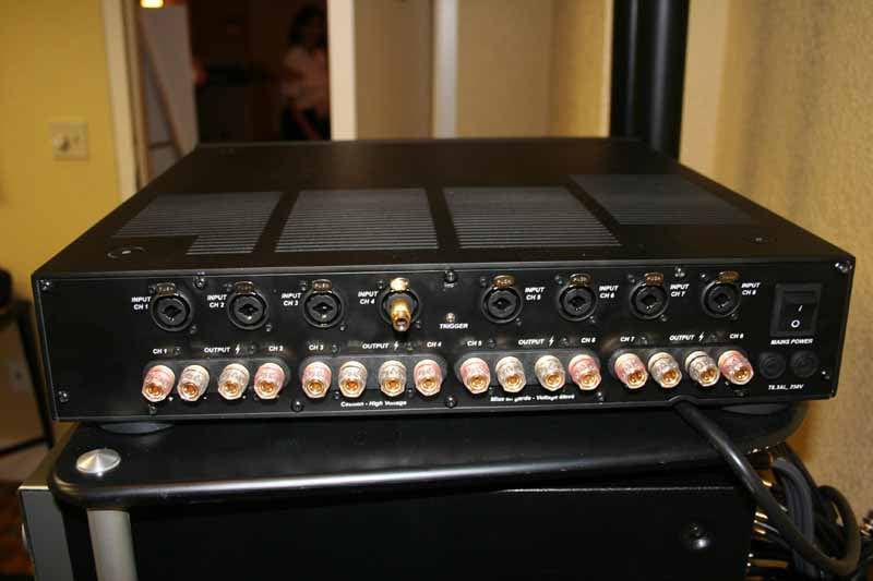

INPUTS 8 single-ended via ¼” connectors with RCA adapters / 8 balanced via XLR connectors
OUTPUTS 8 amplifier channels via five-way binding posts

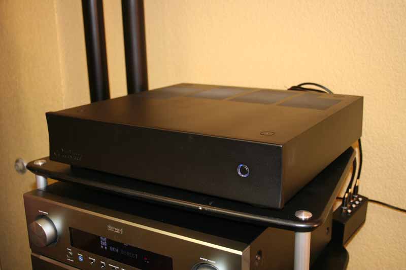

A-1400 BottomI stared at the modest sized A-1400-8 and thought to myself, this product doesn’t really scream high end.  Its not huge, the faceplate isn’t overly thick, and I don’t see any glamorous marketing applied to its literature.  On the surface, it doesn’t appear like much, but crank it up and it means business.  Their demo room was louder than I’d ever listen too under continuous listening sessions but I never heard any obvious background noise or clipping from the amplifier.  I look forward to getting a review sample into my test bench and integrated into my reference system so I can really gauge its performance.   With 2+ years in engineering development, we will soon find out of  the Heinz ketchup slogan "best things come to those who wait" will be applicable to Axiom's new super multi channel amplifier.

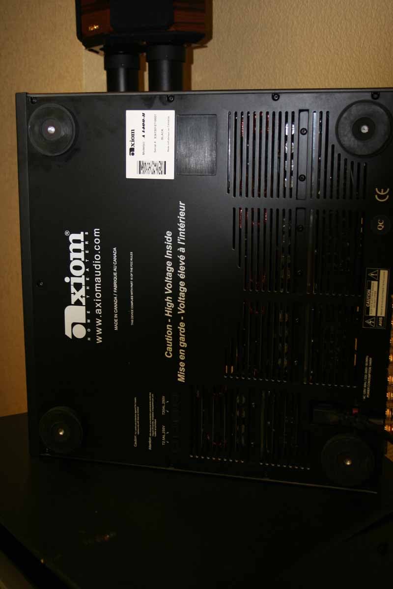

The caution high voltage inside label certainly got my attention.  With such high output rails, and high efficiency, one should definitely use caution when contemplating on opening up this product to see the guts inside.  I will certainly be treating it with kid gloves as I start cranking up my signal generators while doing full power tests.  I just hope I don't barbecue my resistor loads in the process.
