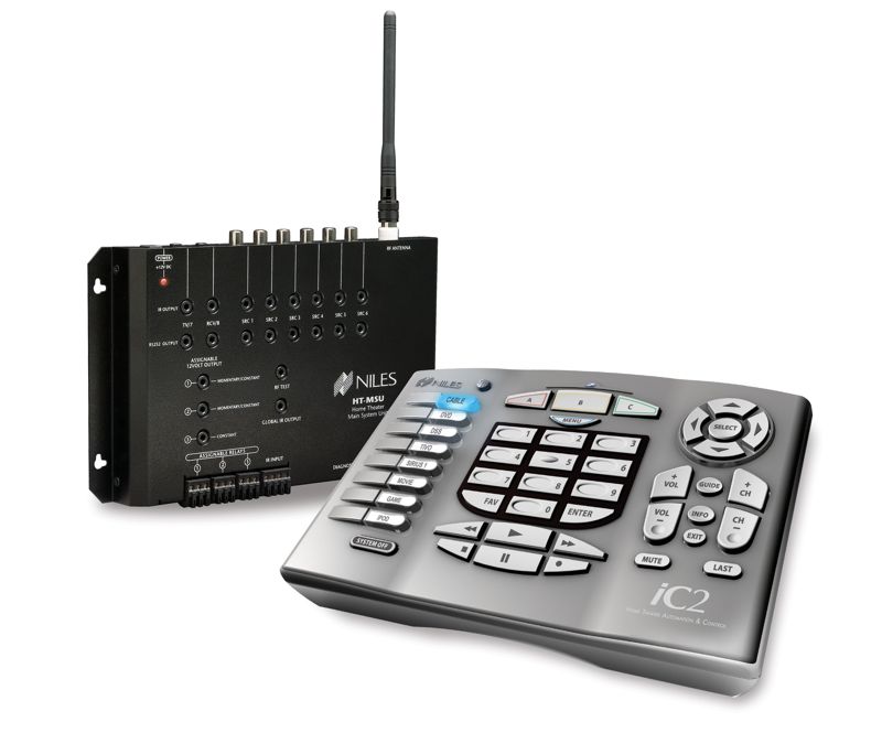

Not only did Niles put me in touch with Ken for this review, they actually sent him to my home to personally install the iC2 in my Audioholics Reference room. The system includes the tabletop remote and the Main System Unit, which we mounted on the wall behind my rack of gear. The concept of the system is simple - the remote communicates with the MSU via ZigBee RF wireless technology. IR flashers or RS-232 cables are wired from the MSU directly to each component in my rack, making for flawless communication with the gear. The MSU also uses video sync to determine the on/off state of components, so macros always work - the system always knows what is needed to accomplish any given task. With IR based remotes, macros can be interrupted if you walk in front of them or don't have them pointed at your gear while they are executing commands. And if your TV is already on, the sequence will probably turn it off. The iC2 system eliminates these problems.

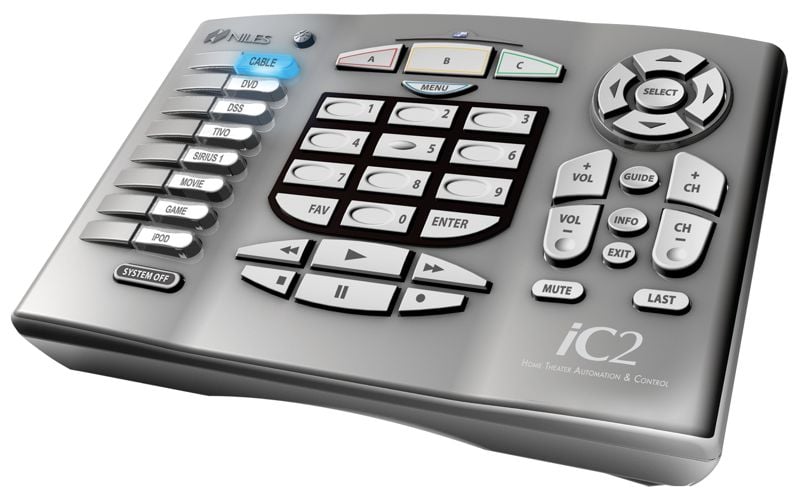

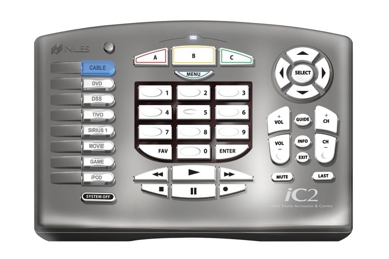

The layout of the iC2 is excellent and very intuitive. The remote consists of several clusters of function buttons. On the left, there is a column of eight Master Keys, which provide one-touch access for any home theater source (such as DVD, Satellite, Cable, Blu-ray, CD, etc.) or activity (such as GAMES, SPORTS, NEWS, LIGHTS). Underneath the Master Keys is the SYSTEM OFF button, which turns off your entire home theater system with a single touch. The center of the remote includes specialized navigation keys including "A", "B", "C", & "Menu" buttons, which double as red, yellow, green and blue buttons. These allow control of menus found in today's popular DVR, cable and digital media sources (not to mention Blu-ray and PS3 controls). Below this array are the number keys for access to channels and Master Key Favorites, as well as FAV and ENTER. Underneath the keypad are the traditional transport keys for controlling PLAY, STOP, PAUSE, FAST-FORWARD and REWIND functions of DVDs. CDs, DVRs and other sources. The right-hand side of the iC2 has menu navigation keys (up, down, left, right and SELECT) for control of source guides and on-screen displays. The volume and channel controls are ergonomically designed and positioned for frequent use. Rounding out the buttons are GUIDE, INFO, EXIT, MUTE, LAST and a button for the backlight (all buttons are backlit by a soft blue glow). The buttons have a very pleasing "click" and are large enough to be easy to use without looking. The backlighting is controlled by a proximity sensor, so it automatically illuminates when you reach for it. If you prefer, you can turn this feature off and have it light only when you press the backlight button. There is a tiny blue battery charge indicator on the top center of the iC2 that lights up when the battery is charging, and turns off when done.
The eight master keys are blank, and Niles ships a large sheet full of labels for input sources, channels, and custom functions. The clear master key buttons can be popped off so the installer can put the label inside of the clear button. All other buttons are permanently labeled. The obvious question is: "How do you deal with wanting to have more than nine customizable functions?" Let's say you want to have nine preset "favorite" channels. Maybe you are a sports nut, and you want to have all of your sports channels on buttons. Think of your car stereo. You probably have six or more presets. Within a few days of setting up those presets in your car, you know what station each (preset) number represents. With the iC2, you can have a "DirecTV" master key, and after pressing it you press FAV then "1" for ESPN or FAV then "2" for NFL, etc. Some will view this as a shortcoming of the iC2, but many will appreciate the tradeoff. On touchscreen remotes, you will typically have to drill through two or more pages to get similar functions. After a week of using the iC2, I found it very natural to get to some of my less-used functions, such as presets or changing channel guides.

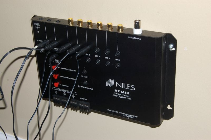

The Main System Unit is a slim, wall hugging box that is completely redesigned. It includes eight routed IR ports and 1 routable global IR output port, allowing for IR routing capabilities, which is necessary for applications with multiple satellite or cable boxes, for example. There are eight combined video/voltage sensors for power status sync, and eight RS-232 output ports.
Ken described the MSU as a piece of gear that "lives and breathes based on status." Power-on deadtime is assignable, allowing for rock solid macros. Delays in the system are temporary based on status, so an initial "on" sequence might take a little time, but other moves don't have to. There are three assignable 12v trigger outputs that are completely programmable, as are the assignable relays.

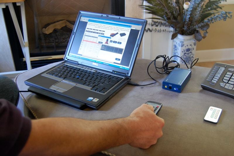

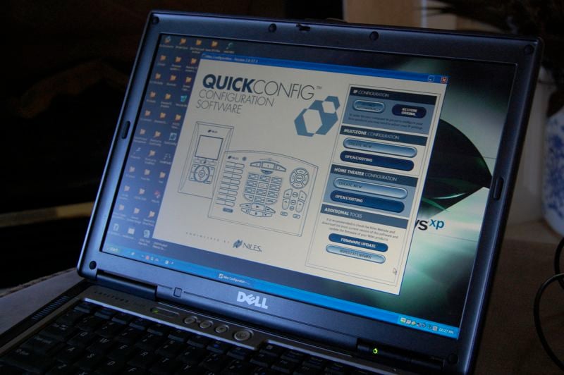

The iC2 is designed to be installed by dealers. In order to program and upload to the MSU, an IR-CS (IR Capture Station) is required. The programming interface is wizard-based, and is much simpler than the original software. It is an interview-style system that asks questions about what you want to accomplish. This cuts down on install time, saving the consumer money and the installer time. The programming software is dumbed down for the rookie installer, but is capable of taking the veteran as deep as he needs to go. Niles has an amazing library of remote codes, but the IR-CS allows for learning of any codes not in the library. As will be the case with most installers, Ken arrived with some of the programming already done, based on our earlier conversations and a list of my components that I had emailed him. We only had a couple of codes that we needed to "teach" the system once he arrived.
We started by mounting the MSU on the wall, and then Ken began the tedious task of running IR flashers, RS-232 cables, and video sync cables to the components in my rack. We were able to use RS-232 on my Emotiva Pre/Pro, and used IR for the other components. This was probably the most time consuming part of the installation. While Ken routed the cables, I labeled the Master Keys. For my setup, I chose to label my buttons with the following: DirecTV, List (for the now playing list of the DirecTV DVR), Cable, Now Playing (for the cable DVR), DVD, HD DVD, CD, and NFL SUNDAY TICKET.
